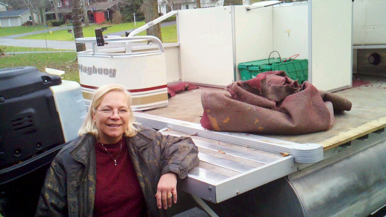

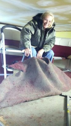

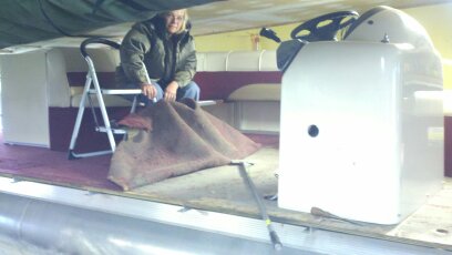

Next was carpet removal. Avalon did a great job attaching the carpet to the marine plywood base. I tried just pulling it, trying to peel it back, but after a few exhausting minutes, only a couple of feet of carpet was up. So we went to our local Taylor Rental and got their advice. They suggested a tool shown in the photo which is a heavy handle with a sharp stainless blade. It reminded me of my Grandfather's ice spud. In less than 3 hours, with some help from the Project Manager, we had all the carpet peeled off. We were amazed at how much dirt was residual in the carpet. Last winter we pressure washed the carpet numerous times. So much dirt had accumulated that mold was growing on it. Throughout the year we vacuumed, never able to remove yellow Lab hair. Carpet and boats are not a good combination in our book!
We wanted to keep the carpeting that was under the seating so the items stored there would not rattle around. I cut the carpet on a line just under the edge so no carpet would be exposed when the seating was put back.

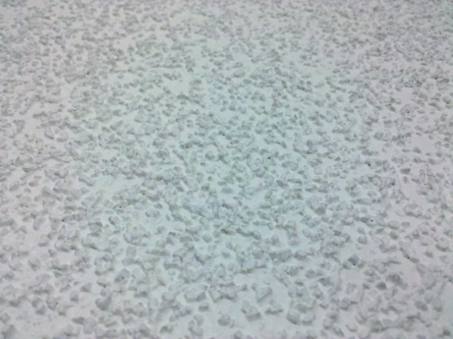

I followed the recommended application of KiwiGrip using the special roller that came with each gallon. I put 2 of the rollers together on a 7" paint roller handle, worked great. After I got the roller fully saturated with the mayonnaise consistency material, I no longer used a notched trowel to spread it. I simply dipped a stir stick in the can and deposited it on the deck. With a firm force on the roller, the thickness was fairly uniform. I tried to completely cover the plywood with no voids. Not that important as the second diluted coat filled provided complete coverage.
The Project Manager has "Princess and the Pea" feet so I was under strict rule to not end up with too prickly of a finish. And since we had no plans to heel over the pontoon like you see in the sailboat races, we would not need an aggressive finish. I may regret this for when we boat in the Alexandria Bay area on a busy day. With the steep rock walls in the narrows, the rollers from boats near a level 5 rapids. We’ll just go slow there.
The texture when dry was actually too aggressive, so I experimented with a second coat of KiwiGrip diluted. 50/50 with water.
I applied the diluted material as a second coat and it resulted in a smoother finish. I used a 4" paint roller to apply the material this time. I had to go back with dabs of undiluted KiwiGrip to fill in some voids and low spots in the plywood. This stuff appears to adhere VERY well. They say you can recoat in the future. We selected the cream color and it looks great.
