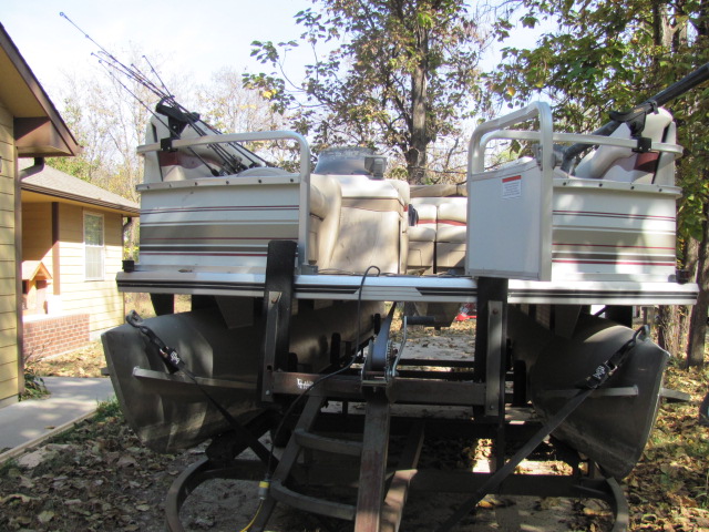

About the third time i've tried this post. Keep gettin kicked off. Damn dial up anyway. Hello everyone. Name's Joel from central Ks. We bought her a couple of months ago. As you can (hopefully you can see she needs ALOT of work. But thats ok because so do I). She's been sitting for awhile so i went through the carb. and seem to have her running pretty well. But i seem to have a vibration problem. Shaft is straight. RPM's look good. any suggestions?
