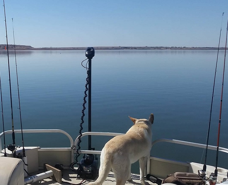

I searched through old posts on here and found a pic/link to the mount we used:
JBO wrote:I would probably suggest looking at (2) high amp hour 27 series batteries at a minimum. We have (2) 27series AGM Cabelas batteries and they work well but I wish I had purchased 31 series off the bat. I definitely need to recharge the batteries after a day of use and I'm typically lower on juice than I'd prefer. Not much extra left in the tank.
Edited: Don't mount it on the transom. You should try to get it mounted on the front. It should be do-able.
Example:
We used a Minnkota MKA-21 Mount which helped elevate the trolling motor a bit to clear the front trim of the boat and makes it easier to remove. We normally remove the trolling motor for loading/unloading and getting it on and off the trailer.

I ended up with a Minn Kota Terrova 80/US2 80-lb Thrust Freshwater Bow Mount Trolling Motor with i-Pilot, 60" Shaft. (Setup forward)
Setup with quick release also, and remove in the winter. Because I have side gates I just lift it up high, and lock if passengers are not fishing.
Love the I-Pilot and the 80-lb thrust moves me along fine and supplements the motor at idle when needed to hold a constant trolling speed.
