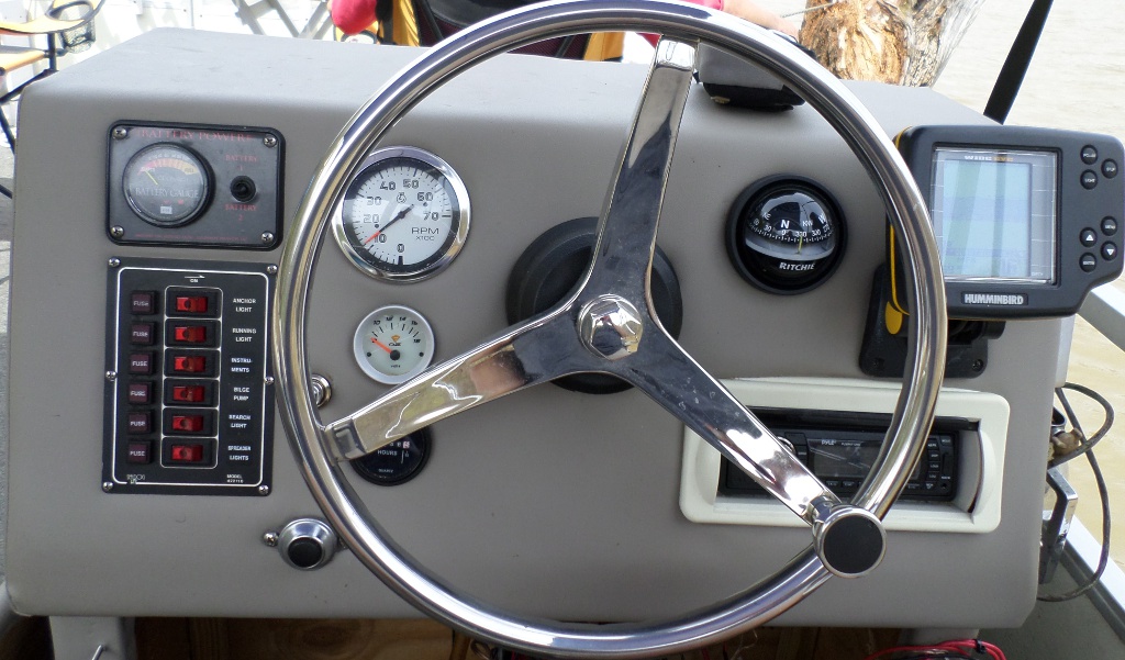

I recently relaced all of my furniture in a new-to-me Playcraft pontoon. The seats where no problem, but the console scares me!. The console is a blank canvas with no holes precut. I currently on have the steering, switch panel, stereo, water pressure gauge, and a tach in my console and planning on moving the old stuff to the new one. The new console is a Toonmate Deluxe Captains Stand, nothing fancy but looks a lot better than the old one. I would love any advice or pictures if anyone has used the same type of console.
Thanks

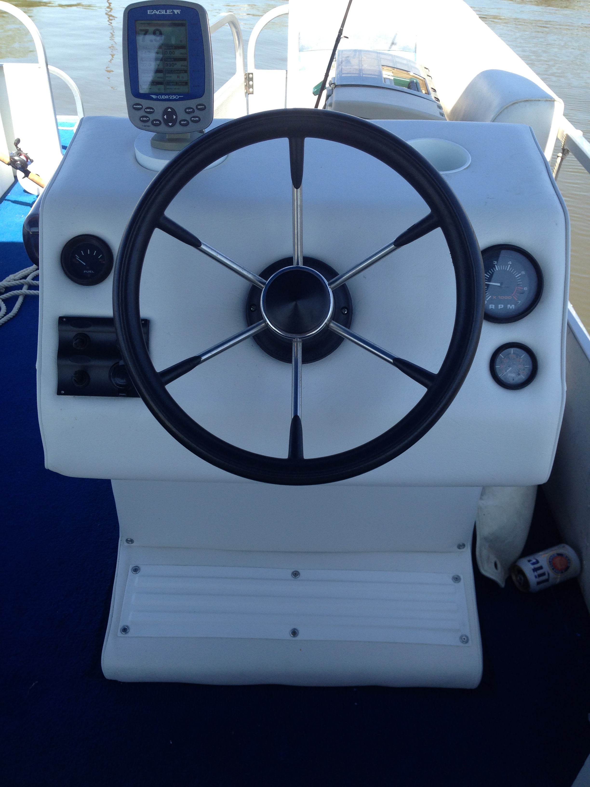

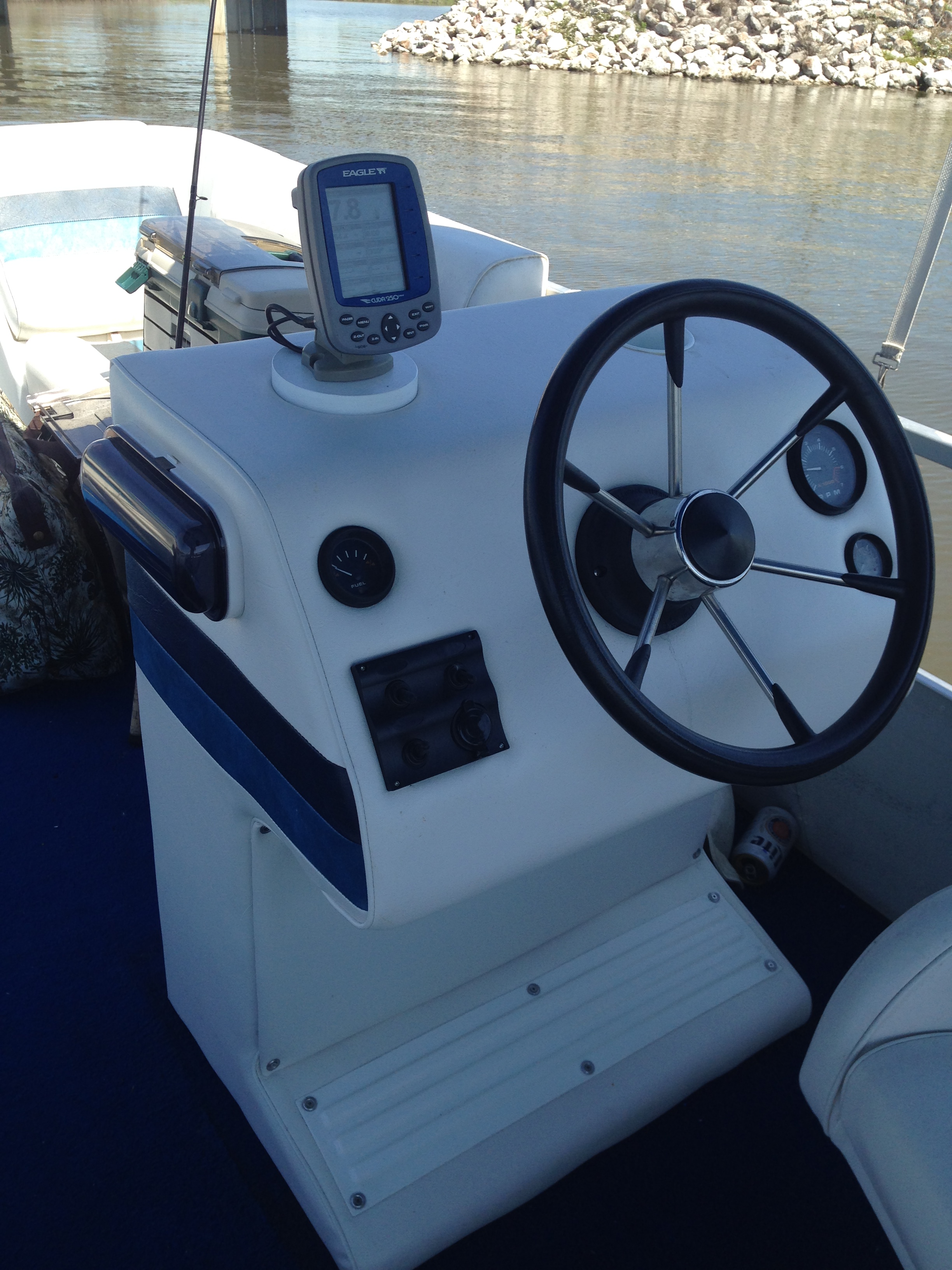

Finally got the new console finished up. My steering cable broke right before winter came so I figured it was time to jump into the console as well! It turned out pretty good with some help from my Dad, also cleaned up the electrical wiring that was under the old console, there was a lot of spare wire under there that didn't go to anything! I ended up mounting the stereo to high so I couldn't use the cup holder that went above it. I rigged up a mount for my depth finder and stuck it up there to cover the hole.
- IMG_3387.JPG (1.54 MiB) Viewed 6148 times
- IMG_3386.JPG (1.8 MiB) Viewed 6146 times

Great job! smart using the side for the stereo!
Re: Toonmate Console
evidence points to some alcohol consumption while this was being completed,,, musta helped,,cuz it turned out GREAT !!!
BTW how do you cut the the vinyl 1/4 inch smaller than the rest of the hole???

Alcohol was not consumed until it was done, haha! We ended up cutting the holes from the inside and then cut the vinyl after the plastic was cut. It was definitely a learning experience! Putting the radio on the side was the bet option after I figured out where everything else was going. It made it a lot easier to get to!
never would have thought of that !!! Thank for sharing
