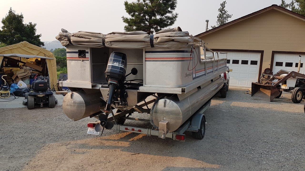

Thinking of changing my prop for better performance for a pontoon boat. i have an older 1996 40hp merc. any suggestions?
pontoon boat 057.jpg (217.7 KiB) Viewed 7941 times

What is your current speed and RPM and what dimensions is the existing prop? But to be truthful there is not gonna be much performance improvement from a 40 hp motor on a big pontoon...

checked my speed and rpm today. between 12-14 mph @ 5000 to 5200 rpm. my prop is 12" dia x 10 1/2 pitch.
