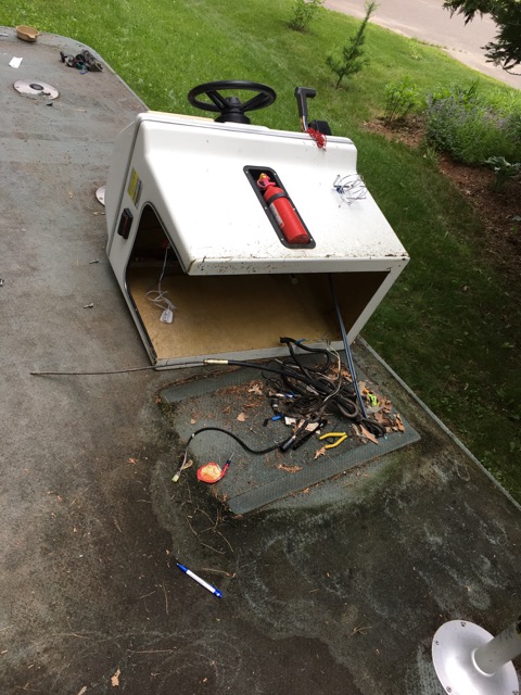

Just finished my vinyl re deck in putting back together - Are there any pass through grommets etc for hole to console?
Also - right in front of rear seat (full width) i would get water pooling - it sits rear low in water - anyone put in a drain? thinking possible a small stainless shower drain?
Also - putting in new console - old had a retractable antenna (to accommodate slip cover) - any options for antenna??
thanks BTW - this is the BEFORE shot !!

If this is hidden in console to get under the deck and only to protect against chaffing, how about a plastic toilet flange from home store?
Or you need smaller?
https://goo.gl/images/XgDz1a

I'd look at PVC stuff at the hardware store.
