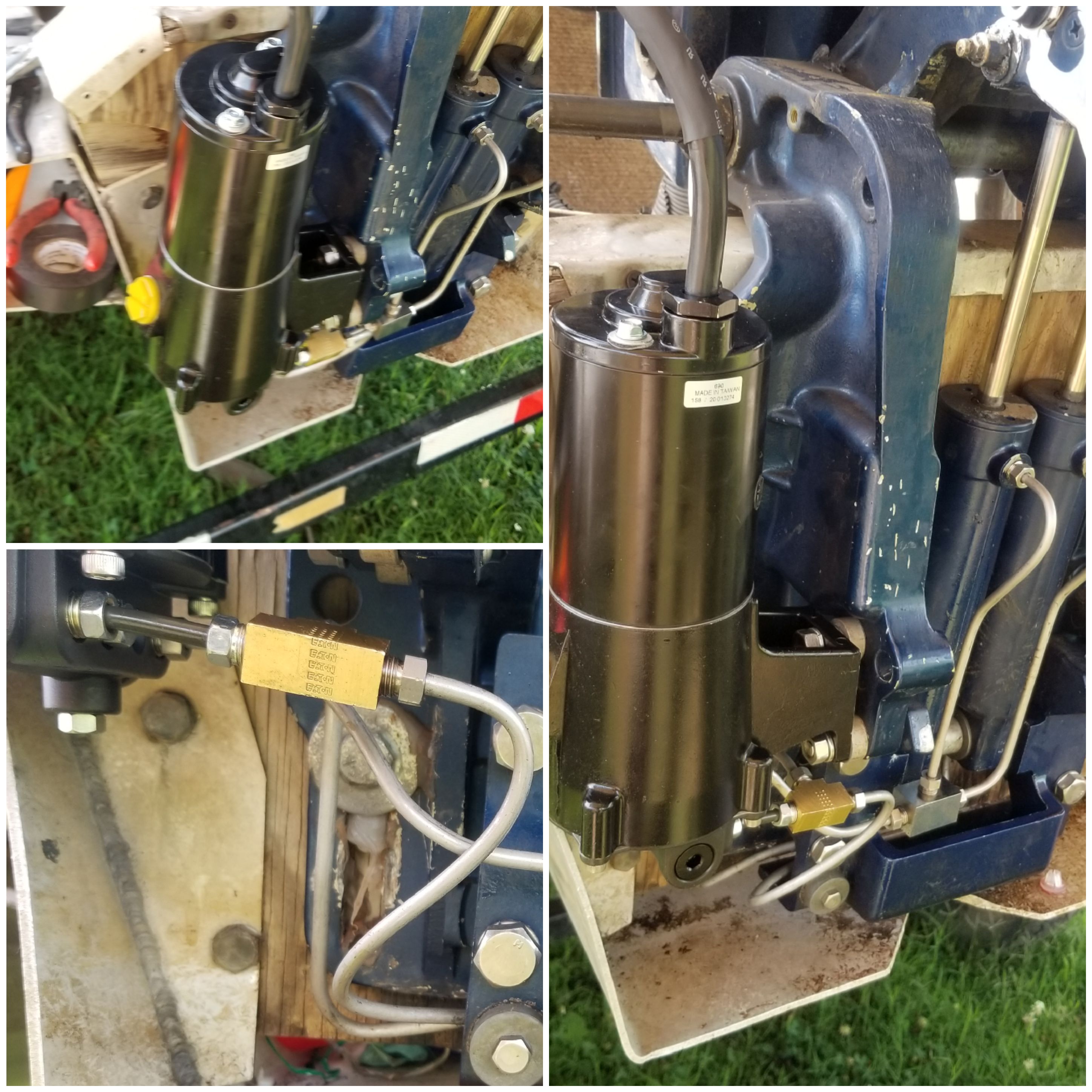

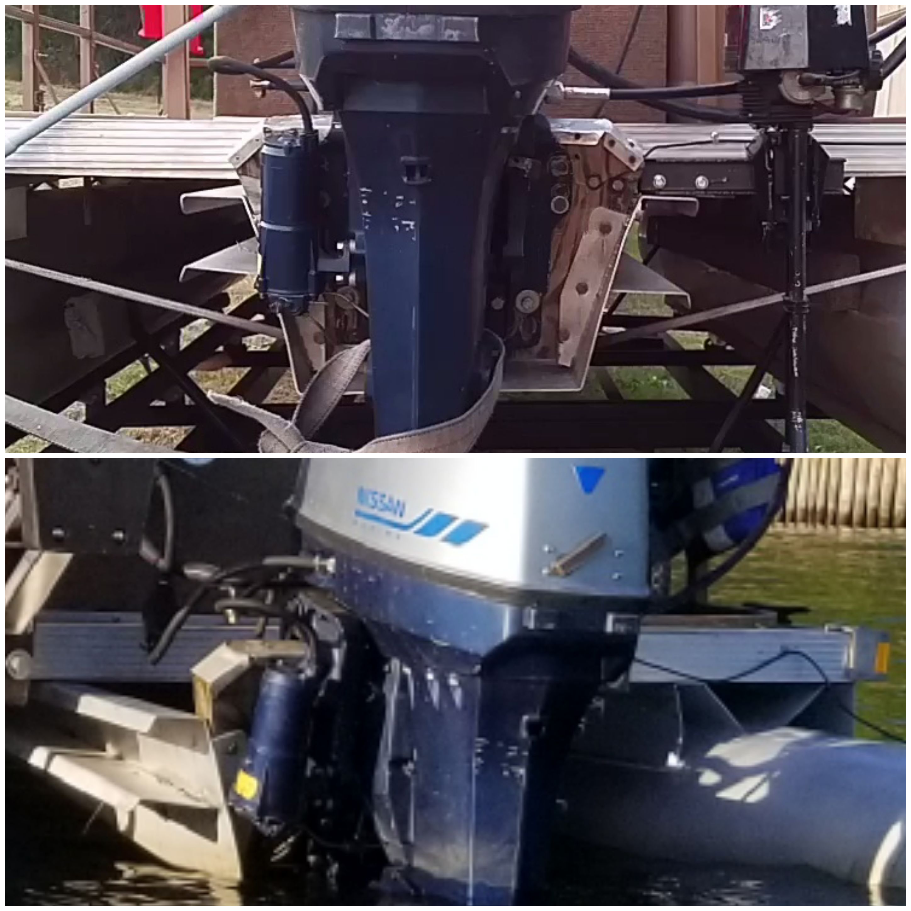

Problem solved. New pump with one year warranty from Amazon for $139. It's a DBElectrical brand Volvo-Penta rebuild. Looks like Tohatsu used a similar vendor back in the day or outright copied that design. Only had to bend the current cylinder input lines into a Brake Tee fitting and fashion 3/16 brake line to connect so that I could match the Volvo-Penta model's single output whereas the Tohatsu pump had two outputs. Both pumps have single returns. Even the pump's tri-hole mount mated to the engine transom mount bolts.
Lesson: tilt-trim pumps are not that peculiar, just pushing fluid. Strange how some setups cost thousands of dollars.
