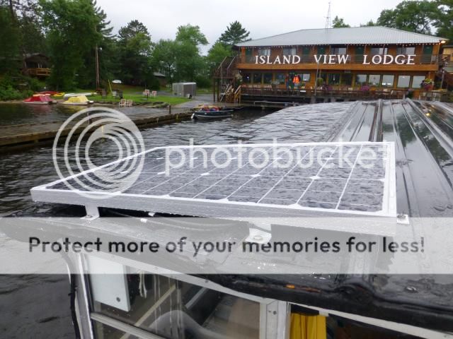

Solar is up and running. Sixty watts. Now if the sun would shine....

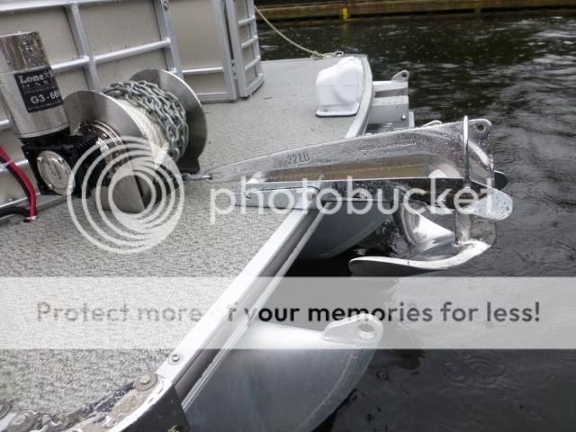

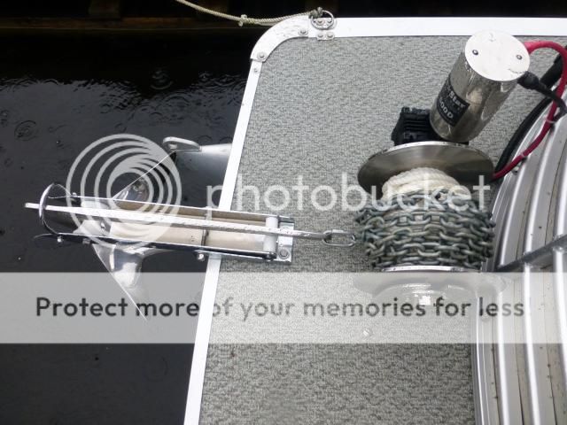

And the power anchor from h*ll! The winch is Australian. Couldn't find a decent one stateside.
22 lb stainless claw anchor. 110' of 1/2 line and 15' of 3/8 chain.
