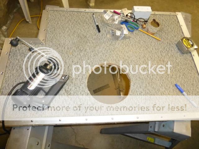

Dangit. It happened again. Those pesky holes, you try scrubbing them out, you try soaking them out.
Why oh why can't I stop drilling large holes in my boats? I must admit that the RotoZip hole attachment does very neat work.

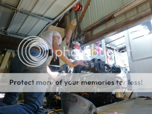

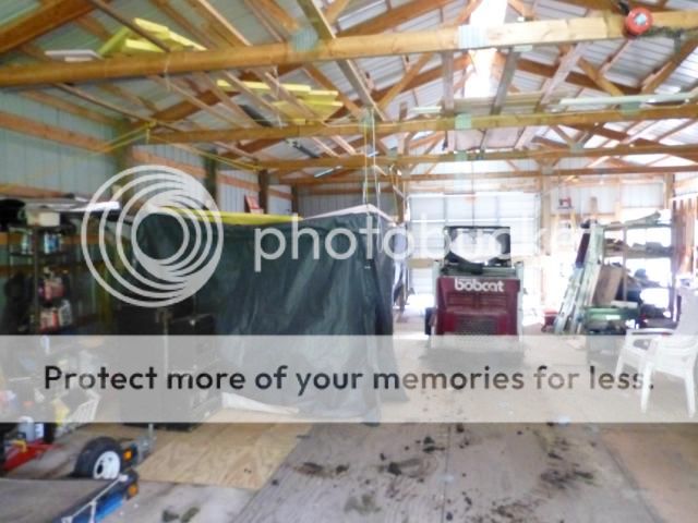

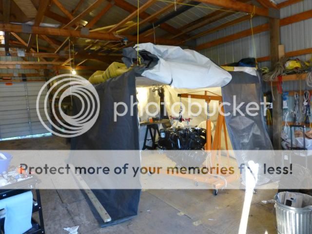

More things I built enroute to this winter's mods:
Every winter, I end up building some sort of tent over one thing or another in order to provide minimum heat while I work on a sled, boat or whatever. I have a heatable garage, but some of these projects take up a lot of room and may take weeks or months, so I usually hang a large blue tarp from the ceiling of my pole shed and put a propane heater in it. It takes a fair bit of doing and is a pain in the ass.
Well, this year I got sick of building EVERY year and made myself a pretty cool temporary, yet reuseable room.
The old cover that tore off of my round top shelter for Al the Mirthmaker provided just enough raw material, besides being pretty stought.
Getting fancy, I built an 8'x10' frame out of pvc, hung some lights on it and proceeded to cover it with the plastic. Each corner is Velcroed together so that I can flip any or all of the walls up onto the roof structure as needed. I also hung each corner of the structure from a semi-elaborate setup of pulleys. All ropes end up coming together to one final pulley and rope.
The final effect of this over the top build is that I can flip all four walls up and then pull the WHOLE structure up to the roof of the pole shed so that it basically disappears in the summer when I don't need it.
I had some leftover insulation that went on the roof. A bit of heat and some MP3's and my mini man cave was ready. My buddy called me 'Inspector Gadget' when he saw it
Note the pile of band gear in the first photo. One pile of MANY
Right now it is making for a pretty cozy 'motor room'. Even at 20 below. Which it is about to be in a day or so.
