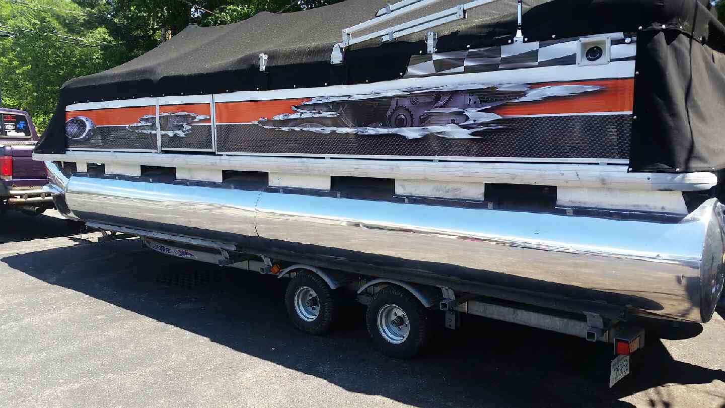

That pic is from while I was actually in the process of polishing. A ton of work but look awesome when done. I used the Airway buffing pads and some Rouge.

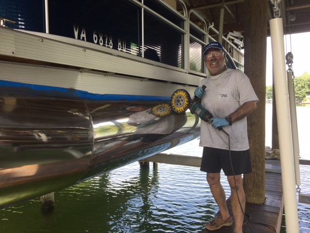

After spending considerable time on my buddies boat, I told him I thought we should get Airway buffing pads and Tripoli and white rouge bars.
I was at a huge Street Rod Nationals car show last weekend and one of the big buffing supply companies was there. I bought their yellow and white 8" pads with adaptor for the Makita polisher as well as a white cone for the hard to get areas. Also a 3 pound brick of the Tripoli (brown) and White finishing bars.
Yesterday, we hit it again on his Tri Toon going over top of what we had done before with the Porter Cable dual action using White Diamond.
The AIRWAY buffing pads with rouge make an INSTANT result........ WOW !!!!!! Just like what you see on the youtube videos from the truck guys. These pics are only after using the brown Tripoli rouge and the yellow pad. Today, we'll go back and hit it with the White pad and white bar of rouge to finish it.
Incredibly filthy work. Forgot to wear a mask, although I did wear eye protection. Payback is hell....... my buddy will get the pleasure of helping me on our boat next spring.....

Nice work exactly how i did mine. 400 paper then 800 paper then Yellow Airway wheel with brown bar then White wheel with white bar. Dirty nasty job but amazing results
