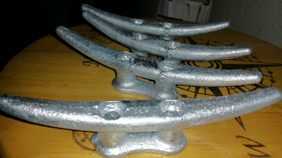

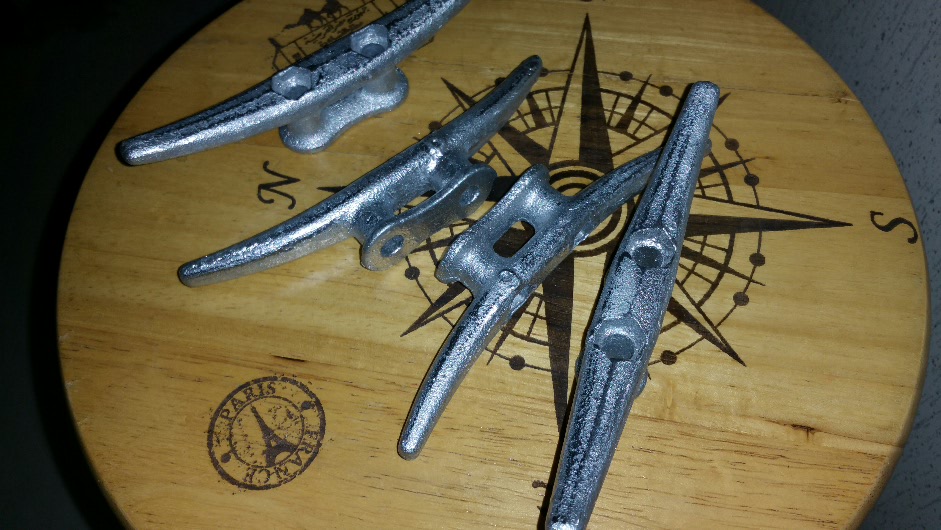

So these came in this week to replace the little ones mounted that only 1/4 inch rope would fit, they had lots of burrs and sharp edges due to sand castings and then hot dipped galvanizing
I spent a few minutes with a file and they are now smooth and wont cut rope

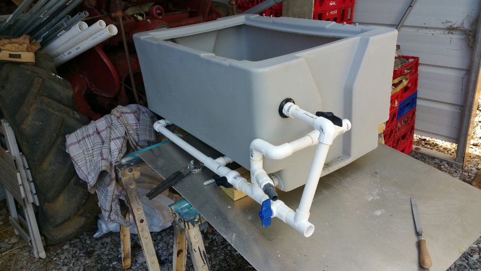

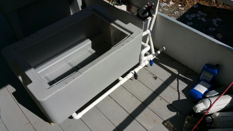

Re: Bansil and MamaTurtle create a getaway cruiser

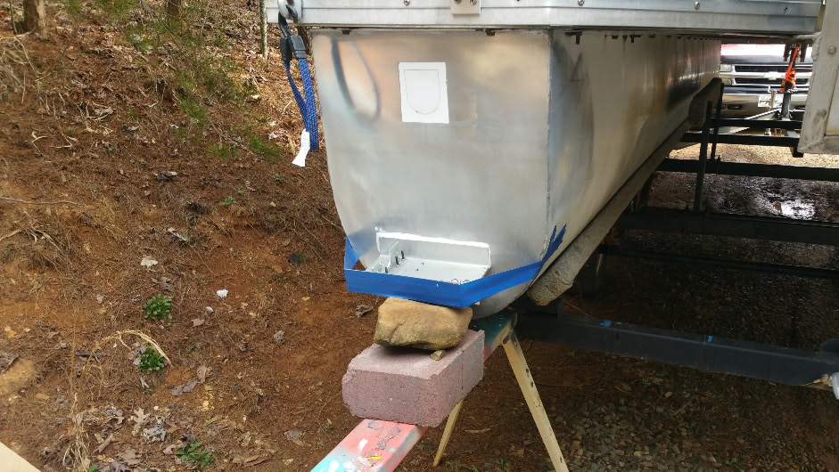

Well started day off by glueing everything up tight, putting into boat..
And then removing it to fix it...argh...
You can compare both pics, the other day and today
It drains/overflows out the side like normal boat piss holes

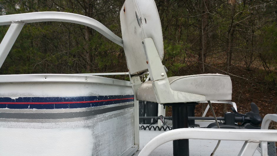

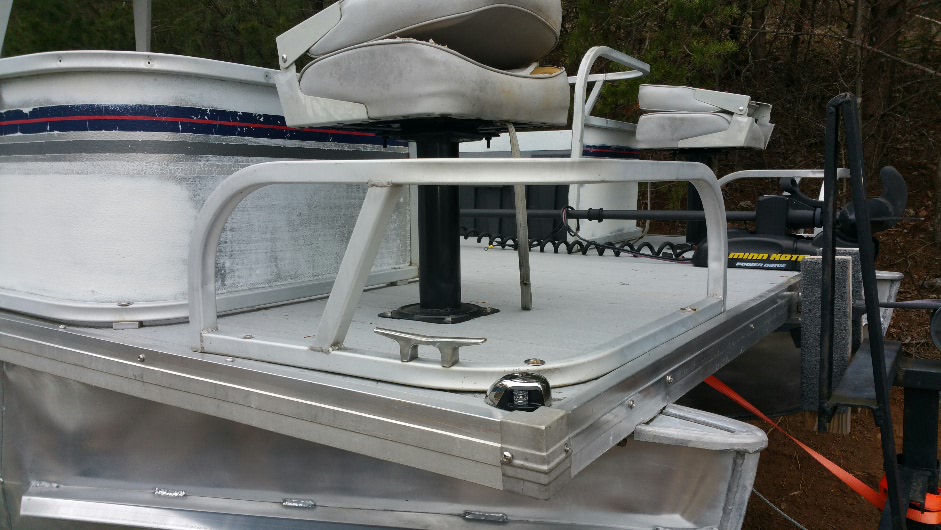

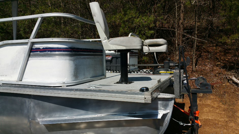

Next was to fix the front, the seats hit the rails when you tried to turn around, pain in the arse.
Next cleats were way sloppy loose and needed to add more in better places
So rails removed and will use them on back sundeck i need to make. And seat moved forward 3-1/2 inches

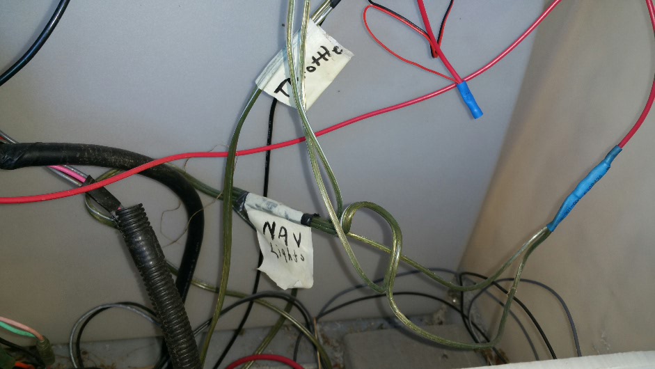

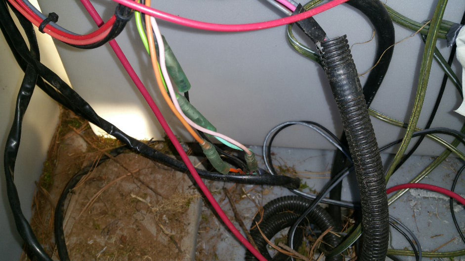

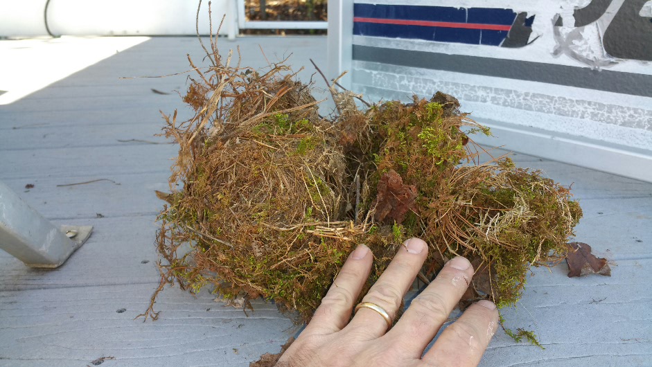

Then it was going to be move console and prep for modifications....ugh...after i remove a huge birds nest.
Wiring is sketchy as shit, 10 gage power and 16 gage ground to fuse box and bus bar....err...so i need to run a bigger ground wire to bus bar
Unmarked wires and cheap speaker wire used a lot.
Biggest thing i caught? A non factory speaker wire named....throttle....yup...throttle, with guess what? A blown fuse, so i will go through manual tonight and see what that is about

- Posts: 5446
wire could be choke or kill switch.
you are correct, until I find some time to trace and use a meter (hopefully Sunday) it could actually turn on a unicorn glitter fart machine...lol...
Al tho, I doubt that, she starts right up and will run until bulb/water separator/filter is empty then it dies, pump bulb...and fires right back up until out of primed fuel
waiting on fuel pump diaphragm kit to show up.
Also to EDIT post with plumbing
the lower black valve controls tank fill or drain
the blue valve controls tank empty, tied into overflow, out of boat
and the forward black valve is lake water wash down for dirt and sand
so upper black closed, blue closed and lower black open, water will flow in and exchange dirty water through over flow
close lower black, close blue and open upper black and we can wash off deck etc with lake water
close upper black, and open lower black and blue with pump off and I can drain tank (will leave about 1 inch to vacuum out at home after fresh water rinse )

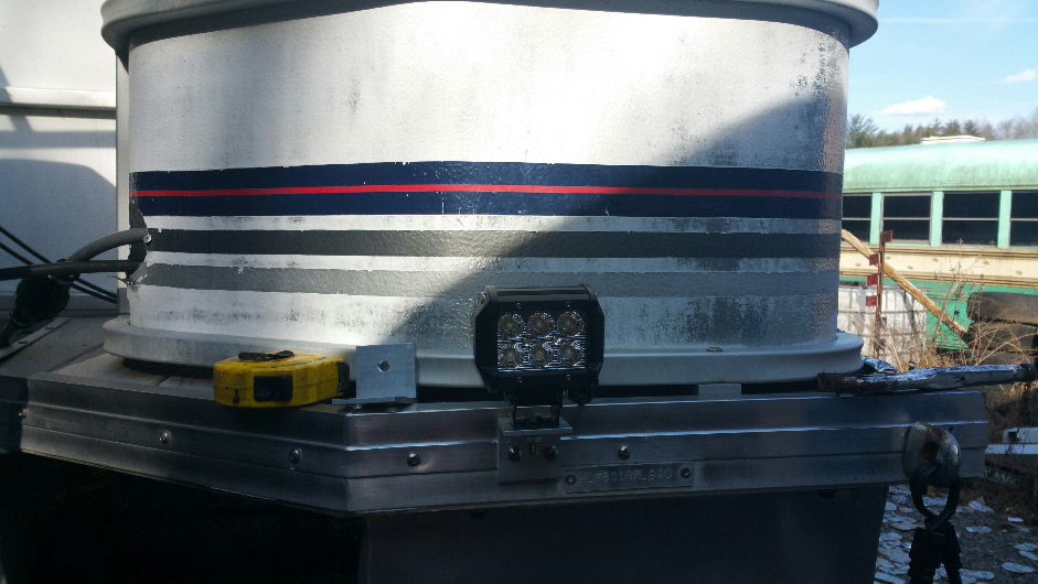

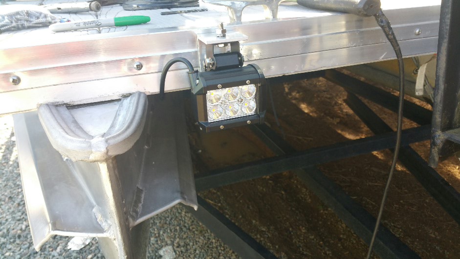

Worked on a couple things today, expecting 4 in of snow next 24 hrs.
I made 4 brackets and mounted some lights

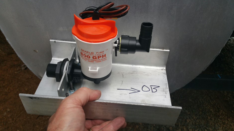

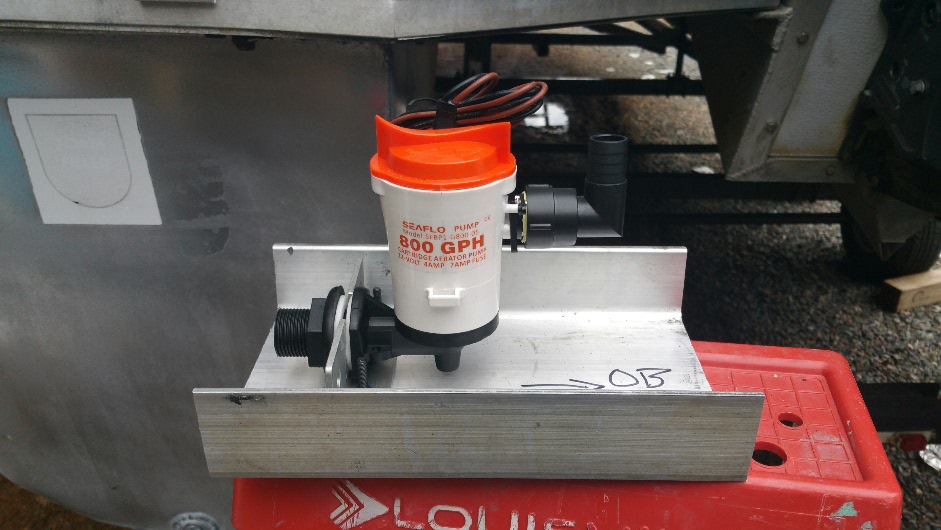

Had an hr tonight to sneak in some work between feeding and playing
Finished up livewell fill/recirculate pump skid plate mount
Will still add a "rollcage" later
I will mount here with 3M 5200
Real quick mount for pump, clean, 60 grit and then 3M 5200
Off to take dad for ct scan...moar later
Notice precision angle adjustment?
