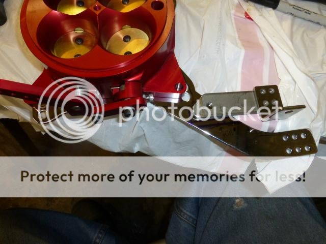

Fabrication, fabrication and more fabrication....and that's no lie

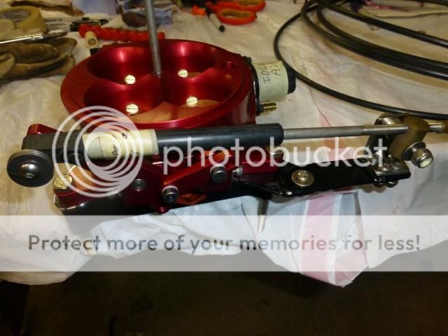

Adapting a Merc cable to a Holley style throttle lever took some time.
The Mockup
The finished product-using an old cable. When I get the motor back in the boat, my existing cable should just click in....ummm.....should.

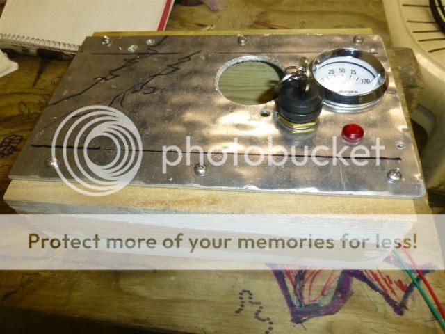

Temporary control panel

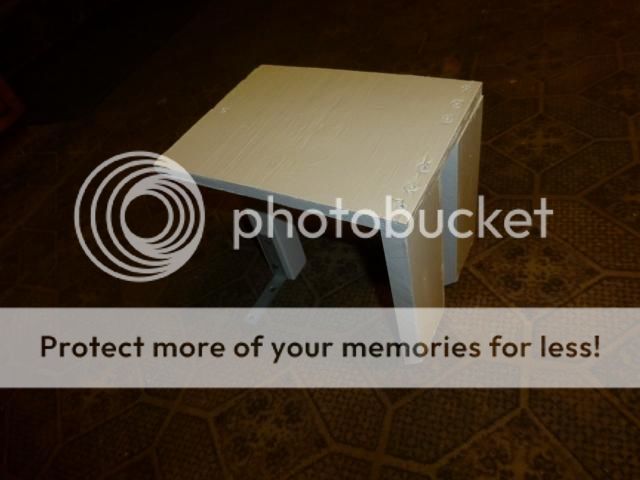

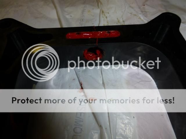

Not every fab went perfectly. Here's a plastic spacer for below the throttle body that I thought was solid until it came. It was sort of hollow and I needed to tap some pipe threads in it for a sensor. I had to give it a try just because. If you look closely, you can see the crack where I wrecked it. I have an aluminum one on the way.
The Mockup

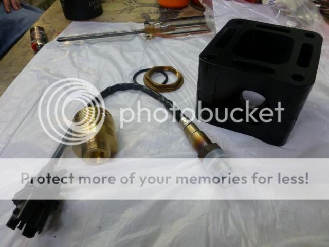

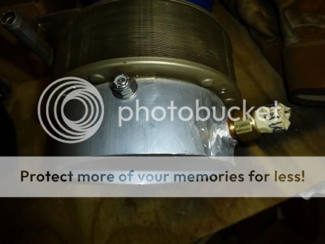

O2 sensors need to stay dry. Sooo how do you mount them in a wet exhaust??

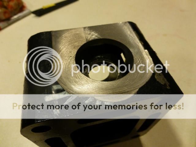

I found a very special adaptor that required some very special milling in my exhaust spacer. I'm glad I proceeded with the exhaust diverter project this year, which required the spacers. Otherwise I would have had to tap into my exhaust elbows, which would have been much tougher.

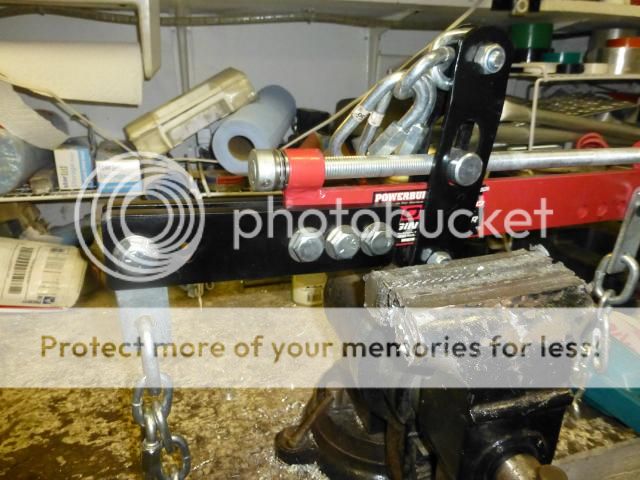

Load leveler for hoist needed to be longer so that the chains wouldn't interfere with my fuel rails. So I made some shackles (black)

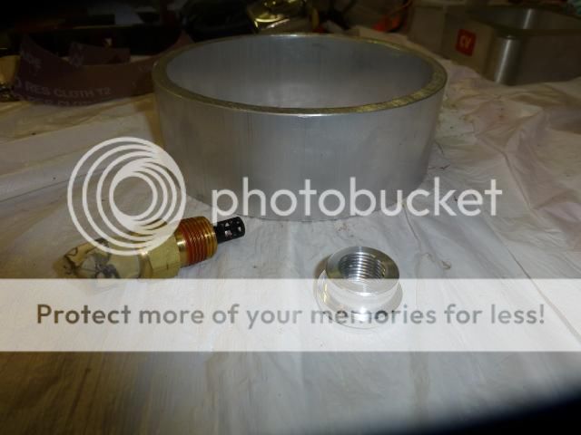

I needed to space my flame arrestor up a couple of inches so as to not impede my throttle arm. The spacer pipe I found made a perfect place to weld in a bung for my Intake Air Temp Sensor

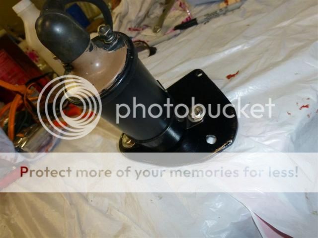

Aaaand even more fabrication:

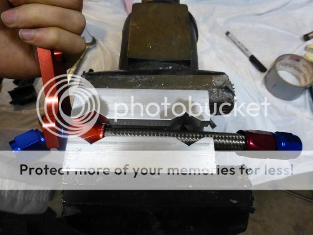

Finally made some fuel hoses (most of them). The Koul Tool worked like a charm.

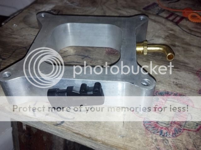

The solid aluminum throttle body space that I got to replace the plastic one that I busted drilled and tapped so nicely that I just had to put an extra hole in it. Map Sensor & PCV Return.

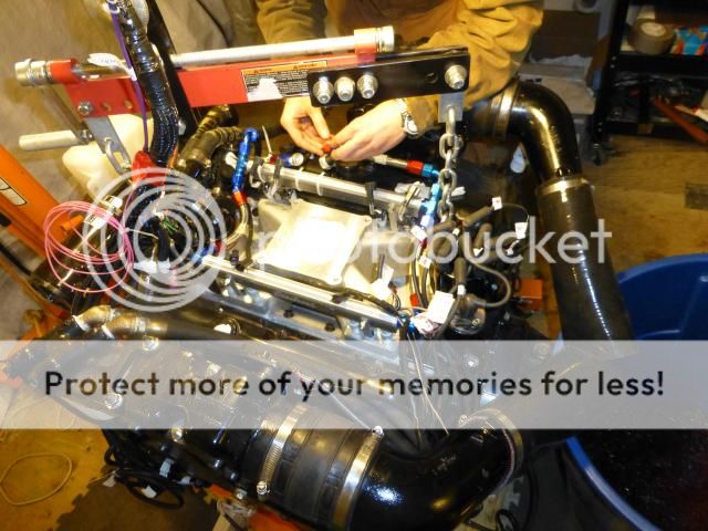

Finally got around to actually putting some parts on, although fabrication continues as well.
Much of the fuel system is on, although still waiting for a fitting or two.

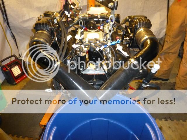

Seeing as I am in the middle of modifying my exhaust, I had hoses and elbows of various sizes lying around. Enough to make this MacGuyver exhaust.

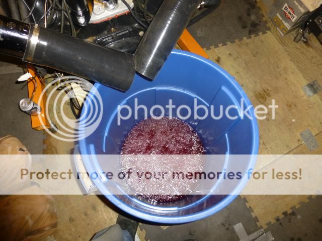

Temporary cooling for my test start. I am going to use Propylene Glycol (RV antifreeze) for the seawater portion of my cooling system. Just drop a utility pump into the bucket and recirculate the fluid along with the exhaust. It will eventually heat up but I won't be running that long. Of course, it needs to be warmer than 10 degrees for it to be pump-able....ahem
The engine portion of my cooling is already full of Ethylene Glycol (Automotive stuff) good to 50 below. When I shut down after testing, I won't even have to worry about any of it freezing. Already winterized in all sections.
