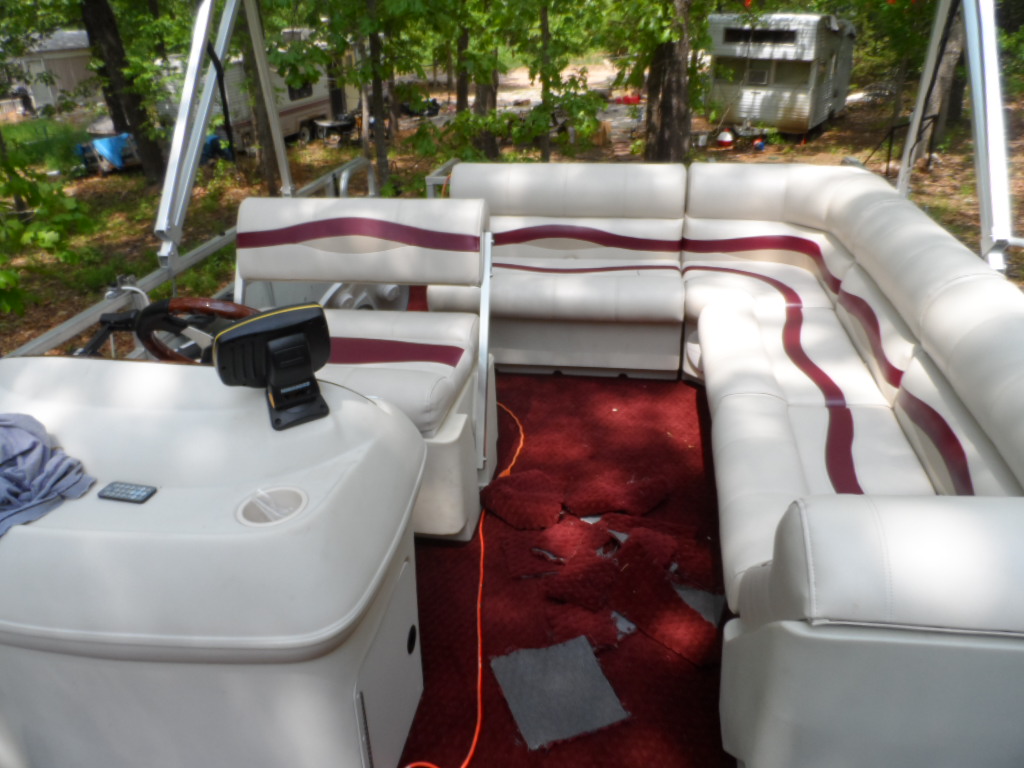

Looks good????? That sucks Herb!!! I had my own setback!!! Post to follow tomorrow... Heres how my carpet looks no nutkick intended...
- SAM_0986.JPG (286.1 KiB) Viewed 13086 times
- SAM_0985.JPG (287.78 KiB) Viewed 13081 times
