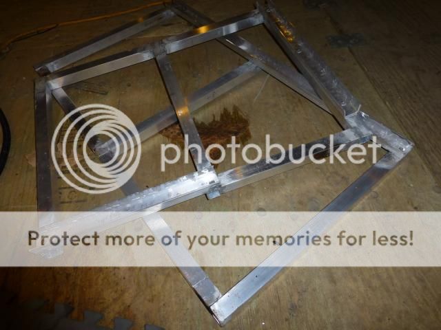

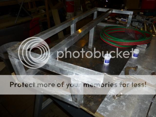

Back to brazing
There I built something

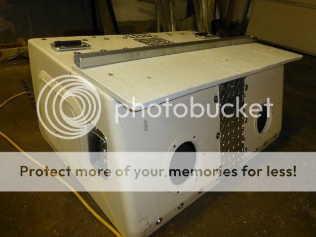

It was a fairly complex structure with some rabbit cuts etc...

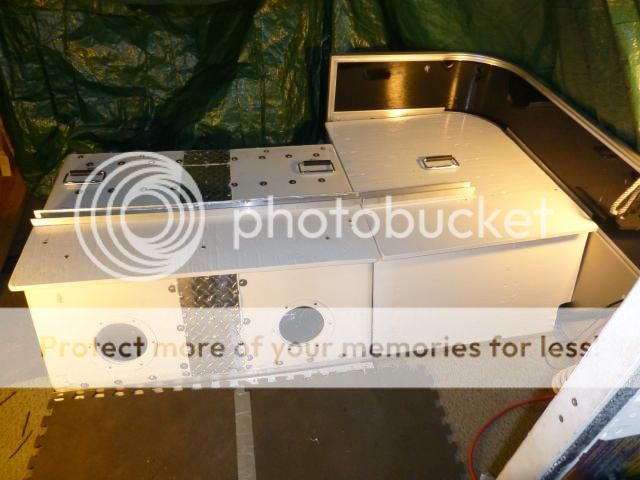

It fits nicely. Black side skin is cut and diamond plate for the top of it.

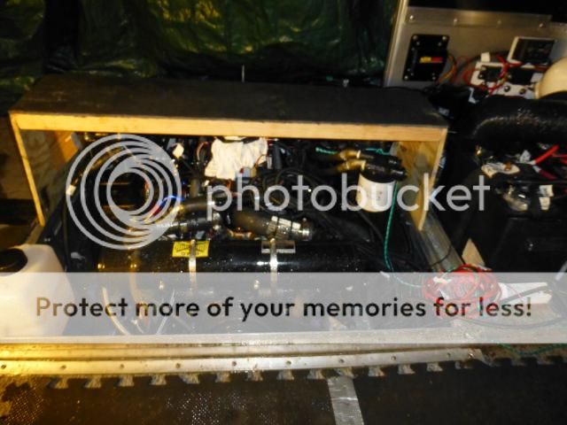

Some more complex multi-level racks for something or other
Doghouse got some goodies. Bench and track for sundeck build (see previous pic). And some strategically placed handles. Yay! That beastie is getting a bit heavy and awkward.

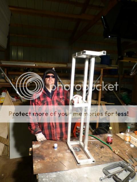

Finally, this thingy. Any guesses? Its a tough one, but of course it is something that I built with my own three hands. When is it every easy?
Here's a hint: It will make my life a LOT easier

Back to brazing

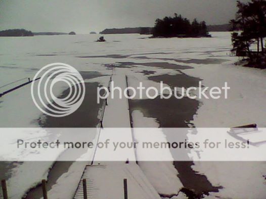

Same viewish-A SLIVER OF OPEN WATER! A closer look reveals a rather large sheet of ice STILL looming ominously out on the big water. In mid-May. Unreal.

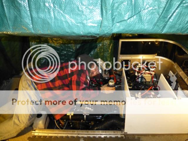

Here's what that bench is for. I laid on it for several hours the other day and finalized most of my engine wiring. Very comfy with the rubber pad glued to it. It did indeed make my poor old back much happier and will continue to do so for years to come.

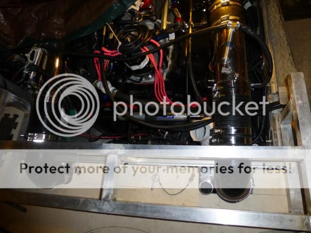

3. After completing final wiring, a quick test of the new in-tank fuel pump and assorted hoses yielded no gushers, although I did detect a faint odor that I need to track down. Fortunately, I now have TWO independent fume sniffers in the bilge that automatically turn on TWO bilge blowers. A third sniffer in the battery compartment (yep I'm a safety freak). I also need to final adjust the fuel pressure regulator.
ECU controller at helm booted right up and all codes cleared! Basically ready to test fire (again) once I get it pulled out from the shed. Looking forward to running it on the garden hose for a longer period so the computer can 'learn' and lean out a bit. Looking forward to not having to breath so much smoke this time

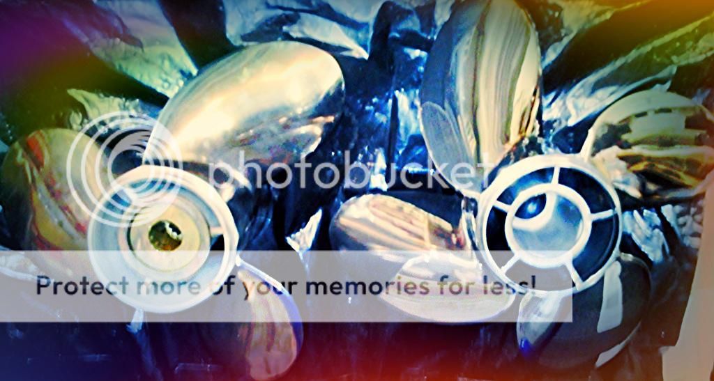

So I was messing around with an editing program and...I don't know if its art, but I like it.
I call it 'OUT WITH THE OLD, IN WITH THE NEW'
I'm going from an old Merc 3 blade (Mirage Plus) 19p to a 4 blade Powertech OFS 15p. Excited. I already tried a Powertech midline 4 blade (ELE) and liked it, so I traded up. The OFS (Offshore) is the stud prop for these guys and is very well regarded. They will swap props (for a fee) until I am happy. Likely I will end up with a 16p or 17p in the OFS
