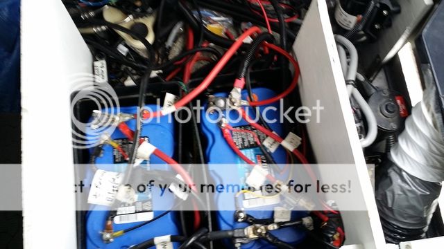

1. Major rewire---scrap my two 8 year-old batteries. Replace them with THREE. Photos later. This also includes breakers and heavy wiring to accommodate a large (1500W) inverter in order to run a small band on the front deck :guitar. I have crunched the numbers and it is doable. Pulling the new cable, however, is another matter. I seem to recall advising CaptainJohn to install as much wiring as possible before putting the rubrails on. Sage words. Taking off some of my rubrail as we speak...at 15 degrees....sucking.

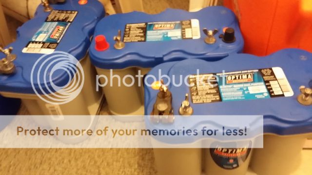

Brand spankin new Interstates on deck! I got a great deal on some blems with full warranty.
They are identical AGMs, a type that I have never used before. After doing a ton of research, I now feel fairly well read on types of batts and charging systems. The AGMs will be nice in that they don't 'gas off' which is much safer for fire danger and/or corrosion. They are a bit touchy in that you can't draw them down completely (although they have GREAT storage capacity).
Along with good output for cranking, they should be ideal as combination starting/deep cycle.

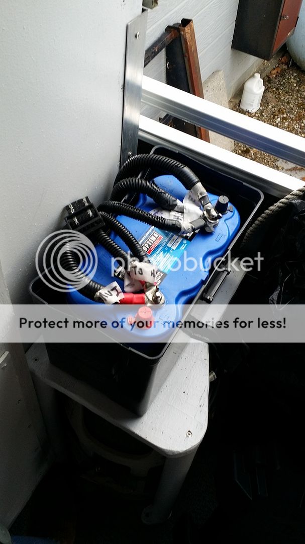

My new looming tool kept me from cutting my fingers too bad. Doing 4AWG cable here. The 2 Gauge was even more funner.

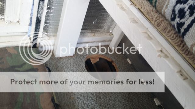

It was a nightmare trying to pull wire (using a nylon pull rope). Everything was under the floor, packed with other cables, and a right angle to boot. I finally gave up and cut a big a$$ hole where the Ell went. Fortunately it ended up being inside the building and under a bench just by coincidence. I put a round hatch on it later to seal it up.
Those Purdy AGMs are all mounted and hooked up. LOTS of hours. New solar controller and monitor. A bunch of new breakers.
1500 Watts of Pure Sine Wave on the new inverter. That outta run some band gear (with delicate electronics). Not quite sure what kind of staying power it'll have.

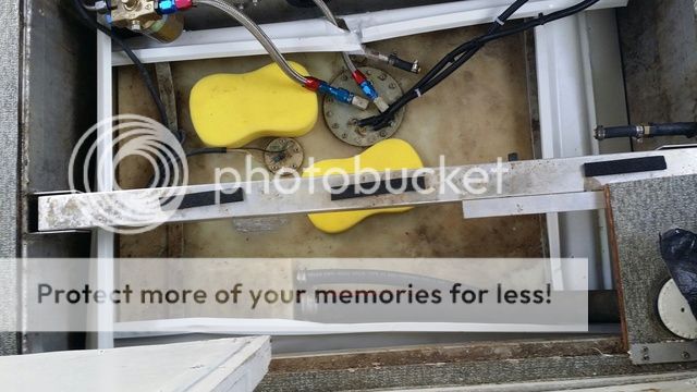

Finally finished my upgrades. As posted elsewhen, I was getting water on top of my slightly concave fuel tank. I was more than a bit concerned about water intrusion into the fuel. Here is my solution (in 3 parts):
#1-Wider aluminum seal strips and thicker, better quality foam glued to the strips for primary seals.
#2-If water does happen to get past my primary foam edge seals, I used a whole dollar's worth of aluminum rain gutter to help divert stray drops to the OUTSIDE edges of the tank, thus out of the compartment via the bilge.
#3-If water STILL finds a way past my secondary diverters, a couple of high-quality sponges should wick it up so that there is no standing water on the tank. I will have to check these every couple of weeks.
In the process of working in the area (my aching back), I put in a better fuel filter and some new hoses. No leaks!! FINALLY movin on. Into launch phase now. I should be starting motor on the hose shortly (still suspect a vacuum leak). Weather looks great for this coming weekend. Ice just went out on the lake. It's time to kick the tires and light the fires!!! :nana :drink4
