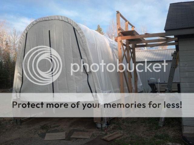

I had that same thought.......pond tuuunes wrote:im not sure how fast your tune is gonna be. But are you worried at all about how much wind your "shack" can take?
The thought crossed my mind. It was originally built by the old woodsman Al quite sturdily although lightweight. I have continued to upgrade since. Single lengths of conduit bent from floor to ceiling to floor all in one swoop. Steel angle at top and bottom of walls to weld it all together. A combination of vertical 2x4s and 2x2s at the corners. 1/4" plywood with u clamps bolting it to the conduit in quite a few places stiffens it up greatly. I also tied into the rails for further strength front to back. The roof is generally built in the same way with the front edge especially beefed/sandwiched to take the blast.pond tuuunes wrote:im not sure how fast your tune is gonna be. But are you worried at all about how much wind your "shack" can take?

She's quite the trooper, I guess. It was nice of them to recommend her and I'm impressed they knew she would be willing to help.tuned wrote: As the main tarp weighs in at about a hundred pounds alone, it was recommended to use Pam ..... Worked like a charm]
Not only willing to help, but supplied the right amount of lubricant. Only problem is she got it all over my old plow truck (which I was carefully using as a ladder extender). Although I had to clean the windshield so I didn't make 'muddy oil', the body will probably never get washed. I figure it is now doing double duty as rust preventativewoolznaz wrote:She's quite the trooper, I guess. It was nice of them to recommend her and I'm impressed they knew she would be willing to help.tuned wrote: As the main tarp weighs in at about a hundred pounds alone, it was recommended to use Pam ..... Worked like a charm]
