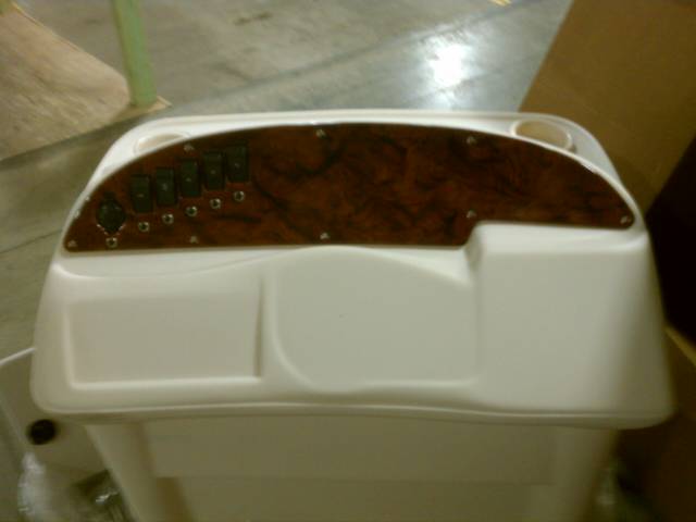

anyone have any thoughts on how hard it would be to either paint the wood grain dash panel or put an adhesive vinyl over it? I'm not a big fan of the wood grain. Looks like there's a decent amount of contour on the dash panel so a vinyl wrap may be a bit difficult.

Its just an overlay. Pretty sure you can take it all the way off. When I cut my gauge holes it was a seperate layer.
Ty should be able to tell you for sure.
Depends if you want the switches built in, if not then just go with the cheaper one with no switches or wood grain. I will tell you the built-in switches make it easy. But then again I used the PS wiring harness so it was just plug and go. Yours will probably be different plugs.

The panel is a vacuum formed ABS piece, so it should take prep/paint as well as plastic can. A wrap would be difficuld because of the rounded edges/switch locations. If you have a material in mind that you want to use, perhaps it may be better to make your own panel, and use the standard 5 switch panel and mount it below? Either way you have a few options.

Thanks for the info in regards to the dash panel. I may just be content with it for now until the get the boat running, then look at modifying the "bonus feature" stuff.
