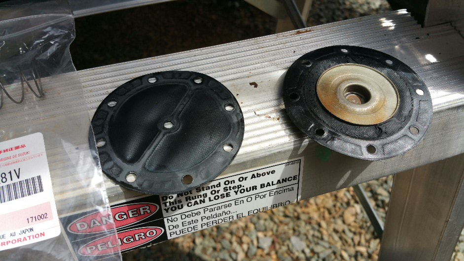

Rebuilt fuel pump, diaphragms were in pretty bad shape

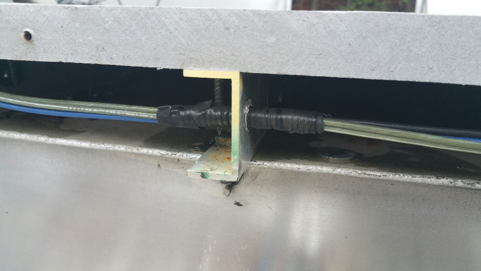

I put plastic wire loom over the wires that went through very rough bulk heads (they were not deburred)

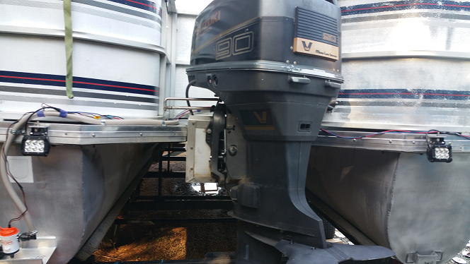

not much to report, I tore all the wiring out, half of it wasnt connected to anything, nothing worked correctly

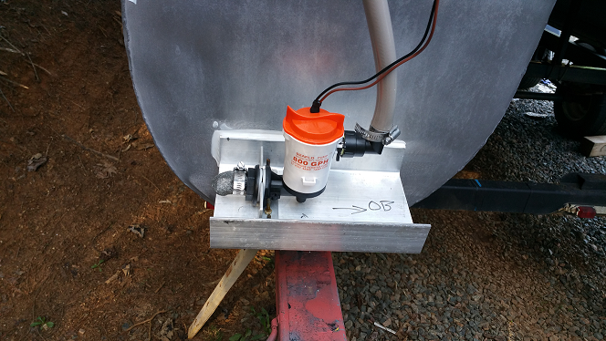

I did mount the live well pump, ran wire and hose (still need to secure and wire loom it, wire loom came in last night thanks to Amazon
hopefully Saturday all the wires will be covered and secured
gages are in the house so I can piddle with them at night
Also added air horn I had from another project, just cause
couple pictures...just because
ETA I will probably move the live well fill inside a few inches and move hose after looking at pictures, it looks vulnerable to damage if rear of pontoon swings out

Looks great! you might want a cage of some kind over that pump? Just in case.....

Yeah I haven't finalized what I want yet, I agree with you on that, I really need to buy a AC/DC Tig machine for the house

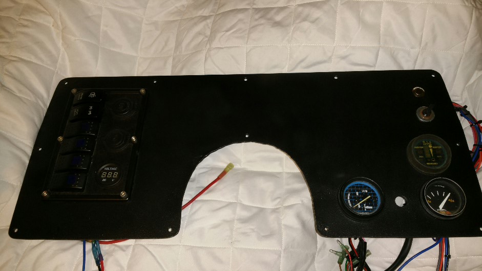

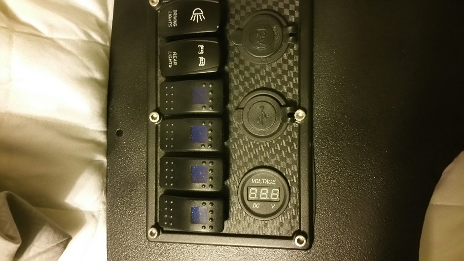

Got dash put together and now know what all wires go to what
Modified the basic switch panel by swapping out 2 switches and taking dremel to the double D's
So i had a round hole to index volt meter Top right
Horn
3 pos nav/mooring lights
Gags and n/off switch between bottom gages
Horn

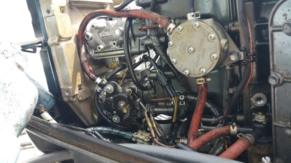

and still had issues, next step pull carbs and check for clogged jets due to ethanol
Guess what yup crystallized and green, that wasn't the biggest issue, very recently someone pulled carbs and replaced the needle and seat (brand new shiney brass and needle was polished and no scrathes)
When they put it back together, they tore the gasket (I found other part under engine) and this caused a massive air leak and explains the carb fuel mixture screws all the way rich
the engine would not run with any file due to massive leak after the throttle butterfly's, engine had 1/2 vacuum pulse for fuel pump also and they apparently, due to dent on carb, used a hammer to knock loose fuel bowl and it broke off the high speed jet in the process
