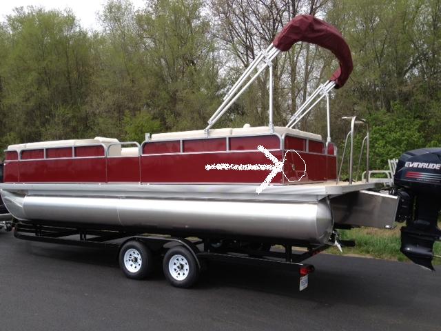

For those of you who have experience with new furniture. Based on the pictures that i've found, the gas cap should be above the 11" high aluminum fence rail piece. I don't believe the gas cap would fit below that without potentially causing issues. Based on the dimensions of the corner seat, I may have to cut into the back of the seat since the base is 12" high and the fuel fill will be about 12 or 13". Can anyone confirm that this is the standard procedure for this? I saw the one build where Ty ran his fuel fill into the lounge back, but the fuel line comes up right into the corner seat, so I'd rather not have to run a fuel fill hose through a lounge back, bench seat and corner bench. I was hoping to just be able to cut into the base, without getting to the back rest part, but I don't think that will be the case.
Pic 1 shows my layout. You can see the fuel lines coming up from underneath the deck
Pic 2 shows the exterior of the same model fencing that I have and where the gas cap is (not mine, pulled from the net)
Pic 3 shows that the gas cap would be above the 11" piece of fencing (12 or 13" probably)
Pics 4, 5 and 6 are the corner piece pictures
Here is the link for the fuel fill cap
http://www.go2marine.com/product/207743 ... ngled.html
Ferg's Tritoon Build
Re: Ferg's Winter Project
It's hard to say how it will work out until you have the seat sitting there, there isn't anything wrong with running a gas line through there or notching out the base, it's just whatever it takes to make it work.. Might also try backtoboating.com for a good selection on gas caps... Ezacdc.com is another good part site just FYI

On mine I used this unit: Perko, Combination Gas Fill & Tank Vent and lift a hatch to access and fill. On yours you may rig it up where you lift a cushion to fuel. You would still need to vent the seats in the back but that should be inconspicuous and easily done. A small spill bucket would also be a nice additional feature should you decide to go this direction.
You're going to be tied more to what fill you use and where it will fit on the fence. Look at this build I did, the fill goes in to the DeckMate base which is 12" high. It makes a 90 deg. turn and angles down to the tank. It fills fine, by can or pump. I get my fuel fills from BackToBoating.
