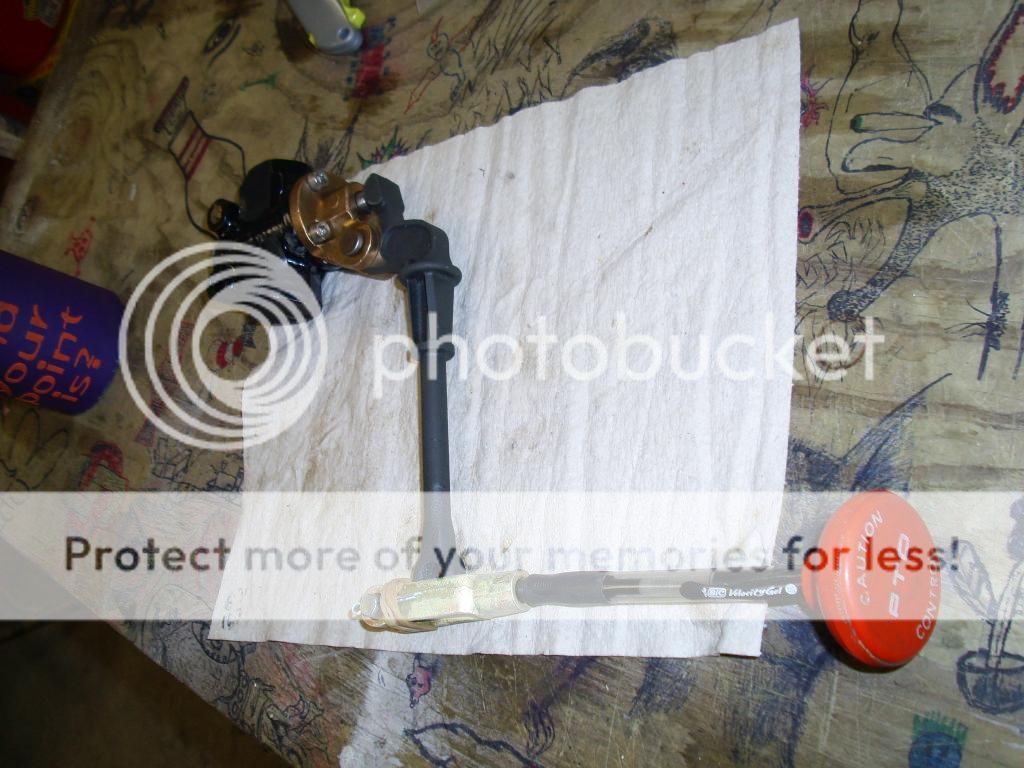

Rebuild of some VERY important weapons components

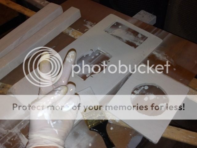

Mount boards for various items

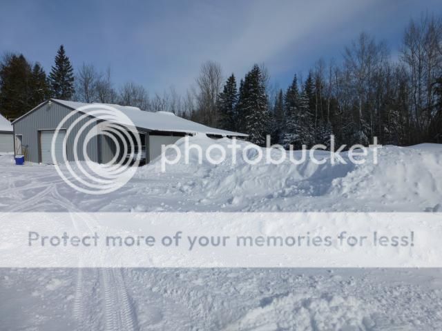

Ok so it's been a lllong ccccold winter. I think I saw a single drip of water fall from my roof the other day. About four feet of snow on the ground and about four feet of ice on the lake. Grrrrrr. I mean brrrrr. Lot of degree days.
And I'm running out of places to stack the damn snow.

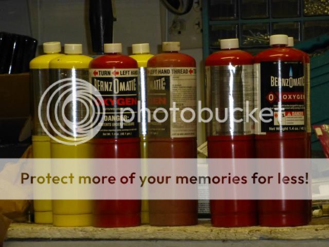

Tomorrow, I will give a full trial to MuggyWeld.com's Super Alloy 5 brazing rod. Rated at 30,000# tensile. Which is about half ish of steel but still very respectable. Flux and rod both get runny at about 600 degrees (aluminum melts at 1200plus), thus supposed to be very forgiving. Their advice was to let the flux determine everything. The claim was that they (or others) have done a LOT of railing jobs with great results. Thanks to Herb for turning me in this direction. Here's the link to a whole bunch of videos: http://www.muggyweld.com/videos/ Just look for Super Alloy 5 in the Aluminum section.
So I gots me some Mapp gas AND Oxygen which is supposedly easily enough heat for the job. About a hundred bucks worth.Image
Aaaaand about a hundred bucks worth of rod from the Muggy guys.
Here's the shot of initial cuts ready to go. A little Bernzomatic Map/Oxy with a nice small tip. Very hot, although not quite as Acetyline.

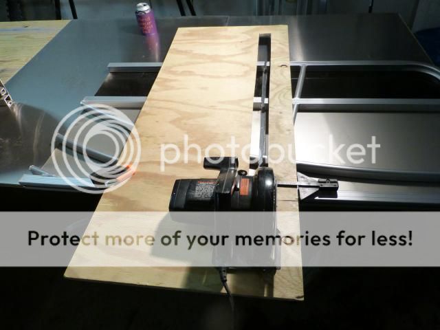

Here is the jig I use to cut the rails to a manageable size. It worked really well. They came out nice and square. I used a 'universal abrasive' disk on the antique Skill saw with the squealing bearing howling along to the Sublime crankin' on the stereo :guitar . It made nice thin cuts and didn't throw too much for metal shards, just dust.

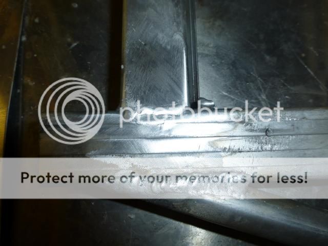

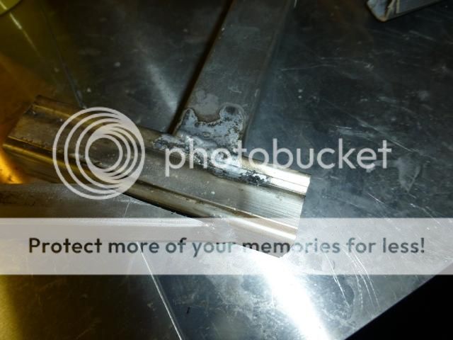

Now the bad part. Had a crappy time with the Muggy Weld. We spent hours and burned through a bunch of rod and gas. Tried a number of tricks and never got a consistant bead, so I couldn't do ANY actual rail brazing :donno . Maybe 1 in 5 practice joints was strong and looked OK. I need to talk to them tomorrow, but I don't think we had enough heat even with two of us running a Mapp heating torch AND a Mapp/Oxy rosebud. The rep had said that Mapp was enough, but I'm not convinced. Next step will either be to line up the Oxy-Acetyline or find a real welder to do the work. I think the Muggy Alloy probably can work well, but it appears that it is not as forgiving as they would have you believe. The bottom bead is the factory weld. The top bead is one of the better Muggy brazes, probably the best one of the day:
Here's a couple more practice joints that weren't too bad. They only got worse from there...MUCH worse. I won't torture myself by publishing them:
Final thought for an exhausting day: It is a very uncomfortable feeling to cut brand new railing apart in a bunch of places and not have a way to join it back up

I used alumaweld rods on my Jon boat. It took me along time to feet consistent at it but I'm pretty good at it now.. The rods I had they say propane is enough heat but I found out on anything thicker than a coke can an oxy ace. Torch was needed. The torch is not near as forgiving as the propane..lol... My welder I used highly recommended the sticks I used but only to patch holes not for anything structural, but that is only his opinion and my 2cents would be save yourself the trouble and hire a good tig welder! Ryan

Thanks Ryan. However, there are only about 3 good welders within 2 hours of here at the moment. We had a few more, but death...retirement...relocation...you get the picture. The guys that are still left are up to their armpits in work. It is the busy season for the loggers as they try to beat the spring thaw. There are busted trucks and trailers everywhere!
As far as the Muggy rod is concerned, I took one of the square tube joints with only two out of four sides tacked decently and put it in the vice. I then proceeded to beat the shit out of it with a 20# maul! I destroyed the square tube, but the joint NEVER failed. It is plenty strong for me. I just need to get better bondage. Wait that didn't sound right :biggrin2
So the next step is Oxy/Acetyline. I just ordered a nice little portable kit http://www.ebay.com/itm/281061726640?ss ... 1439.l2649and will try again next week with the right heat. It'll be nice to have a real torch around the garage anyway. Or I can turn around and resell it if I want.

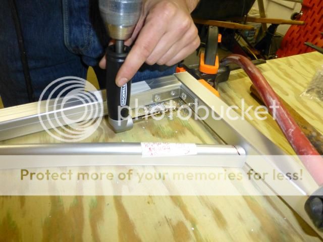

After realizing how hard it is to keep loose square tube lined up properly for brazing or welding, I decided to use a number of stainless corner braces to keep everything square. As I am still determined to braze this all if I can, the braces will be especially helpful as I think the whole joint will be molten and needs to be done all in one step with no 'tacking'.
The braces got a little involved, as I didn't want any slop when I put the rivets in and the brace holes were slightly larger than 3/16. I chose to drill out the holes to 1/4" which also gave me the advantage of stronger rivets (aluminum).

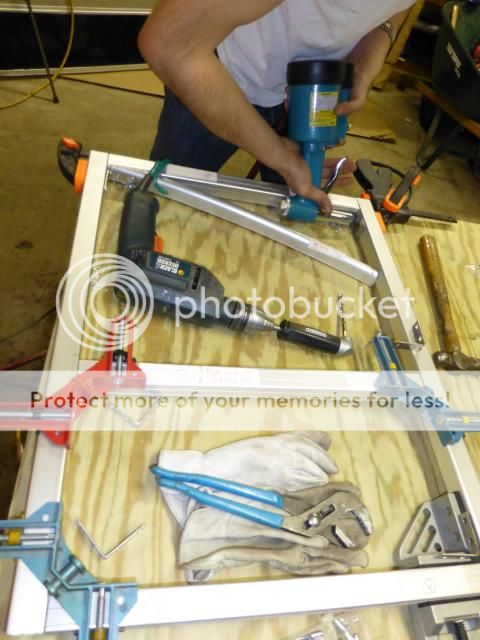

The problem there was that there seems to be no such animal in existance by the name of 'manual, right angle, 1/4" rivet squeezer'--believe me I looked. I ended up buying a nice little air powered one. Frickin awesome! Shoulda got one years ago. Would've made the several underskinnings I have done much easier....
My right angle drill attachment (quick attach bits for airplane work). Gets into all the tight spots. Gonna make actually mounting the rails much easier and neater. Every other old rail mount I ever did had bolts at an angle. Not this time
The air riveter--I AM IN LOVE WITH THIS TOOL! Just the sound alone...KaaaPooooooong!
That's lookin' like a homemade door. Just starting to get the 'filigree' lined back up here.
