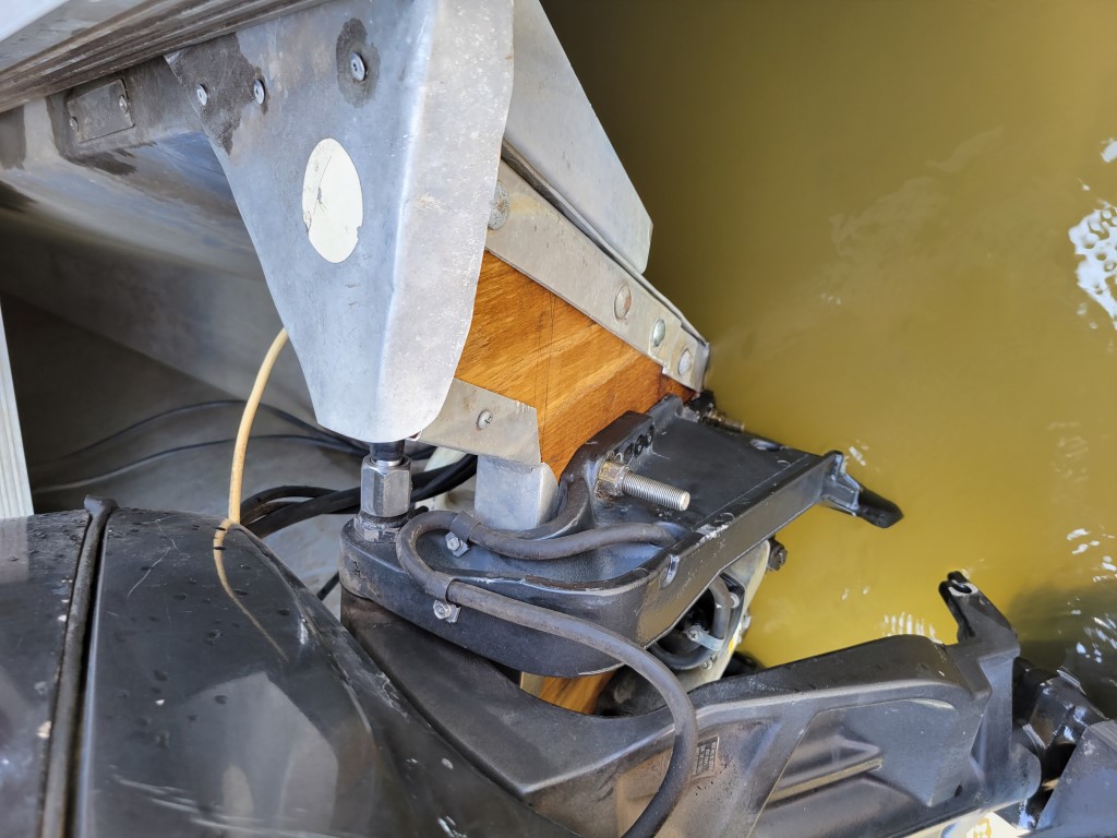

Ok, prepping the engine for removal. Hint on the steering cable, if you don't have enough room to pull it out from the front of the engine, suspend the engine then push it off to one side while pulling out the steering assembly.
You can see how much the transom has failed by this gap:
We cheated by using a FEL and tractor to do the lifting:

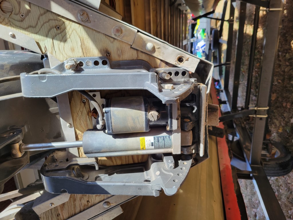

Now the work starts:
What was left of the original transom....completely dry rotted:
New 1-1/2" in Ply transom in and bolts snugged up:
Took about 4 hours with help of 3 buddies....

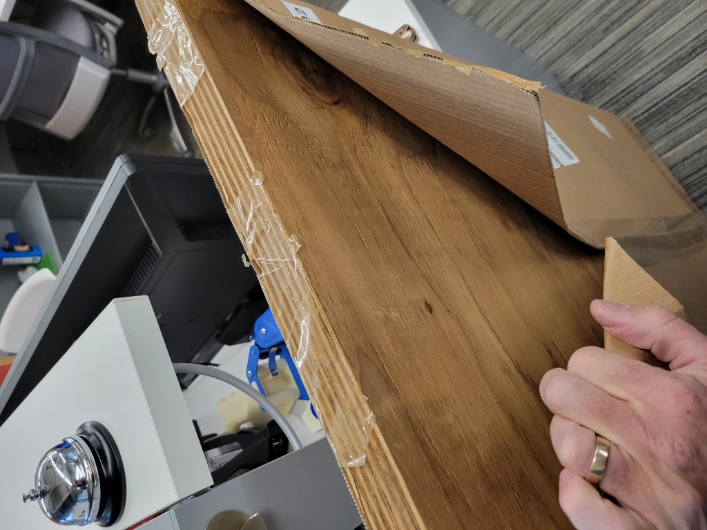

Nice! Just had my transom redone as well. Wood from PS and Welder at one of our jobsites added some support to the aluminum.
20230118_104311 (Medium).jpg (233.76 KiB) Viewed 287210 times
20221022_153107 (Medium).jpg (253.4 KiB) Viewed 287210 times
