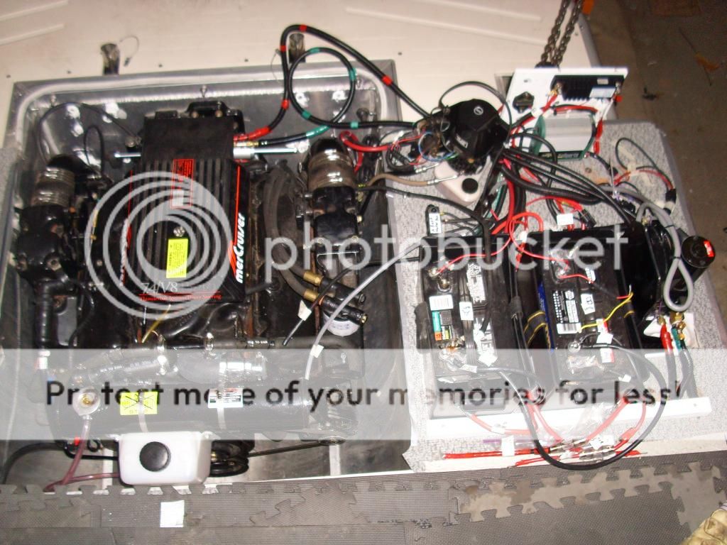

Fortunately, I am about ready for phase 27. Outdrive and swim platform are on.
SouthBay needs to redesign their swim platform mounts. The damn thing took three of us THREE HOURS to put it on. Grrrr. The outdrive took about 20 seconds.
Large wiring in rear is mostly done. I know it looks a mess. It'll get cleaned up.
All wire is tinned marine grade. Combination of breakers and monster in-line fuses.
All wires 6AWG and heavier have ring lugs crimped AND soldered on them.
A number of extra wires pulled and laying around for future upgrades including
autopilot, trim tabs, captains call, windlass, washdown pump/weapon. Note the Automatic Combining Relay at top of board. This is the fourth boat that I have put one of these on and I love 'em. I don't use a 1/2/both/off switch. My motor starting battery NEVER runs down. I can run the monster stereo until the deep cycle is dead if I want and still start up and go home...all without even thinking about it.

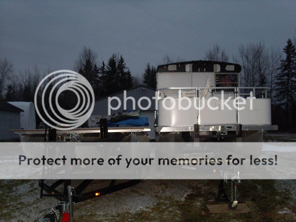

I call this one 'Flying Boat with Horns'....
'Redneck Dweeb in the Nort Woods'
'One 5/8 pontoon and one 7/8 pontoon'
'Doctor, the donor and the recipient are both prepped'
Tomorrow is the day that I perform a shack transplant.....ummmm.....again.

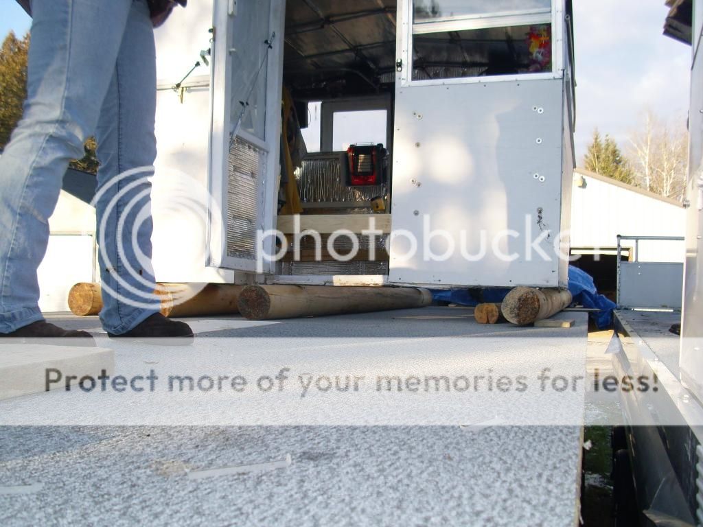

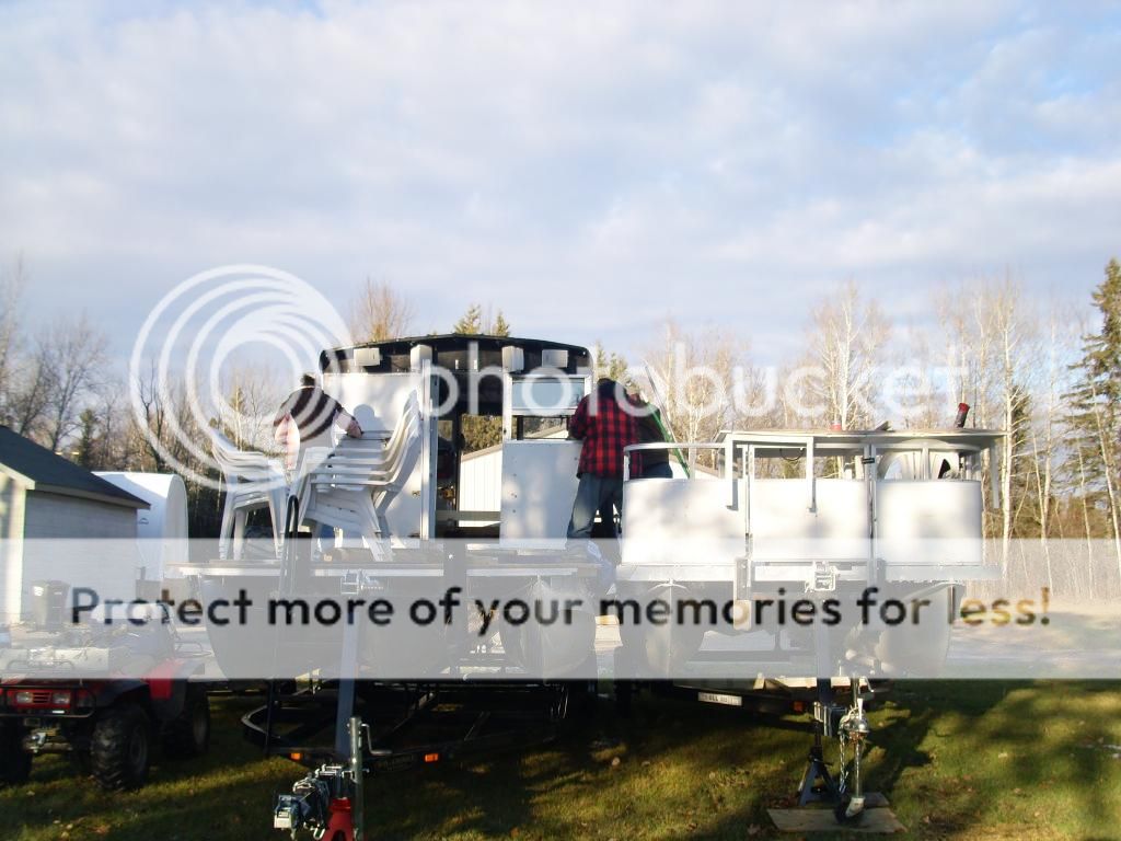

MOVING DAY! Note that this thread started with one of these logs as a jig to bend the underskin. Repurposing rules. I have more plans for those logs too.
ON THE MOVE
A SUCCESSFUL TRANSPLANT SURGERY!
THE PATIENT HAS BEEN MOVED INTO RECOVERY AND IS RESTING COMFORTABLY WHILE THE ANESTHESIA WEARS OFF.
I, on the other hand, am just beginning to self administer anesthetic.
There will be little to look at for the next few months. Mostly small wiring etc...I'll catch up this thread in the spring when it is time for sea-trials
