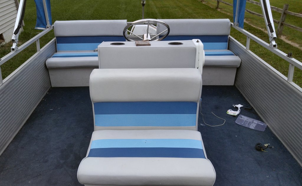

Where are you located? I have 2 38" Wise Bench seats (pictured above) and a 27" that I no longer have use for. If you were close enough these might help you out.
