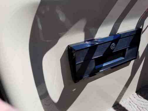

My main complaint about my Sun Tracker was the lack of a handy glove box. There is a locking compartment under the seats, but nothing easily accessible from the helm. Solution was a $25 glove box from Pontoonstuff.com, and about 20 minutes.

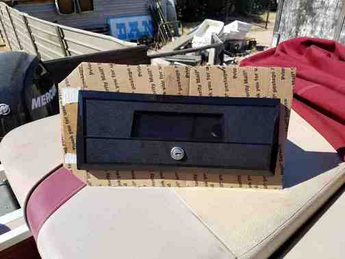

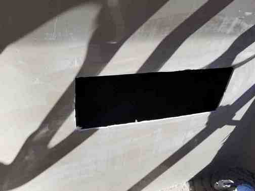

One complaint about the Pontoonstuff glove box was no template. So I made one.

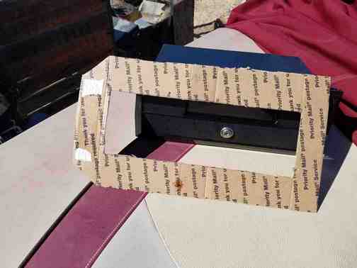

A free shipping box from the Post Office worked perfect.

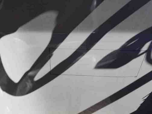

Traced the hole with a Sharpie. Make sure there's nothing on the backside.
Cut out with my Dremel Saw Max.
Test Fit.

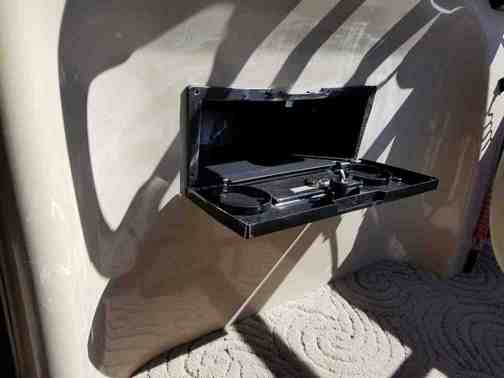

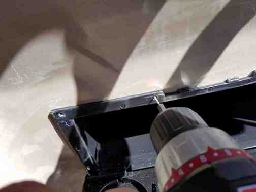

Drilled pilot holes

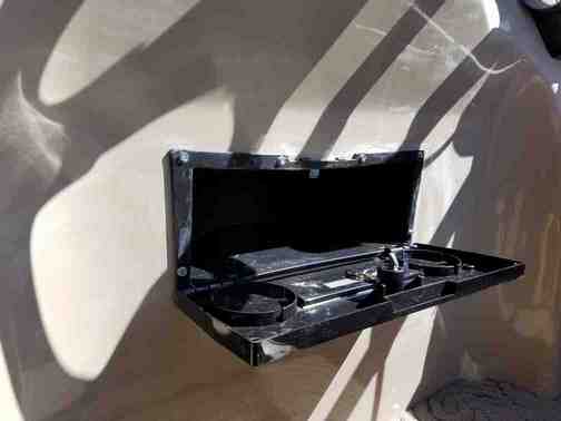

Installed with hex head screws

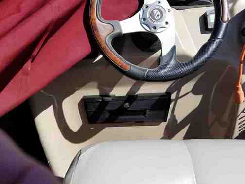

Final product, just what I needed.
Now i can throw my truck keys, cell phone, wallet, boat registration, etc. in, and have ready access to them all.
