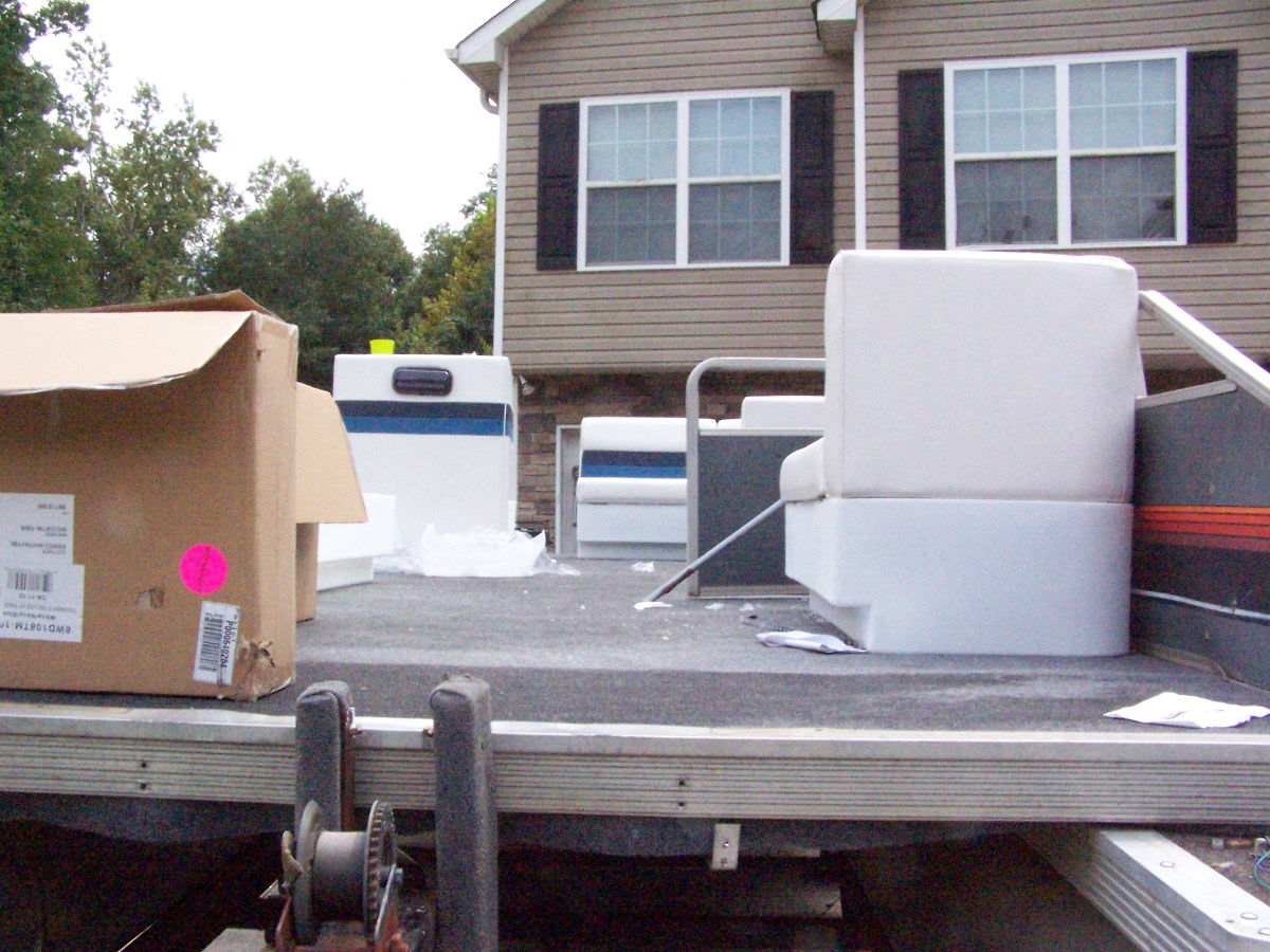

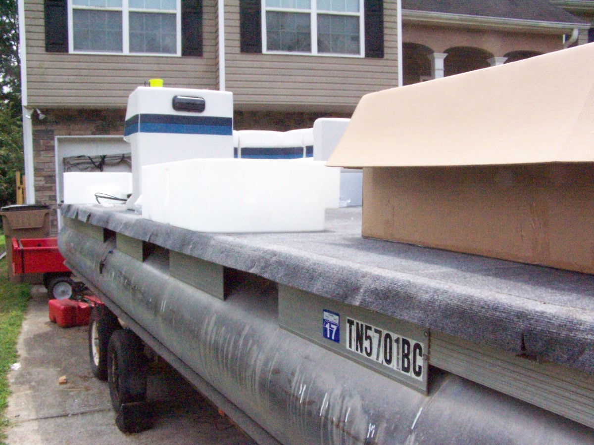

gonna have to fast forward just a bit...cant find the progress photos of replacing the floor (but I did I swear!) we did keep the carpet..it was in good shape ,and looked like it had been replaced not long ago. so now we have out new furniture set out to place where the Mrs wants it. Now...before the carpet was laid down, we placed the furniture where it needed to be,drilled the holes for the mounting bolts (and every other hole that needed drilled for wires etc) before sealing the top of the deck wood,that way all the screws holes etc get sealed too...
after the carpet was laid down...it aint easy lining everything back to those holes!
