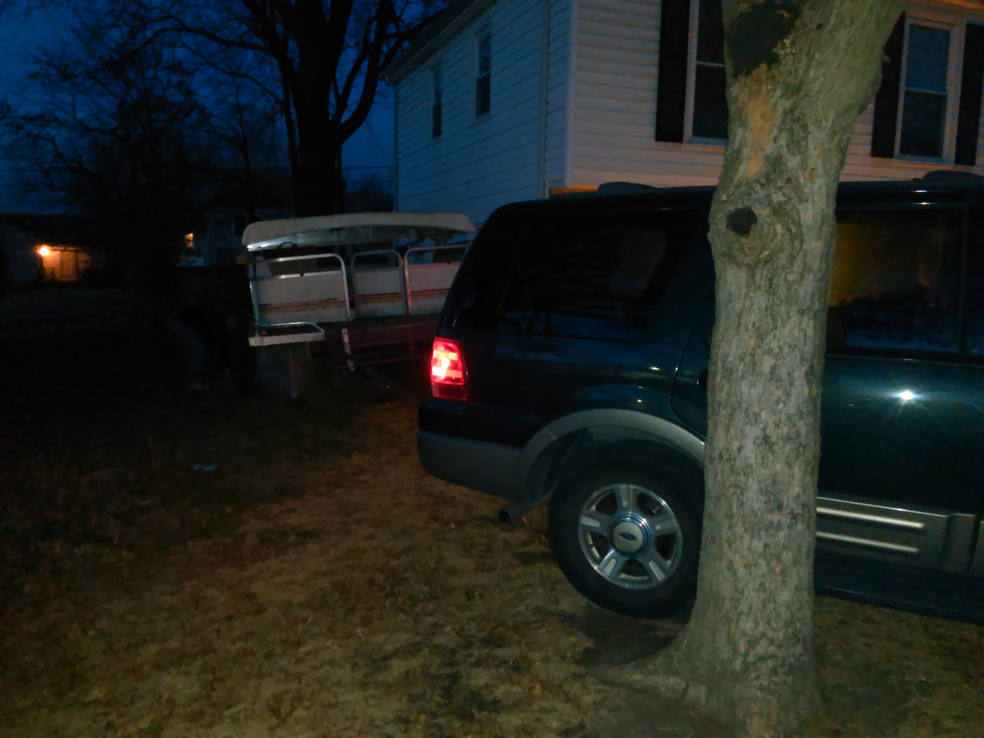

So I cannot have a bigger boat at my house unless we cut down a tree in the side yard! Tight squeeze!

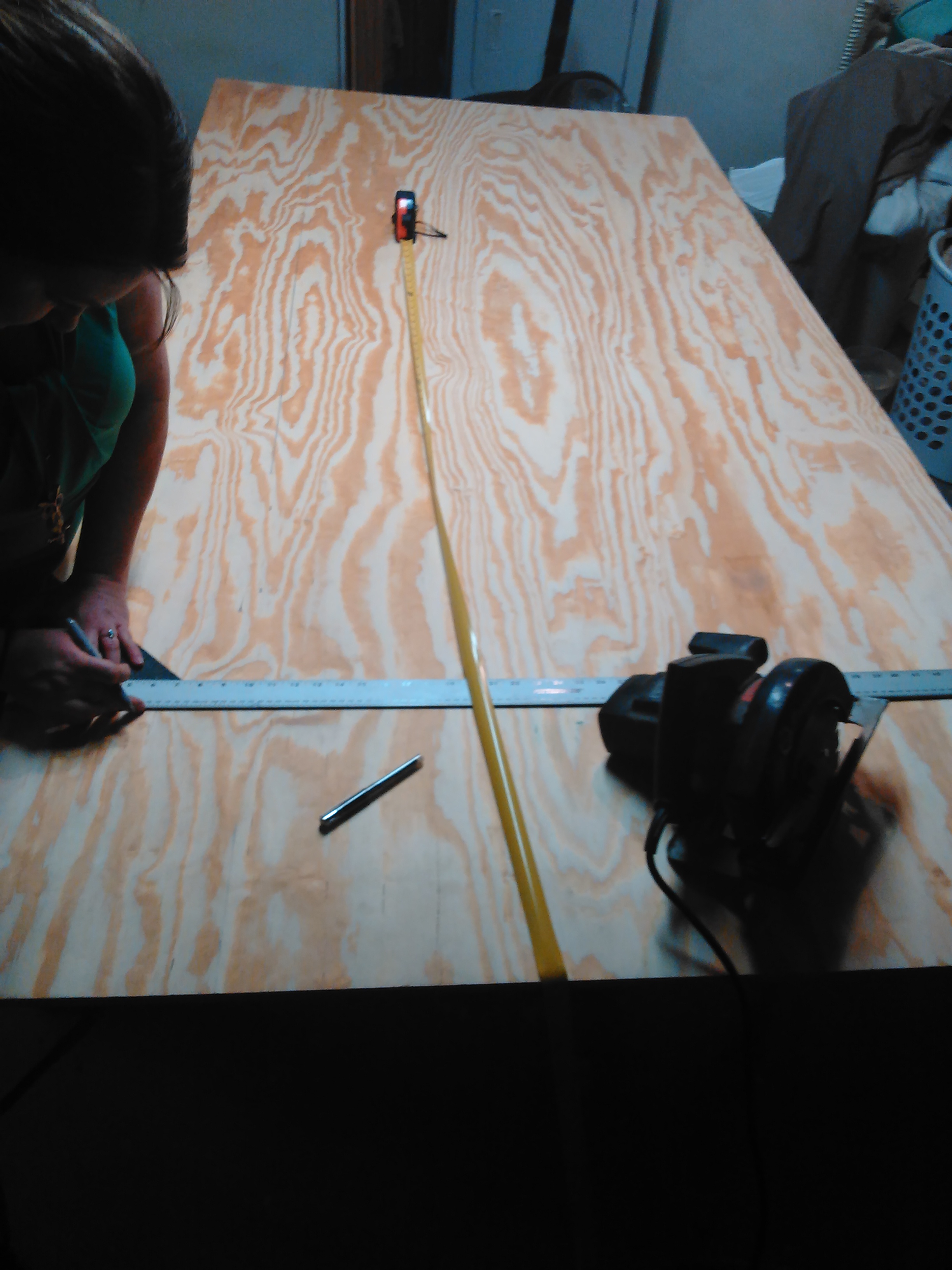

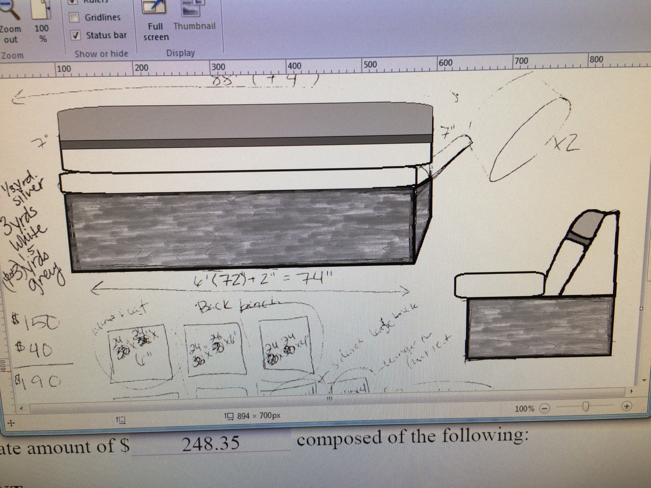

So there hasn't been too much exciting work, but we've been amassing materials. Our color scheme for the seats is going to be white and gray, with different shades of gray for accent. Perhaps as many as 50? HA. Dad jokes. I'll show myself out.

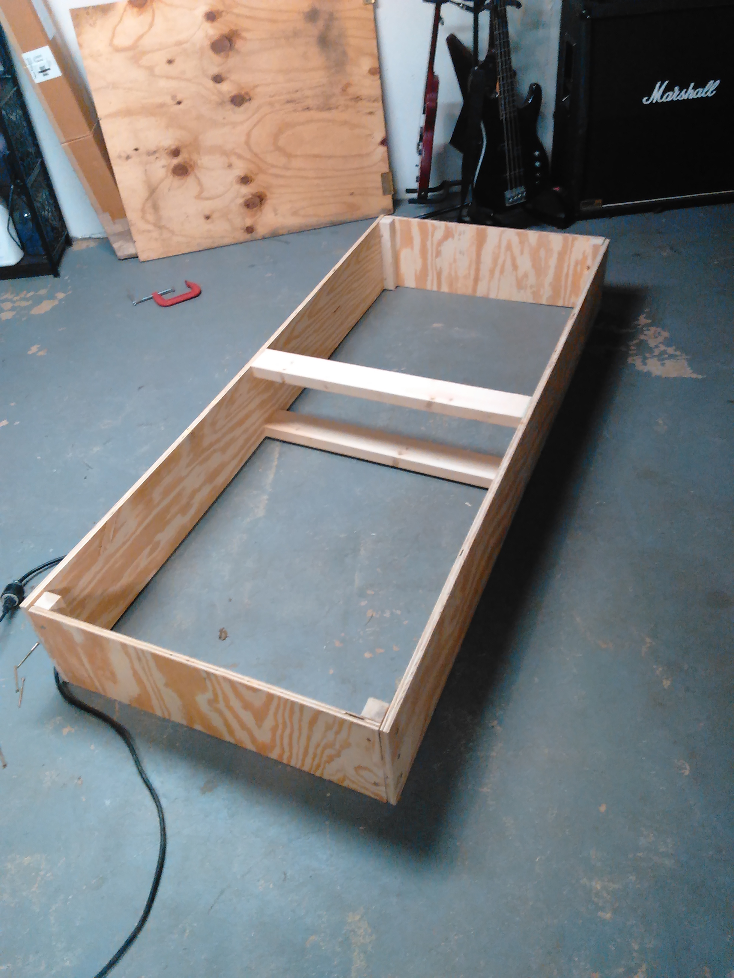

We will be building the seats out of plywood, 5/8" and 15/32" thickness, depending on where it is on the seats. The bases and buttrests will all be 5/8, the backrest assembly will be 15/32" , cause it will not see the stress of the buttrest and bases.
For the bases, we will be staining them with sherwin williams exterior deck stain and sealant. It should protect the wood, (which will never get that wet, because any time the boat is not being used, it will be covered), but still allow you to see the grain, and give it more of a vintage nautical feel. The buttrest will be white vinyl, and the backrest will be white, with regular gray and metallic gray accent stripes. Should look rad af, kinda flashy, but not over the top.
Since foam is expensive as hell, and we're trying to come up with the most baller boat possible on a budget, we've been pilfering foam from free furniture we find. The backrest of our benches will be 3" thick foam, and the bases will be 6". Stock foam was 2", and 3" respectively. This will make them similar to what you find on brand new pontoons, with massive, cushy, overstuffed seats. We will also be making them 10" wider then they were stock, and a little longer, so there will be plenty of room to lay out, lounge, or sit.

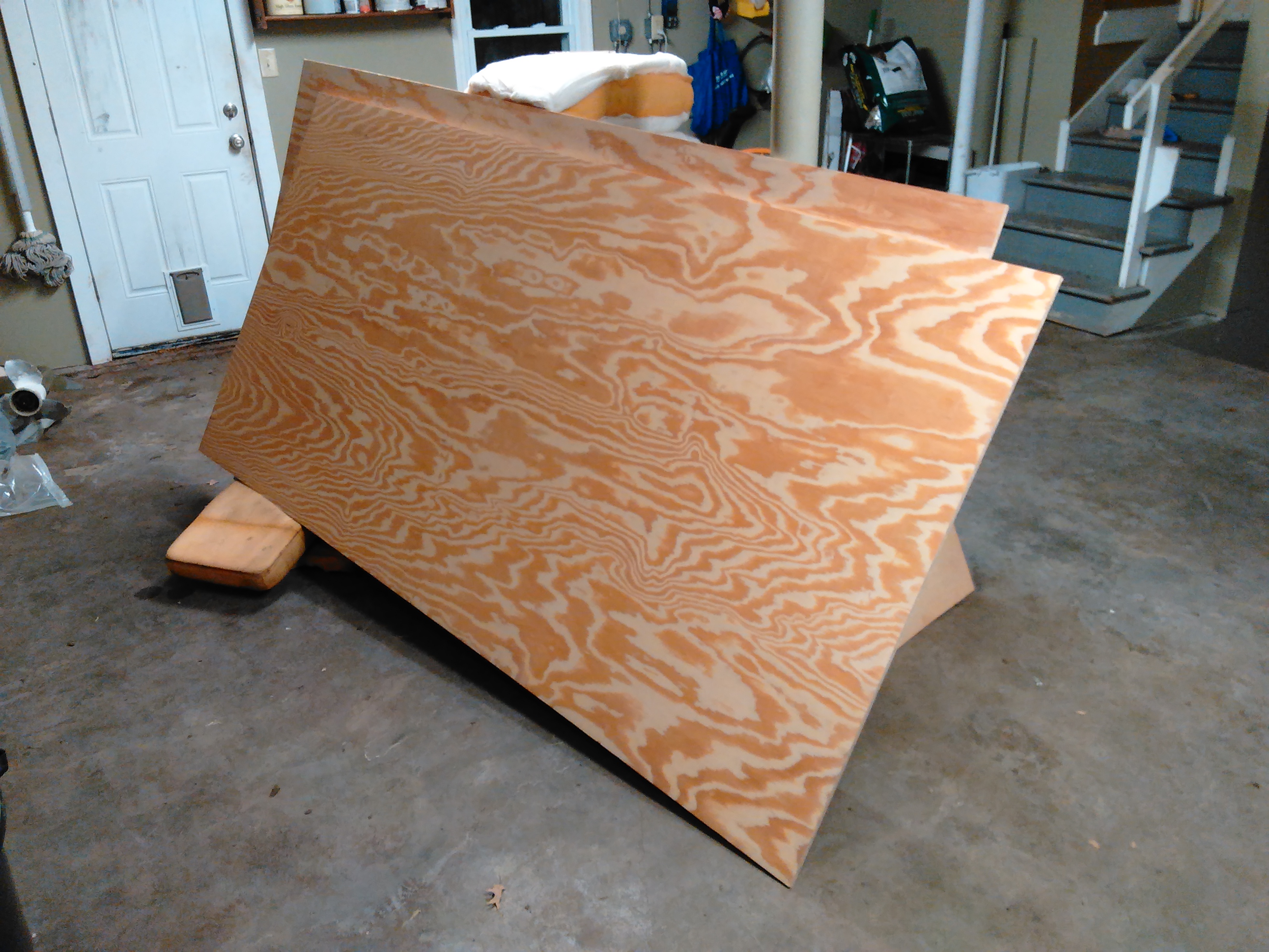

Here's the garage pile. Can't wait to see the stain on that wood. Grain pattern matches the floor vinyl really well.

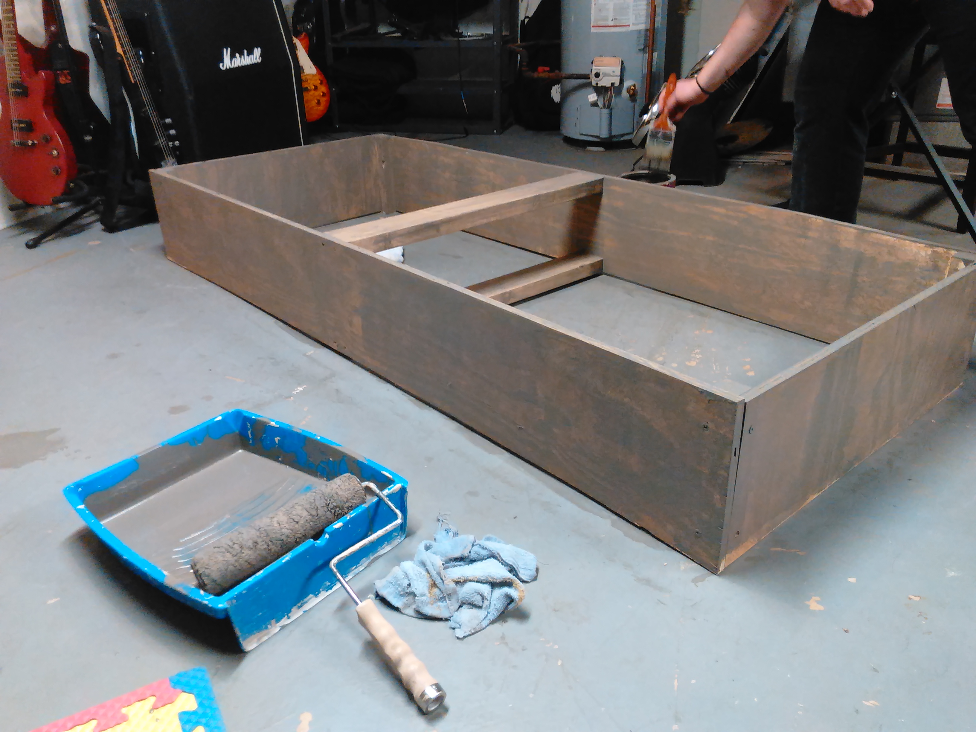

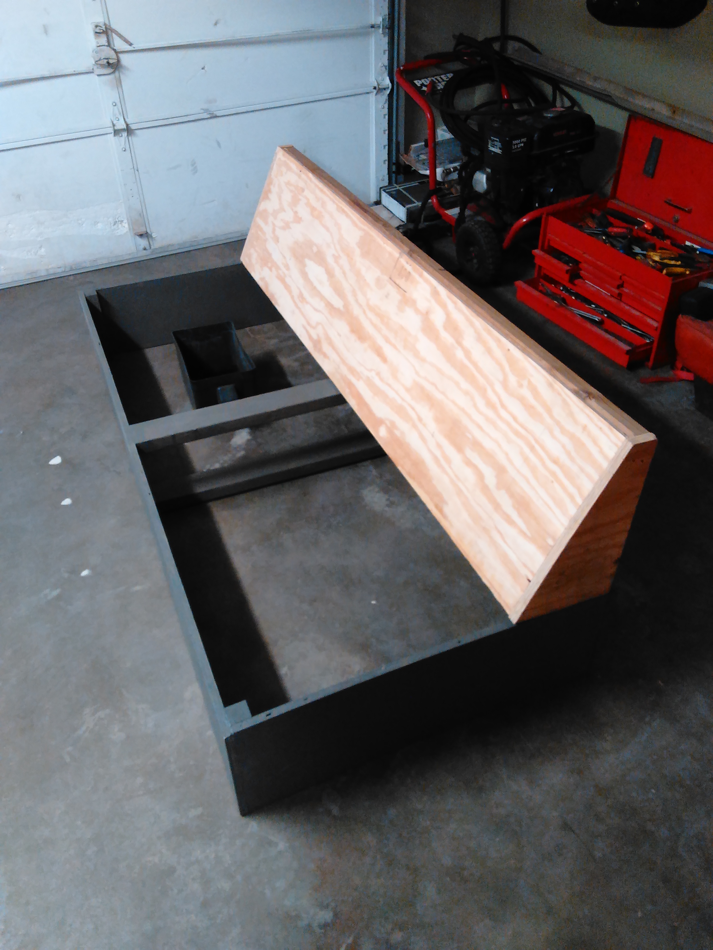

Started building the first seat base last night! This one is for the back bench. It's going to need 3-4 more coats of sealant, because it had really soaked it up when I checked this morning, but we have 2 gallons, so that will be plenty. Kasey made a mockup of how they will look once they're done.

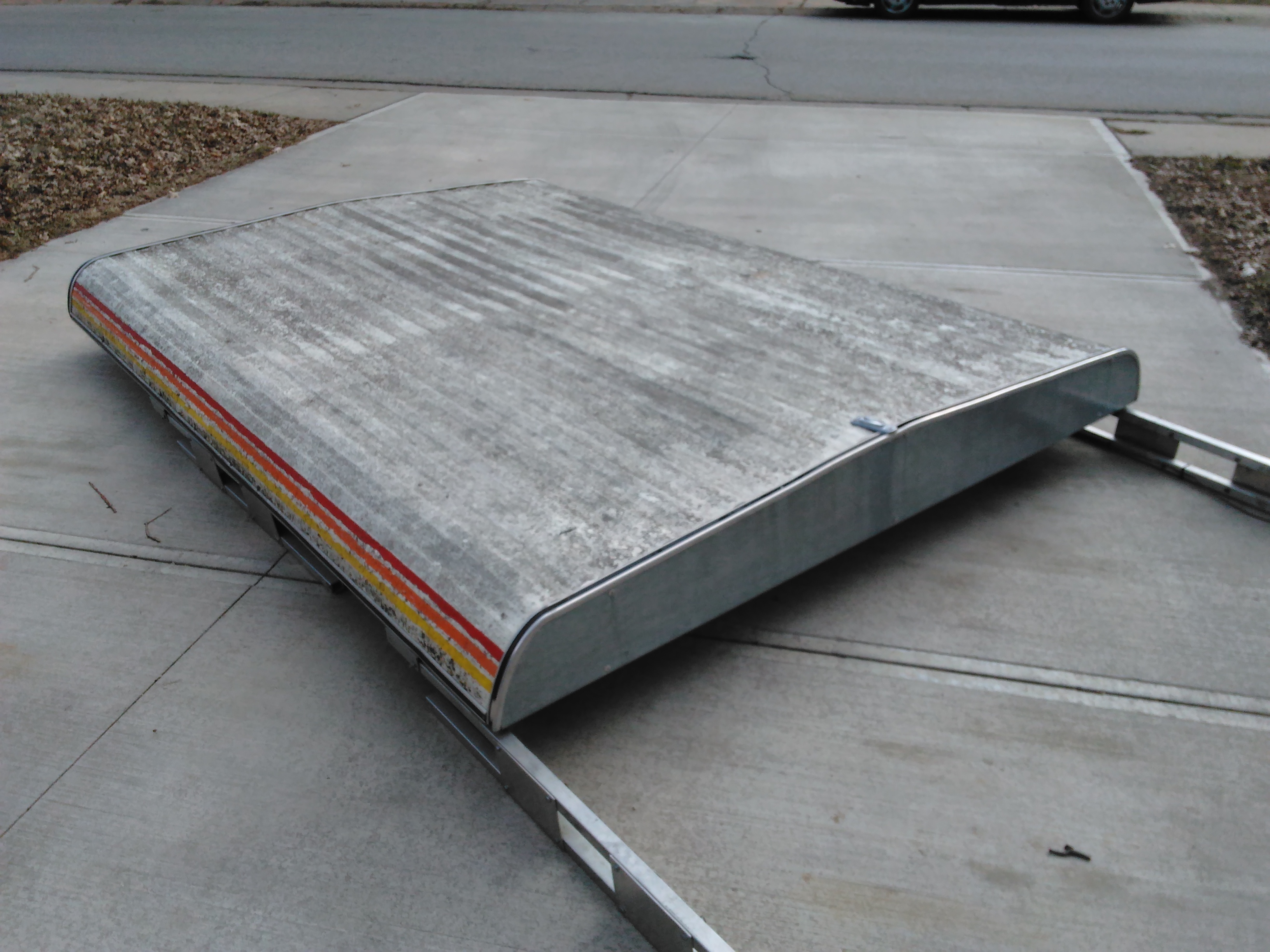

- Top off
- 6.jpg (1.5 MiB) Viewed 21408 times

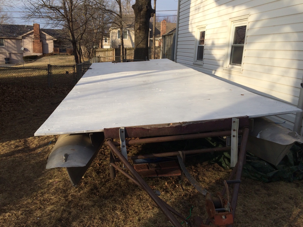

Deck is cleaned and sealed, ready for the new vinyl.
