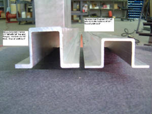

I bought some from Fire and Marine , Mr. Jeffrey Collier, Owner ph 937 332 6818
he will cut you any length you need and at the time he had two sizes.
Not cheap but great people and will help you out.

Well I finally decided on going with the typical plywood floor, so I will be using the heavy duty hat channels from fire and marine. They are also fabricating 3 custom pontoons for me. So I no longer need to find 8.5 ft std duty hat channels.
I was thinking about using the std duty hat channels if I decided to do an aluminum floor. The aluminum floor would require more cross members and therefore the HD channel would be not needed. If I went forward with the aluminum floor, I was planning on doing crossmembers 8" off center since aluminum isn't very stiff. With the plywood floor I will be doing the cross members 24" off center.

Great that worked for you! Check with F & M you might need a little extra strength at the stern for Motor support. An extra cross member or two would be nice.

I will do what ever they recommend. I am getting everything from them from the floor down. So they will supply how ever many cross members they recommend for a 22 ft pontoon boat.
