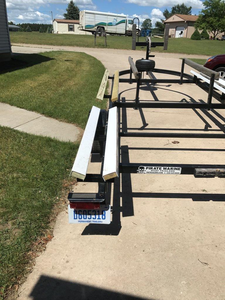

So the trailer needed new bunk rails. Looked at all the options but replacing the pressure treated wood with new wood was the most economical, except I wanted something besides carpet. So I tried something I haven't seen on the site. The wife was cleaning out behind the shed....and took out all my extra stuff and said it's time to go. (the stuff, not me, at least not yet).

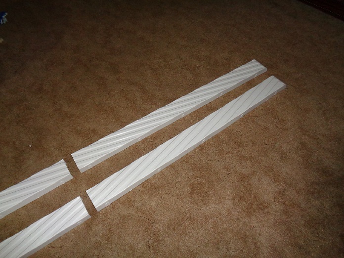

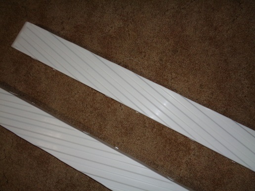

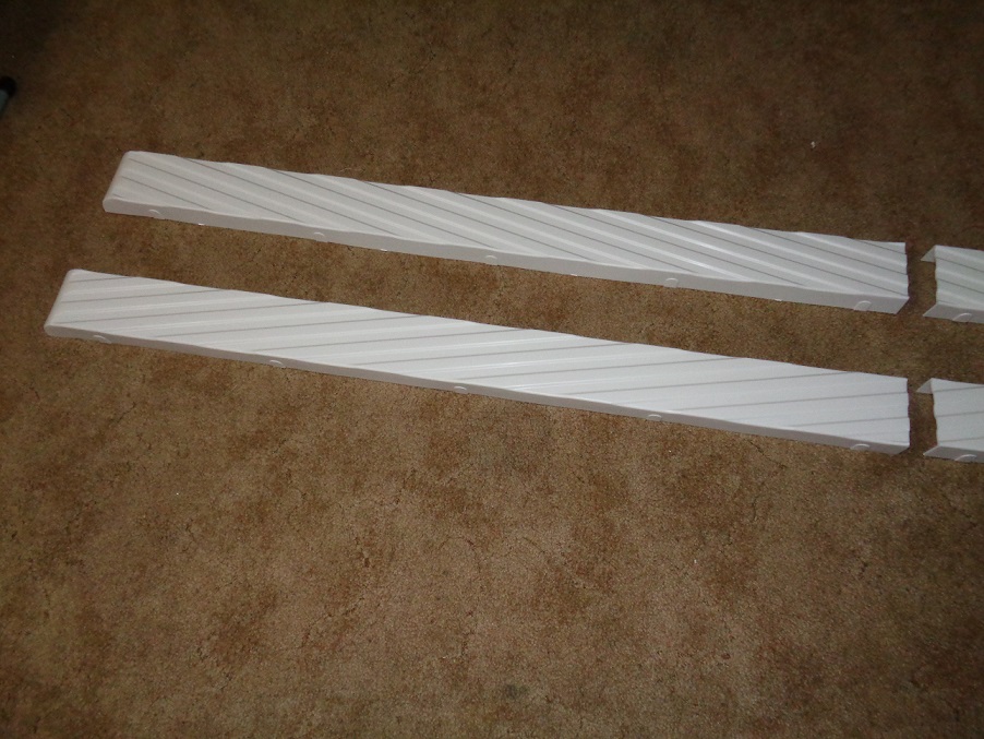

I had an extra vinyl post jacket from when I build a pergola, and realized a 4x4 was the same width as the 2x4 bunk rails. So I cut the post jacket in half, then bought a second one and did the same. So I ended up with 4 pieces, 100" long, that fit right over the bunk rails. I haven't put the boat on it yet, that will come this weekend. But I would think it would slide on and off easier and not hold in the water like carpet. But I guess we'll see. I countersunk the bolts through the 2x4's to the frame, set the vinyl post on top, and used some stainless sheet metal screws in the sides. (for some reason, I started thinking that using stainless in pressure treated wood caused some kind of corrosion, but haven't check if it's true or why) It looks good, but I guess we'll see. It was definately cheaper than any of the other covers or sliders I've seen. The vinyl was $24 per post, and that got me 2 pieces. In my case, I needed 3 posts. Plus the wood, screws and bolts, I was under $100 for it all, but I had one post already.

I am about to do mine, and the carpet alone is 120 dollars, I like your idea, I dont see why it would not work better than carpet,Tim

Looks great. Let us know how it works for you.
FYI - Looks like stainless will be okay. Here is a very informative web site.

+1 redid mine very much like yours a few years ago myself, and as of now it's worked out perfectly.

Loaded the boat up today. I purposely didn't go as far into the water as I normally do, the front of the bunks were out of the water a little just to see what happened. I basically took the rope tied to the cleat and pulled it right up on the bunks. It slide right up like nothing. I was lining it up and the wife was laying on the front to hook up the crank line and I figured she would have to crank to pull it up, but I kept pulling, not very hard at all and it just slide right up there. Very happy with it. Highly recommend....well, as long as it holds up, but not sure why it wouldn't.
