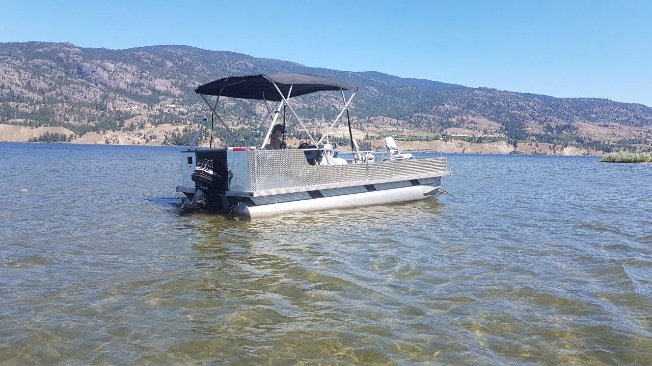

AND NEW BIMINI TOP COVER

Wow totally different look! What thickness is the diamond plate?

14 GAUGE. IT WAS PERFECT FOR BENDING AROUND THE CORNERS. THERE IS THINNER STUFF TO USE ALSO, COMES IN DIFFERENT COLORS. https://youtu.be/gSShciL-aK0

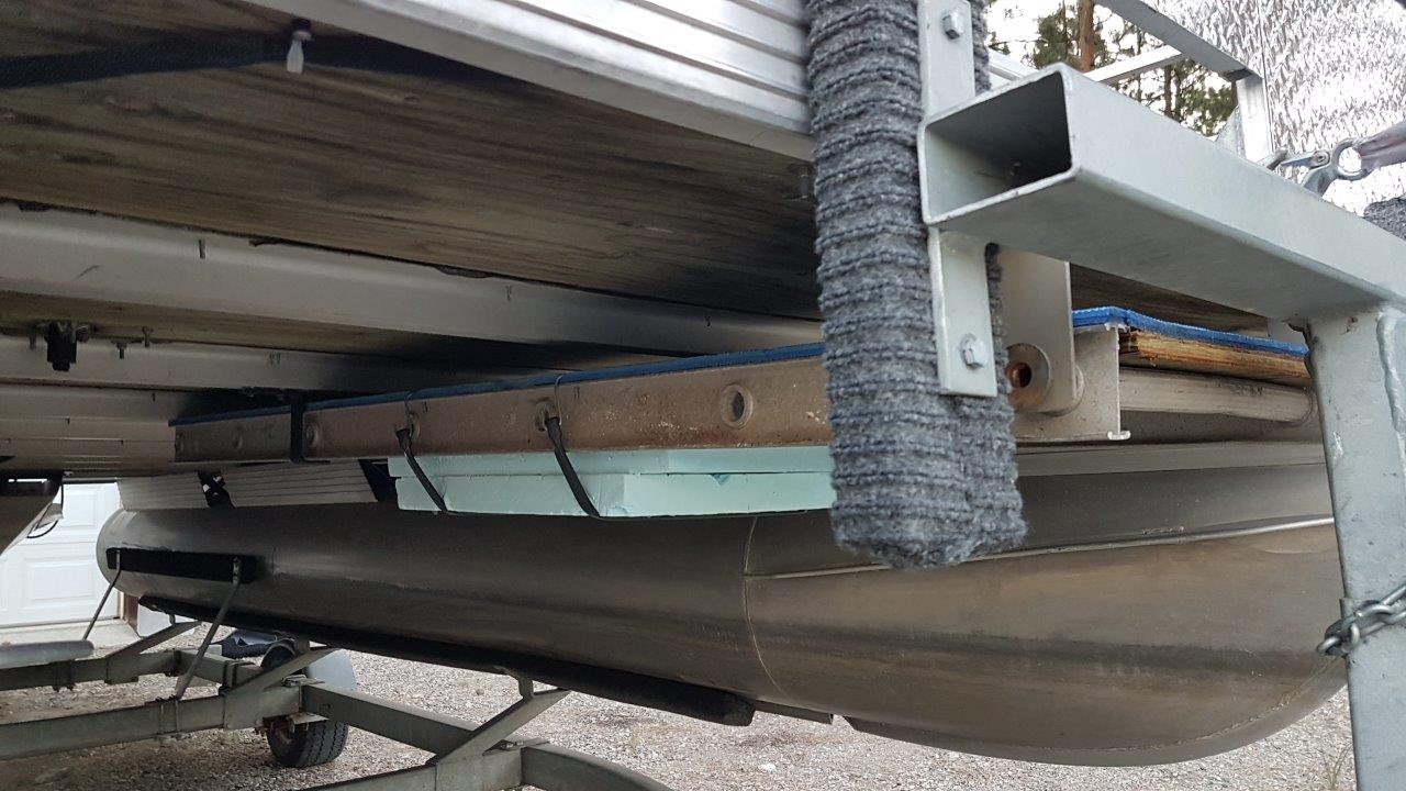

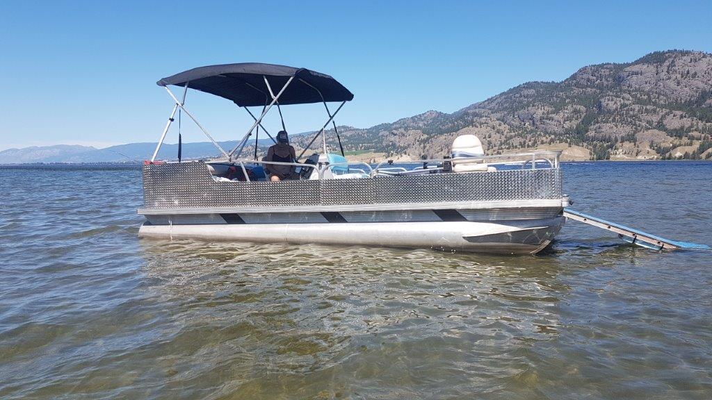

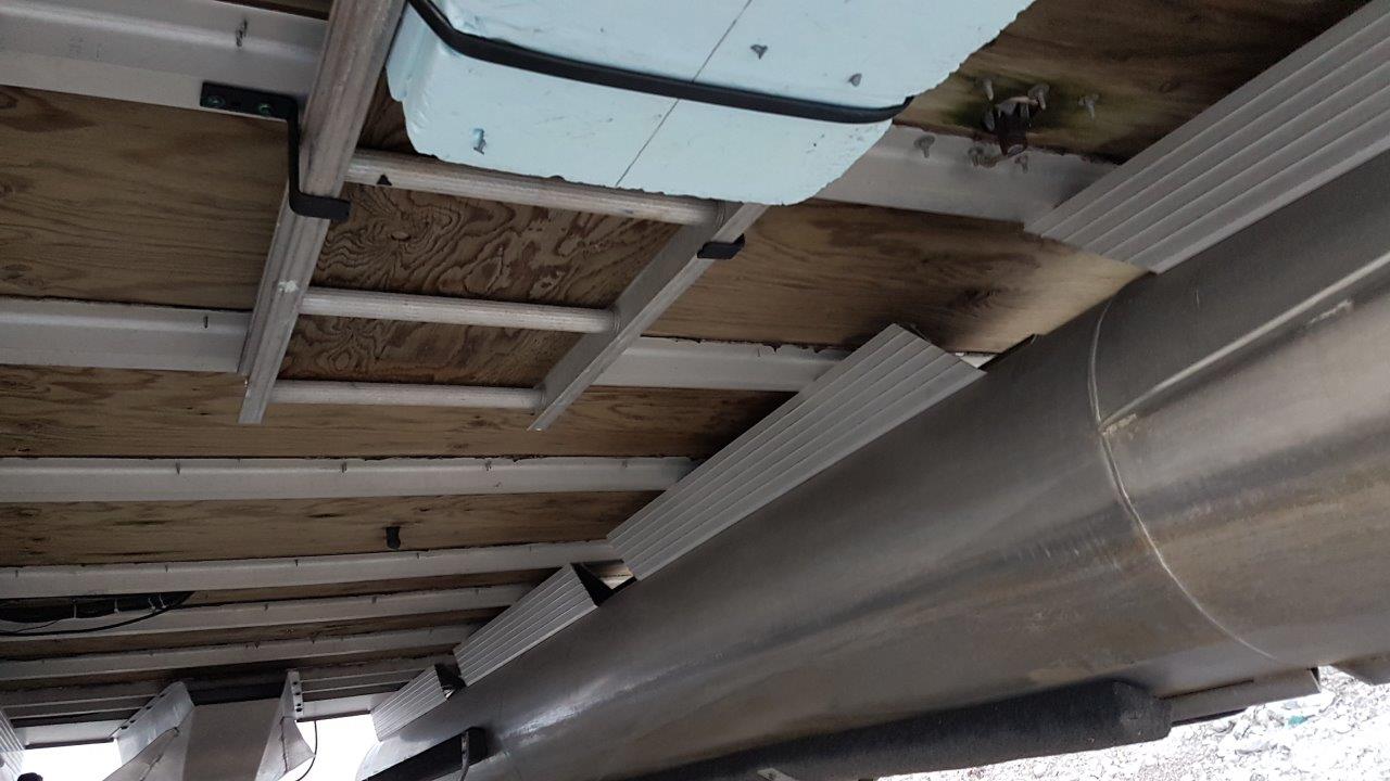

Just noticed boarding ladder, any more pics? Just covered a 8ft ladder? Attached with quick pins?

works pretty good. for the doberman, mostly. still would like to fine tune it. didn't like any of the doggie ladders they had for sale. https://youtu.be/AuV7wuR8zBg

should have explained it better. in the front ... 2 brackets with holes. a small diameter piece of pipe with a washer welded on one end of the pipe, slides through the ladder hole and a pin on the other side to keep it in place. to use it... pull the pipe out and pull the ladder forward off the back L shaped brackets and slide the pipe back in the back off the ladder. treated plywood screwed on top of the ladder with material of your choosing.. carpet, camping/ yoga mat spray glued on top of plywood. it's 6.5 feet. 7-8 would be better.
