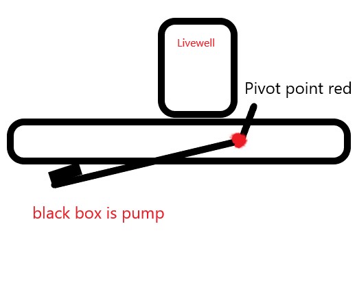

Now if you want exchange water while stopped and fishing, a tube drop straight down would work.
Maybe a simple 4 ft pc of 1/4x1 metal with a hose and screen that can pivot into the water , so say 3ft under boat 1ft thru floor.
Make the part above deck with an angle in it so when metal/hose/screen etc is flat against bottom of boat handle still sticks up to grab it?
If you need ms paint I can do tomorrow at work on a computer
water pump.jpg (20.07 KiB) Viewed 203311 times
make the pivot at the level of the deck

bansil wrote:
Wed Feb 19, 2020 5:11 pm
water pump.jpg make the pivot at the level of the deck
I've thought about something like this in a couple different ways, one just use square tubing but angle it towards the front of the boat, of course it would only fill when moving forwards ( and you'd have to use a raised inlet tube to keep if from draining the livewell) or two, and much more complicated...also assuming I add a third pontoon, build a pump mount inside the middle log, a small area that would be under the waterline and plumb it up through the log to the livewell....but that's just not feasible really, to many concerns on several levels.
I am designing a livewell box for my boat that will more than likely take water from the rear of a pontoon, will filter said water and also be able to recirculate, aerate and constantly filter, much like my bait tank, but its all just an idea at the moment.
