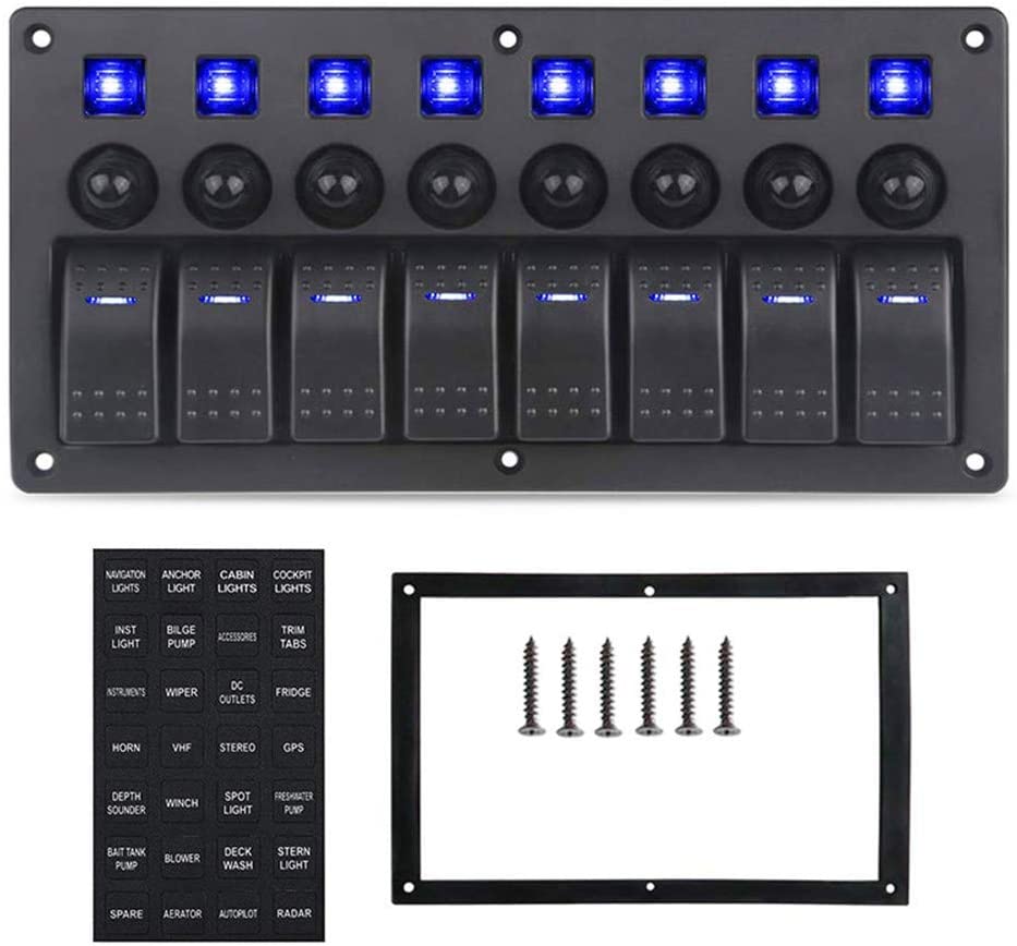

#11 Post by onlybillhere » Tue Sep 01, 2020 10:25 am
I used this panel for my setup:
I have the buss bars inside the helm then wires running from them to the switches then out to whatever. they have circuit breakers so no fuses to replace. I use one switch as my main on/off for all electronics (i have a 80 amp relay that disconnects the main power from the battery). the other switches are for docking lights, nav/anchor lights, etc... it works well and again, no fuses to deal with. I have seen panels that just have the circuit breaker on/off switch and a light, more basic but does the same thing. Just make sure whatever you are connecting the breaker is the right amperage for it.
