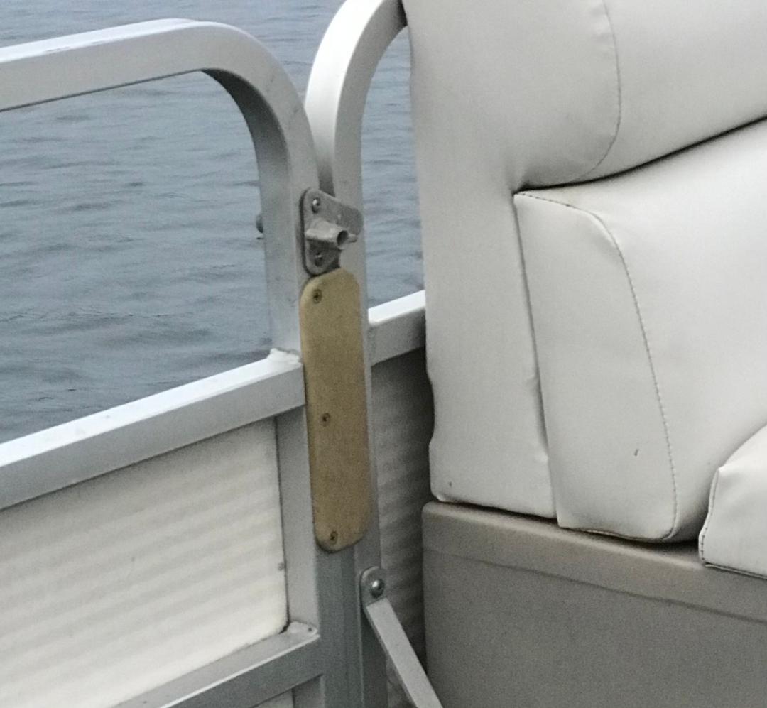

Hi y'all. I've got a 2003 SunChaser. I need to replace the "door stops" (or whatever they're called). They're the flat kind that are mounted on the door just under the

I can't tell what they are made of but it looks like those would be pretty simple to fabricate yourself for almost nothing. If it's plastic, just buy a couple cheap thin cutting boards at the dollar store and cut them to size and drill the holes and screw countersinks

Thanks for the idea. I think that may work just fine. They're made of a hard plastic and are getting brittle and discolored. I haven't found anything like them on any website that sells pontoon boat parts.

Yup cutting boards or scrap aluminium, don't reuse holes, easier to put new holes you can just match drill. No guessing :wink:
