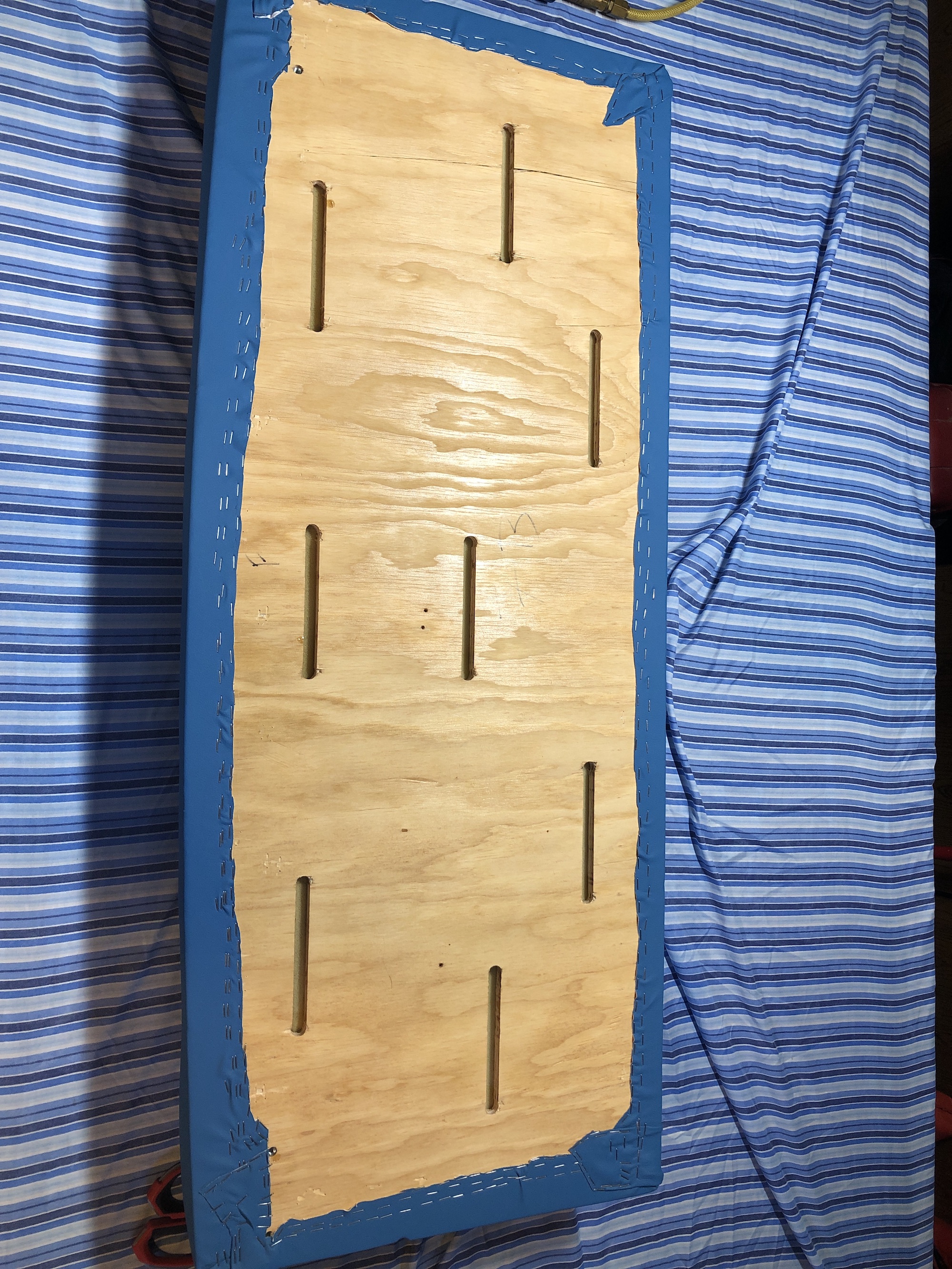

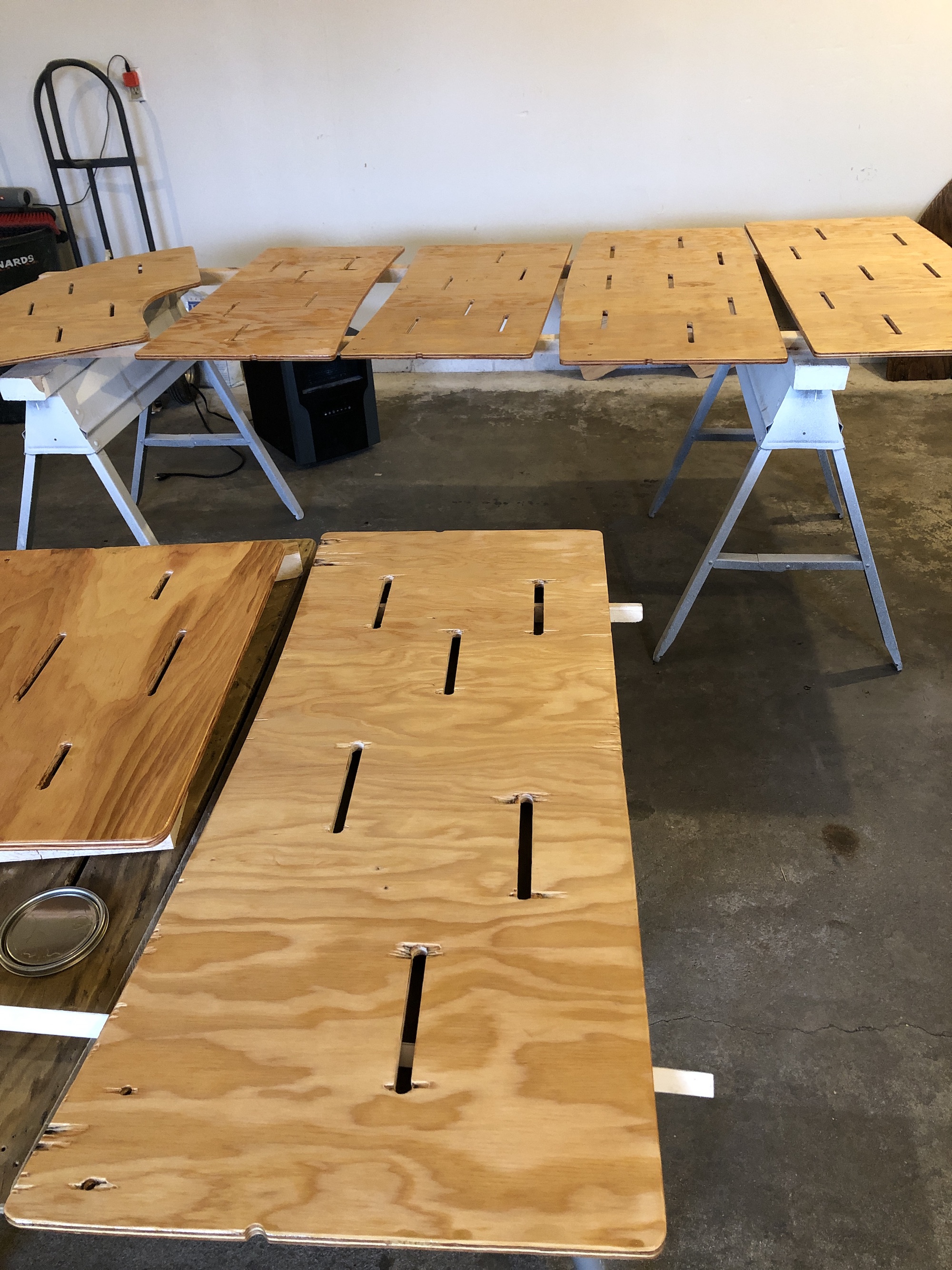

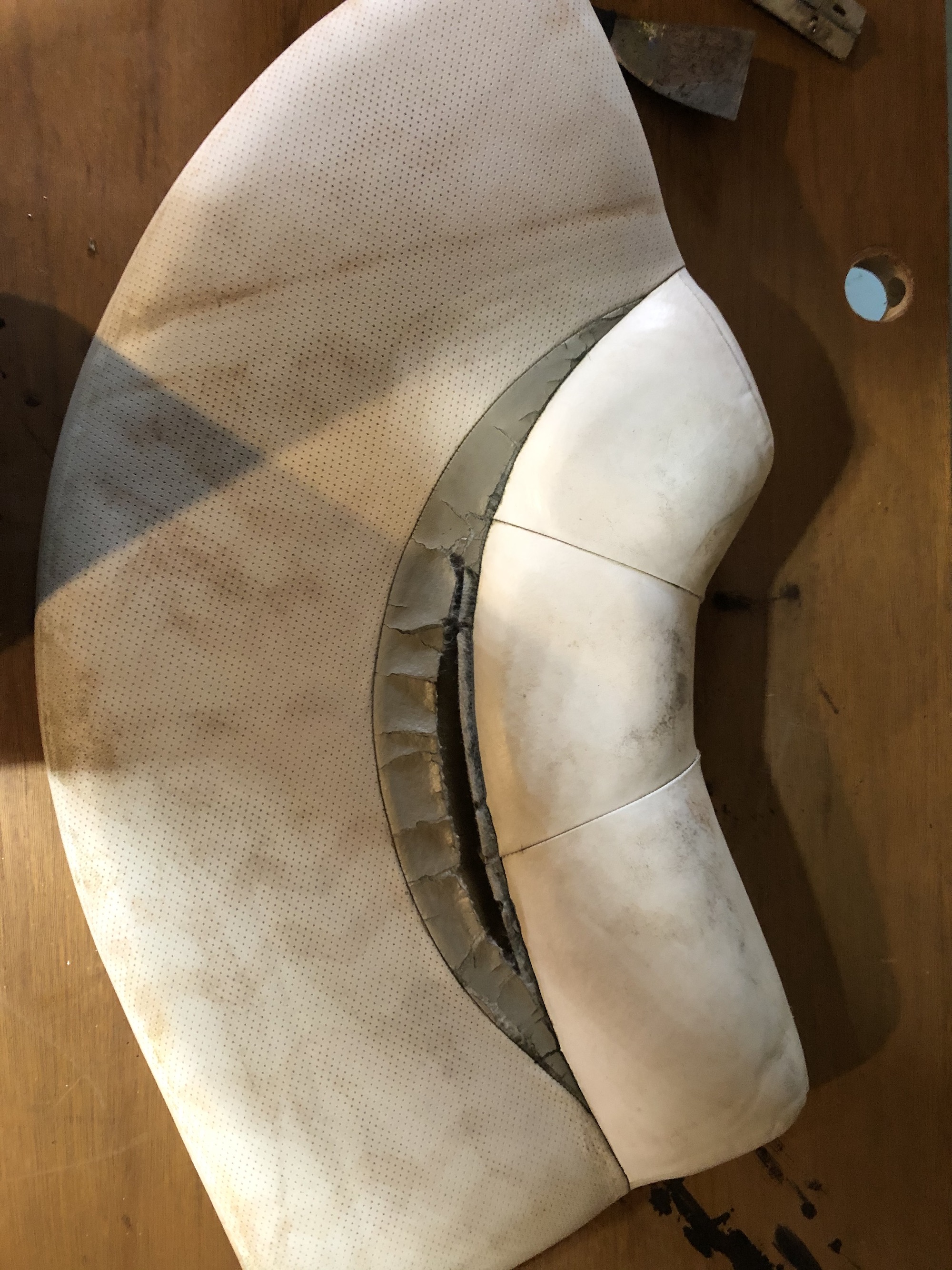

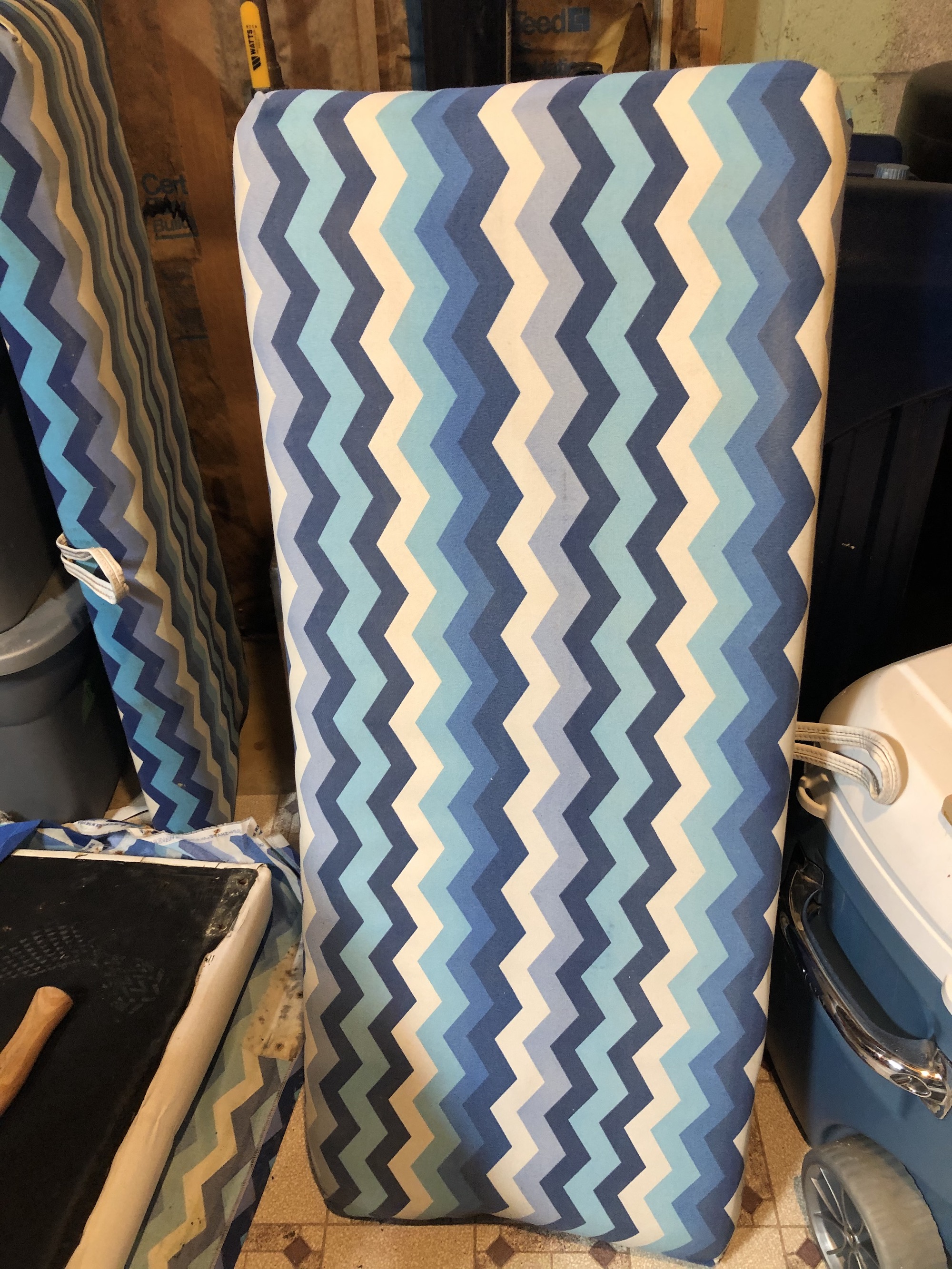

Found a few from last winter when I re-did my bench cushions. They had put some canvas over the seats that were in bad shape. None of it was in good shape really. Even that was after I power washed it all and got all the black and green off the canvas. We bought it in the fall so used it for a couple weeks before storing it for winter. Took the seats off then and worked on them over the winter.
I used the old benches as a template and cut new ones with a router from some marine plywood and tossed the old. one was shot, the rest were fine but Tnuts were obviously not stainless and rusted out. removing them chewed up parts of he seat so i just cut all new.
I cleaned the foam, soaked in vinager baking soda etc and re-used. the old seats had more sewing and things in which I did not want to attempt. I used some 1 inch marine foam over the old stuff to "even" out the seats before putting fabric over it. I ended up using a 100% silicone fabric called Sileather. Fantastic stuff IMO that I found just searching around one on the internet one day. sounded decent and I already knew what vinyl was like so I thought what the heck, let's try it. The color does get hot sitting in the sun of course, but once you start moving it's pretty tolerable and feels nice and soft. can use regular cleaners on it but we just use what we used for vinyl anyway.
I have a few other pics, but it's all about the same. I'll get more when I attempt the rest, hopefully sooner rather than later.

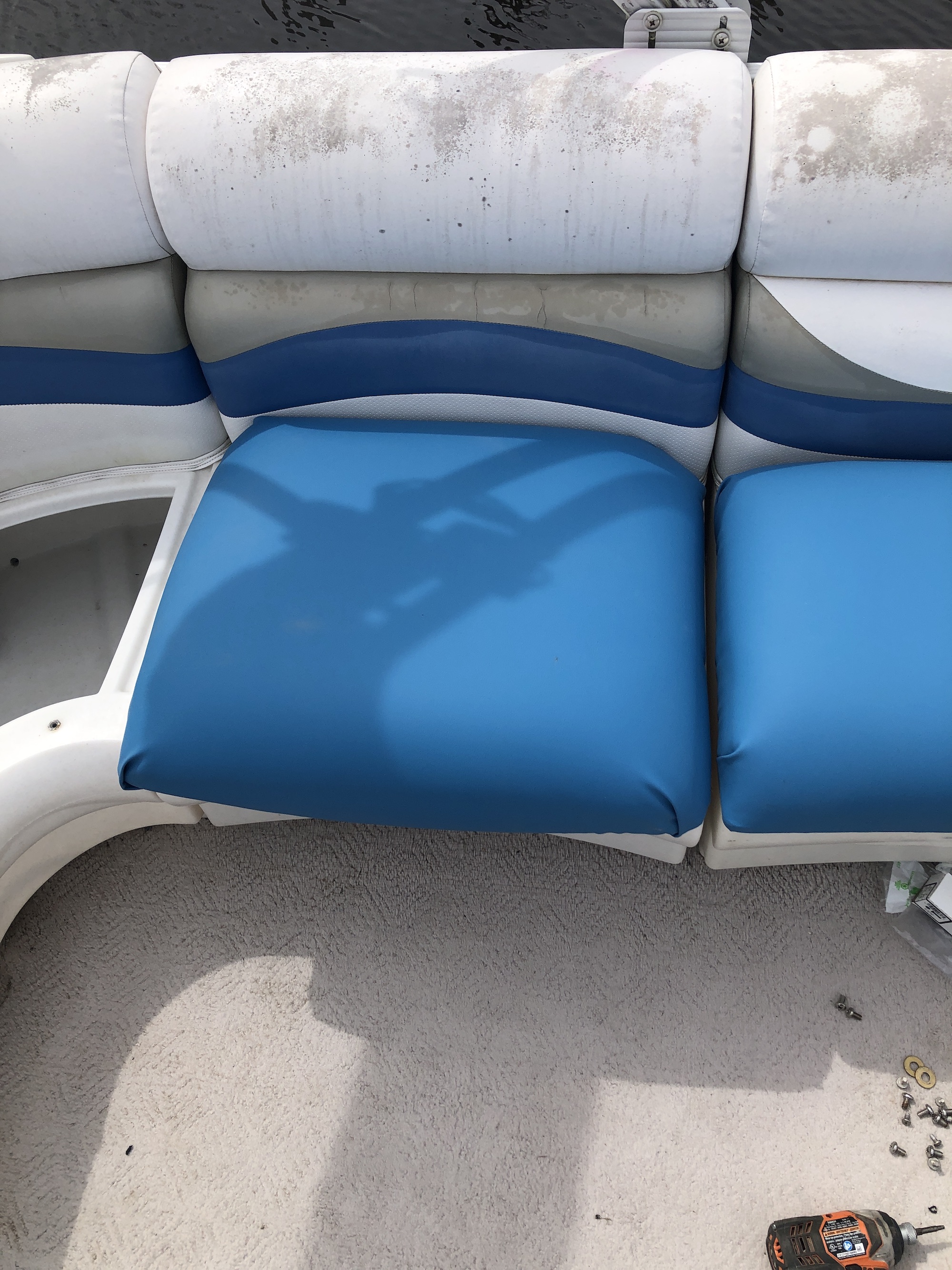

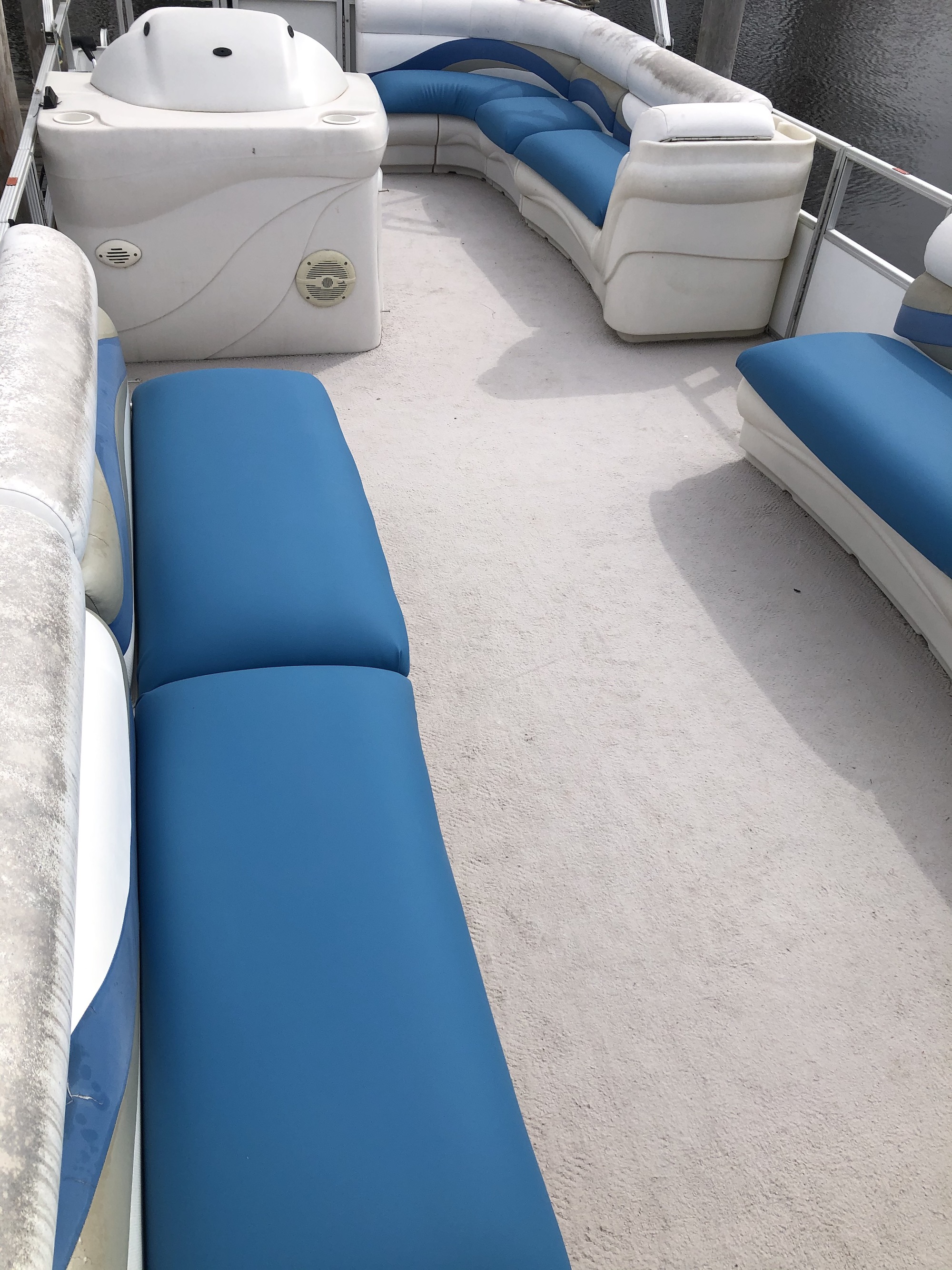

Don't know what you may have tried on your seat backs, BUT we used a product called Marine 31. The results were amazing. If you're interested, the thread is here: http://pontoonforums.com/viewtopic.php?f=16&t=25263
There are some "Be carefuls" that go with this stuff, but it ate all of the black mildew and mold right off. (IF you check it out, I encourage you to read post #1 and #9. That's the pertinent info.)

WOW, I wouldn't have believed the change if I didn't see it on those seats. not sure what we did LOL. They were really bad when we bought it. Magic Eraser I know and some marine vinyl specific cleaner, but I forget which one off hand. The seats further up front have more cracking in them so I was looking at this silicone and paint fix and then just making the seats gray and white.
This is the method https://www.youtube.com/watch?v=rq2k9HwjSpY
It's not a permanent fix, but enough to get the starter boat thru a few more years.
