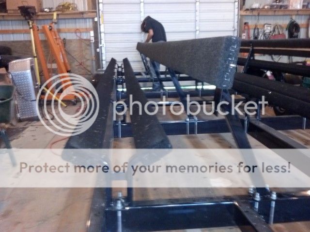

Update: I ordered 6 additional uprights and am proceeding as planned. Take a couple of weeks to finish I suppose, but hopefully my Rock addled brain remembers to post the finished shots here.

#15 Post by tuned » Thu Sep 05, 2013 11:19 pm
Just catching up on some threads. I notice that a lot of people are still interested in guide systems.
As planned, I put the long wooden bunk guides on. Tried em out the other day when I wanted to do some power washing.
Although I need to adjust width slightly, they worked PERFECTLY. The front of the boat straddled the rails while the rear of the rails were still several feet under water. As I pulled out, the guides gradually centered the boat. I even tried it a second time with my helper pulling on the stern to simulate a side wind. Didn't matter in the least and the boat loaded straight. Yay!
In my opine, sometimes there is no substitute for stought wood. Each one is 2x6x20. Total cost to modify existing structure--$200[URL=http://s712.photobucket.com/user/tunedu ... l.jpg.html]Image[/URL]
