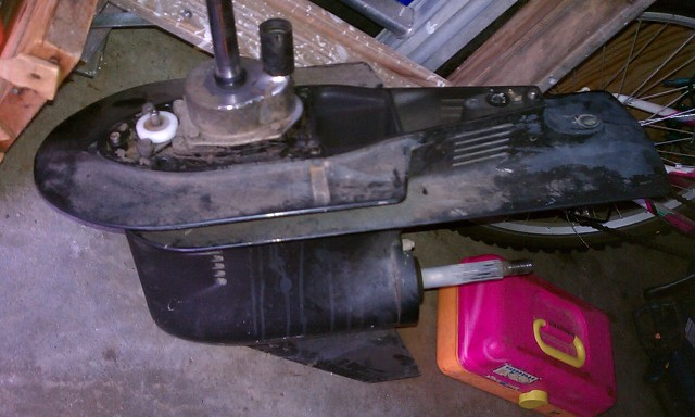

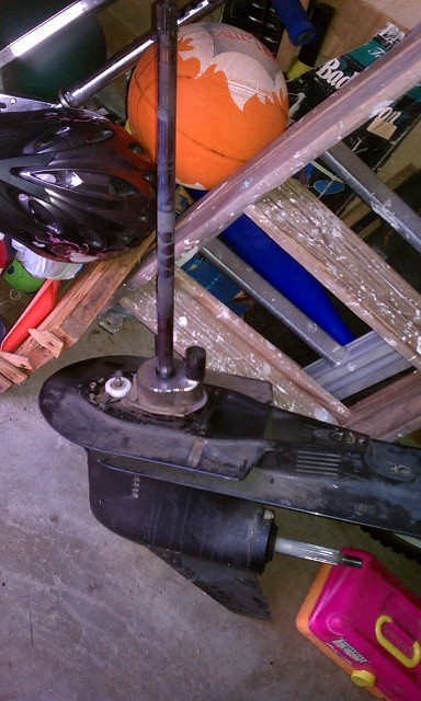

So we got the l.u. off and suprised to find out it is a short shaft....
Maybe since it is a 94 the weren't putting long ones on toons...

- IMAG0261.jpg (65.76 KiB) Viewed 4096 times
- IMAG0260.jpg (82.08 KiB) Viewed 4096 times

Mabe that means that the short unit will save you a few bucks in relpacement.

Nope all the same 845.00.
I will tell you what that sucker came off in 30 minutes. If any of you are worried about replacing impeller,. It was five nuts and almost didn't catch it when I gave it a smack.

Well don't this suck
Based on the serial number you provided, I believe your unit is the 3-jaw reverse clutch style. Ours is the upgraded 6-jaw reverse clutch and the only way you could use our lower is if you replaced the shift shaft which would require you to remove the power head. The 12 is referring to the number of teeth on the pinion gear not the splines on the driveshaft.
Thank you for contacting SEI.
