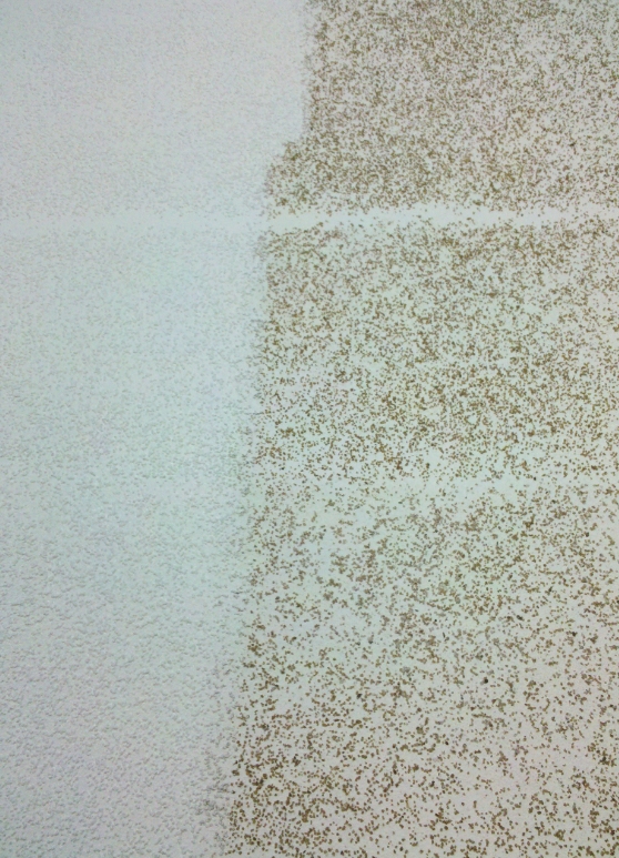

For what it's worth I applied several coats of very high quality elastomeric roof coating over raw marine plywood: top, bottom and sides. The next to the last coat included pulverized walnut shells for anti-slip. It was about $140.00 for 5 gallons versus about $50.00 for the cheap stuff. I doubt if I'll ever need to re-coat it again.
While the roof coating is not *designed* for foot traffic I'm not too concerned. It IS designed for repelling water and UV rays.
I've got several small 100% vinyl loop throw rugs to keep it cozy, and they do an excellent job of trapping sand. To clean 'em, just toss 'em in the water. :smoke
The rugs I've got have no backing to allow water to drain through: http://www.americanfloormats.com/vinyl- ... ance-mats/
toon deck coating.jpg (449.83 KiB) Viewed 9998 times

#8 Post by cleatus » Tue Feb 19, 2013 7:21 am
"For what it's worth I applied several coats of very high quality elastomeric roof coating over raw marine plywood: top, bottom and sides."
Sounds like a good alternative, how long ago did you apply it? How's it holding up?
You didn't need to prime the plywood? A friend wants to rip out his carpet, that's why I'm asking.

#9 Post by RonKMiller » Tue Feb 19, 2013 7:54 am
Looking back I paid about $150.00 for TWO 5 gallon buckets, I had it tinted to kind of a light beige color since the white was just overwhelming. No primer needed for new surfaces. My new plywood just sucked it up since it was kiln dried. I put two coats on the bottom and four on top since I started with all new sheets. It's about 50 mils thick now - about the same as a credit card. So far it's holding up just great. I've also had two coats on the roof of my house for 8 years now - with constant extremely harsh sun exposure. It is starting to "chalk" a bit, and it will need a new single coat to renew it next year. Quality stuff.
http://henry.com/roofing/coolroofcoatin ... oofcoating
http://www.homedepot.com/p/Henry-4-75-G ... SOPx_JA3FI
I would think that a previously used surface would need some serious prep - as in sanding... :donno that initial coat would need to bond tightly or it might peel over time, although they do have a *primer* that might work well:
http://henry.com/roofing/coolroofcoatin ... icbasecoat

Bamaman wrote:There are elastomeric coatings that are designed to walk on. Ames Research sells through Tru Value Hardware. They're best when embedded in a polyester roof fabric. Otherwise the seams can leak.
Yep, it looks like their granulated Safe T Deck might be an excellent choice, but at $179.00 for 5 gallons - ouch...
http://www.amesresearch.com/_Safe-T-Deck.html
One thing is for sure, I went WAY overboard on my crushed walnut shells, I could have used about 1/4 as much. I sprinkled them on top of a wet coat, let 'em dry into it, then put another top coat on. If I did it again I would just add a cup per gallon of paint and roll it on. I would also mask off adjoining areas and just coat "walkways" instead. The one big advantage of having lots of shells are that the throw rugs and coolers, etc. don't slide around on the deck so perhaps coating storage areas is a good idea too.
I did notice that my coating does seem to trap some dust and grime, but a few drops of phosphate free dishwashing liquid (Dawn is fine) and a wet rough surface broom gets it looking like new in a heartbeat.
