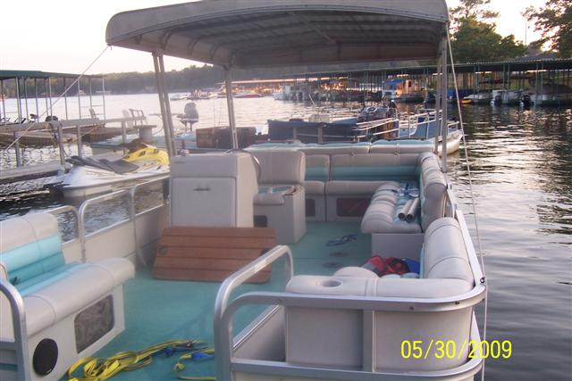

We think we found why our hard top is rocking so much. There seems to be a brace missing on the back, anyway there are some empty holes where it looks like a brace should go.
Anyone have one and know for sure?

#8 Post by Vaughn » Thu Jun 04, 2009 7:13 pm
(edit picture smaller)
pontoon ride 5-30-09 smith 044 (Small).jpg (53.01 KiB) Viewed 8105 times
Vaughn
Posts: 12
Joined: Fri May 29, 2009 5:33 am
Re: Hard top braces
#9 Post by Vaughn » Thu Jun 04, 2009 7:16 pm
oops, sorry I sent it way too big. You can take it off or resize it, not sure of how to do that either!
