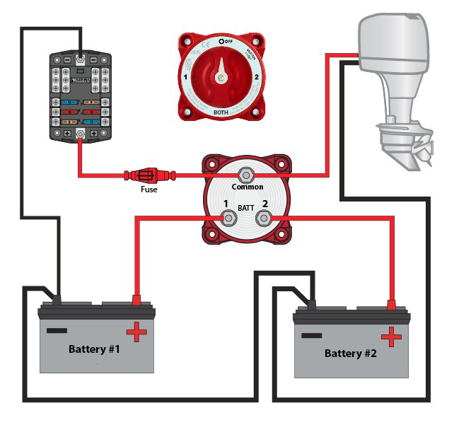

Re: Battery Switch Installation
Here ya go, try this
This will be most helpful Sully. Thanks.Capt Sully wrote:Here ya go, try this
