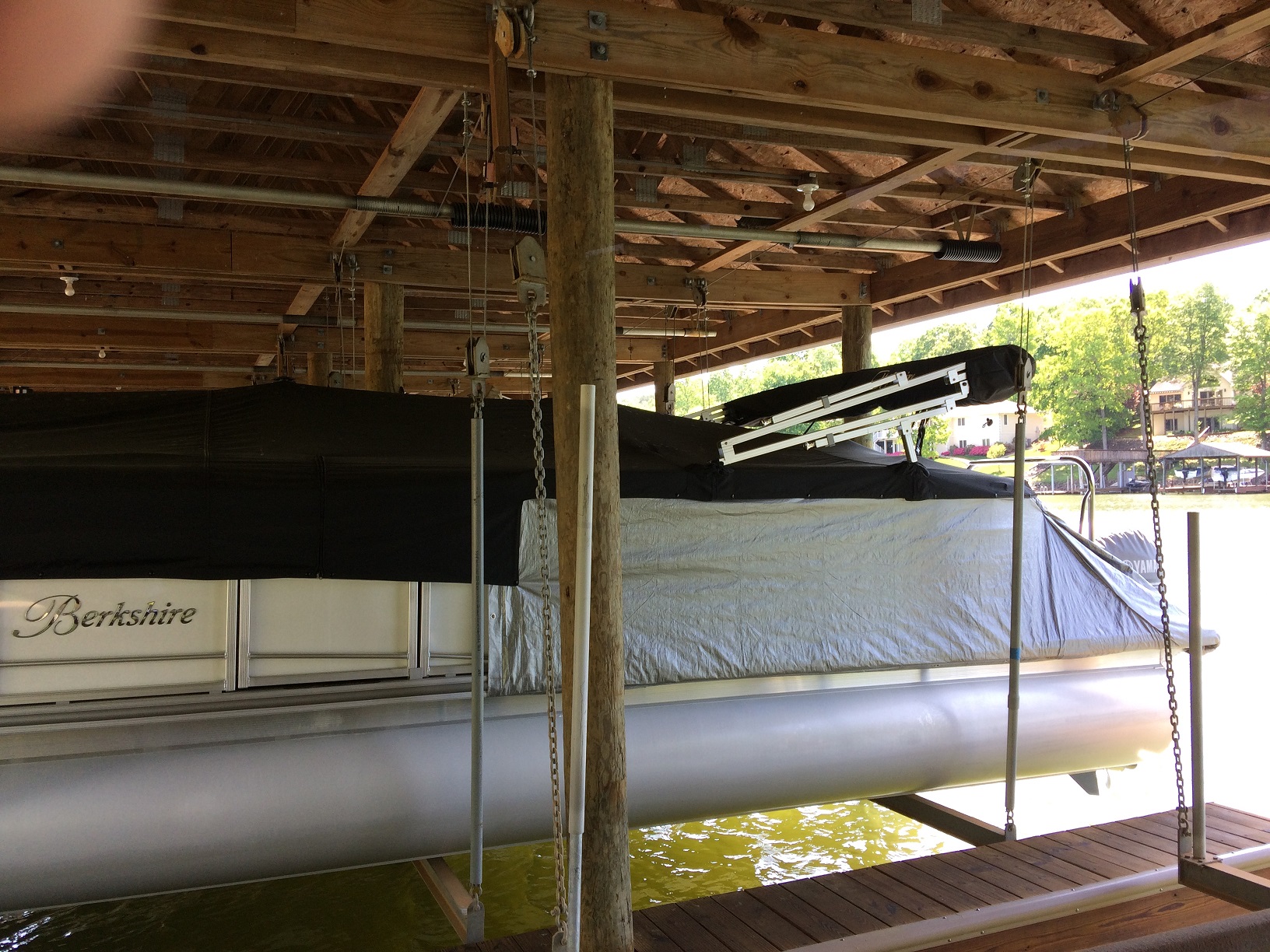

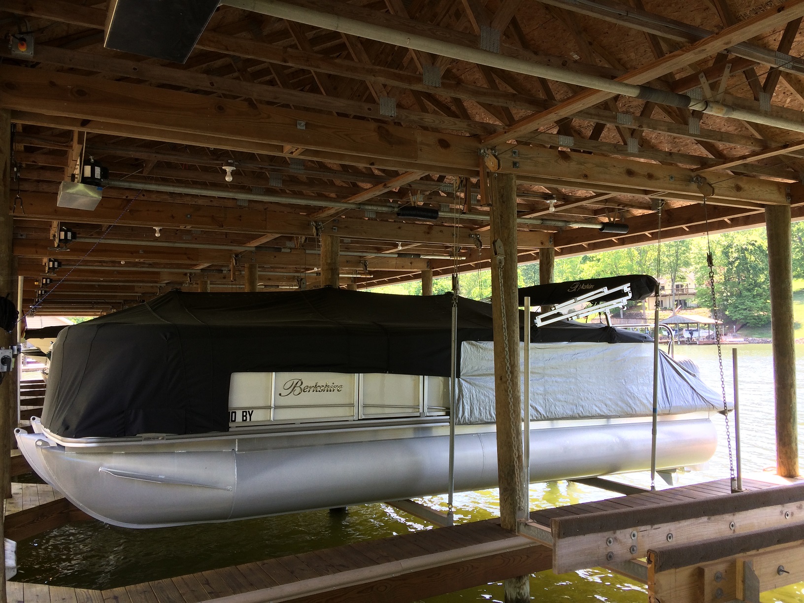

I made something similar for the stern of the boat to keep the sun from beating on the painted skins and vinyl decking on the stern that was exposed to the sun.... even though we are in a covered boat house, it still was getting the sun for much of the day.
After getting a price from a professional boat canvas company....... $800 to $900 I decided to make my own. I bought the heaviest duty, silver, UV protected tarp online that was big enough to go around the back half of the boat, stern and up the other side, all in one piece.
Here's how I make mine, and you might want to consider doing it is to make it, and snap it to your EXISTING snaps on the playpen rail. I used BACK to BACK snaps (also known as Gypsy snaps). Then your existing boat cover snaps overtop of the skirt you have made onto the Gypsy snaps. I also used "Snap Fastener Cloth, to Surface" Snaps to take the skirt under neath and have it mount to the plywood flooring overhang along the sides. At the stern where it hung over, and around the engine, I make small sandbag tubes ( inch and a half diameter X 8 or 10 inches long) and used them to hold down the back end.
I had NO sewing machine, and hand stitched in 5 different "Darts" to conform to the exact shape of the boat, including where it went over the swim ladder which folds up.
After a full winter, ALL snaps were still connected, the sandbags held down and didn't blow up onto the deck and our boat was completely clean. I takes about an extra 5 to 10 minutes to install this, BEFORE the regular boat cover goes on, but will keep our boat looking new for years to come.
TOTAL costs for the 16 ft X 20 ft tarp, special heavy sewing thread, all the snaps, gypsy snaps, and a hand tool to install = $72....... Of course my labor was FREE
I was able to buy all the hardware, and materials (except the tarp) from SAILRITE.COM Here's a link to their page with all the snaps. They also sell boat canvas materials too, but I didn't have a sewing machine and had to do with a tarp.
http://www.sailrite.com/All-Hardware/Fa ... popularity
Forgot to say.... the reason for using the tarp, was with no sewing machine, any cut edges, I burned with a hand held wood burner tool. Looks like a soldering iron, which would work too. That way, I get NO unravelled edges !!!
Hopefully, these 2 pics will attach.

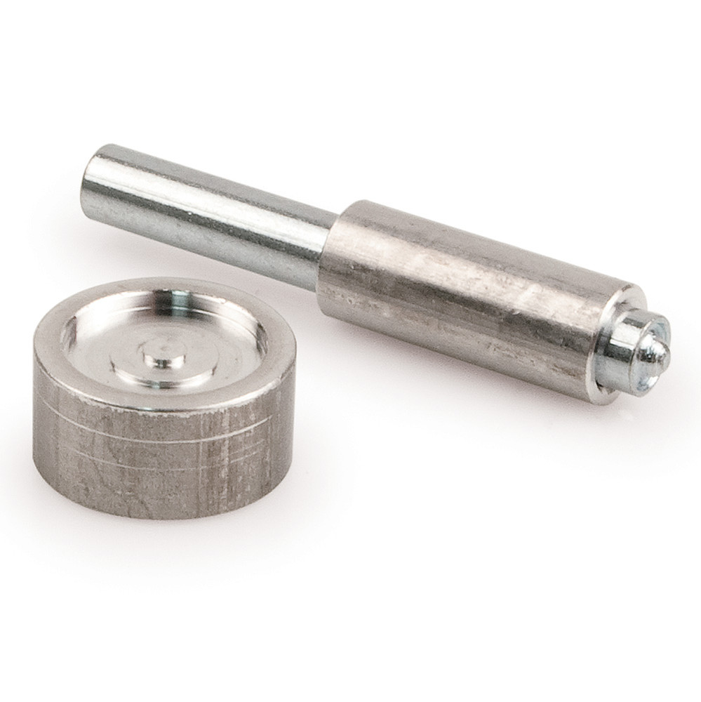

I had great success using Sailrite's $3 hand tool and set about 60 plus snaps with no issues.... just use a hammer to smack the top of the tool. As stated earlier, I put a small piece of 2 X 4 wood underneath the tool when setting the snaps.eericherak wrote:And thanks again. I've already sent an email to Sailrite inquiring about their snap installation tool. You have really helped.

Just want to add I never had enough hands to make the kind of snap tool you have to smack with a hammer work. I have much better luck with the anvils that slide on the jaws of your vice grips. I get the best results when I squeeze them tight, open the vice grips, adjust them a little tighter and squeeze again.

Nice !!!! I like it...... would have been easier than the block of wood, hand setting anvil, and a hammer !!! LOL.......... Can't believe I was able to set 60 or 70 snaps while on a foot wide finger pier down both sides of our boat, WITHOUT dropping anything overboard
