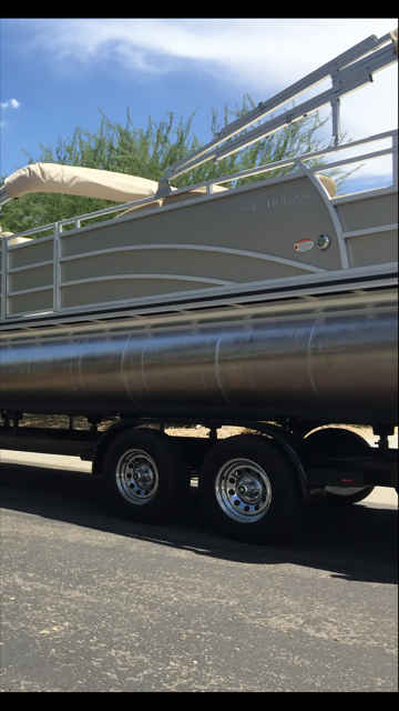

Hey guys....I know, i know. This subject has been beat to death on this forum and I'm hesitant to start another thread. However, I'm pretty desperate. My boat is a couple of years old now and the toons are starting to look pretty crappy. I dont want to spend the time or money on an acid wash, cleaning, Polish and protectant (sharkhide) "whole 9 yards" type of treatment.
Having said that, has anybody had any luck with any type of cleaner that can be sprayed on and hosed off after every few trips to the lake. I'd rather not have the dull white finish that alumibrite seems to give and don't want to worry about ruining the paint on the trailer. Just want to toons to look better and and a uniform look without all the streaking.
Has anybody had good luck with something that what I'm looking for? Am I looking for something that doesn't exist?
Any advice would be GREATLY appreciated !

I acid wash at the end of the season. To avoid streaking, start spraying at the bottom and work your way up. I do 3 or 4 feet at a time, then move over.
For any type of cleaner, apply from the bottom up, rinse from the top down.

Acid washing is only needed to get green grundge off the toons if it's been left in the water. Otherwise, your only option is polishing the toons. I use White Diamond metal polish and a wool bonnet on my Porter Cable dual action sander/polisher.
I can polish the outside two toons, 3 nosecones and the rear end of the boat in 90 minutes or so. It's not that hard of work, really. Since the inside of the toons is not seen, I don't polish them.
Getting the black aluminum oxide off the toons in order to Sharkhide them (with lacquer cleaner) is murder. There is so much welding slag and so many cracks that the black gets into. It's just easier to polish it every May.
That's my 5/24 job--along with changing the lower unit grease and changing the motor oil.
