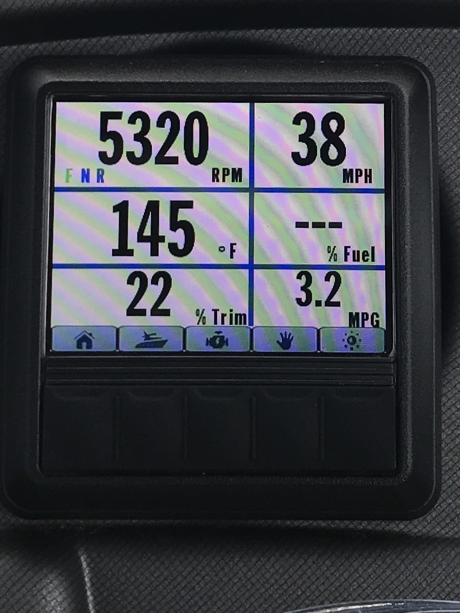

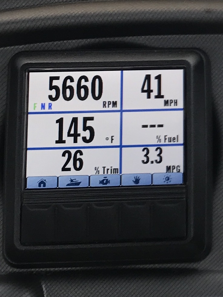

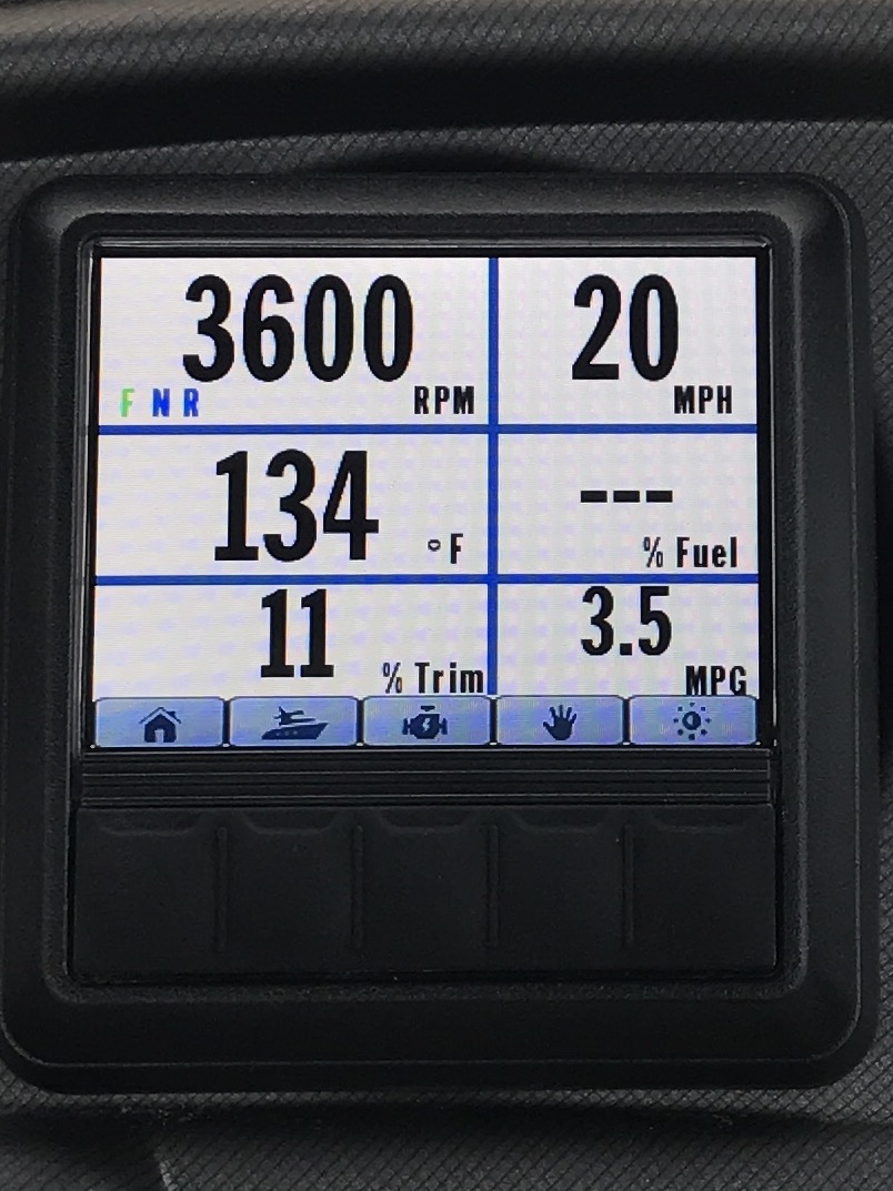

Here is mine with a 19 pitch viper. Its on the bottom hole. I might move it up one hole. Anything over 4000 rpms I get 3 mpg or better. WOT is almost as good as midrange MPG. The faster I go the better the MPG. Its only burns around 12.5 GPH at WOT.
The Merc and Yamaha 150 4 strokes burn 16 GPH at 5800 Merc to 6000 RPMS on the Yamaha. But most of the Toons only get 5400 to 5600 rpms so its more around 14 or so GPH at WOT.
The Evinrude G2 should be propped between 5600 and 5700. I'm right on those numbers.
This was 3 people, 35 gallons of fuel, all the normal stuff and gear and top up. Top doesn't really change the speed like I thought it would.
