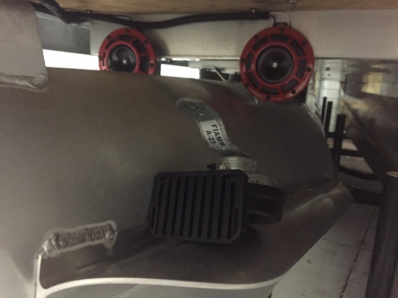

I just installed this high/low Hella set of horns. I was tired of the meep-meep of the stock horn. I only use the horn in an emergency, so the weak horn was useless. This pair sounds like a freight train, especially reverberating off the log and underskinning. My wife was coming up the rear ladder and I thought I'd give these a try up front, scared her so much she fell back into the water. (I only get to do that once apparently)
Cost me $32 on Amazon and a few lengths of scrap wire and connectors.
If you want my old horn (pictured in the foreground), I think I still have it and will send it to you for the shipping cost.
https://www.amazon.com/HELLA-003399801- ... B000CRZXPI
