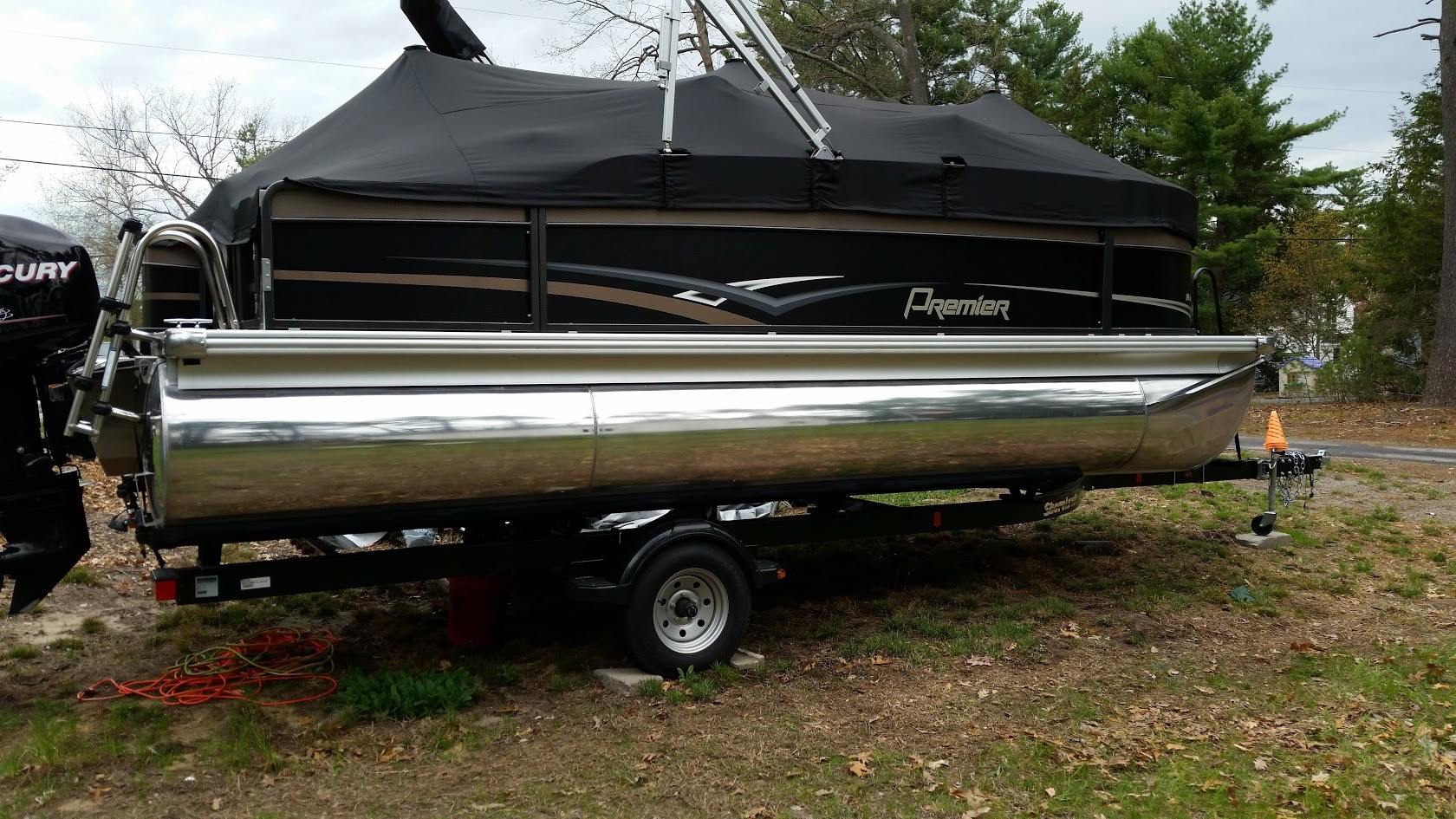

I use Mother's Aluminum Cleaner
- 18155988_10212932439485128_2680536585050113813_o.jpg (284.08 KiB) Viewed 11407 times
