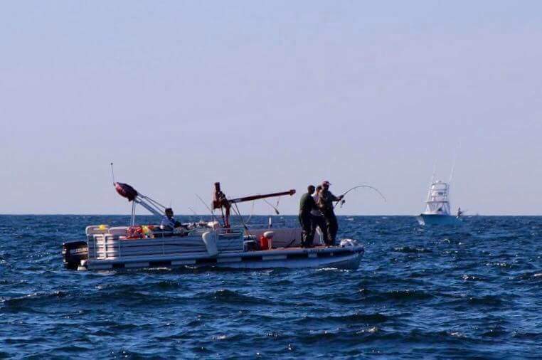

I have a 25ft sanpan with a 150 suzuki. I use the boat for my oyster grant and also to commercial fish. I have the front stripped and have a small electric crane mounted midship. I get decent speed after the repower but looking to get the bow up more and make it a dryer ride and hopefully a little better in rough weather. I looked at the water glide but all the people seem to say in rough water they r not good.
I was wondering if any one have added a Avalon express tube in front of their motor pod.??
