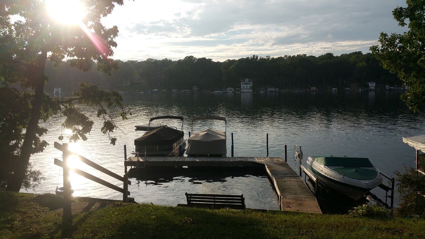

Second year on out SE Wisconsin lake. Our house is across the street from the water, but me and 3 others own a lot on the lake with a small dock we share. I'ts practically across the street from me so it's quite a good compromise. The dock we share has 3 pontoons and 1 ski boat.The toons all have to load from the front. It's ok but I really hate putting the big cover on every night(or almost everynight). I would really like a lift with a awning so at the end of the day, up it goes!
Most of the lifts I see you operate from the side where you board. Do they make one I can operate from the front? In the picture below, my boat goes int he empty spot. I have a 2008 Sweetwater 2386re with 115hp Yamaha. What weight or size lift would it need? If I traded for a similar sized tri toon would that also work?

Most passengers get into boats on cantilever lifts are from the side. Unfortunately you are in the far north where docks and lifts have to be pulled from the water prior to winter. A 4000 to 5000 pound lift would be preferred.

I have only seen lifts with the winch on the side, but if you spend extra for an electric motor and a remote, you should be able to board from the bow.

We love being able to have our boat on a lift inside our boat dock. Hydrohoist makes a front-mounted lift, if you can get power down to your dock. https://www.boatlift.com/product/ultral ... ont-mount/
