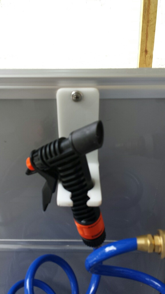

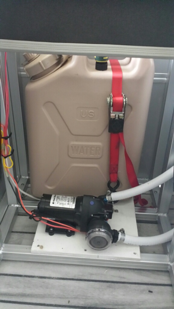

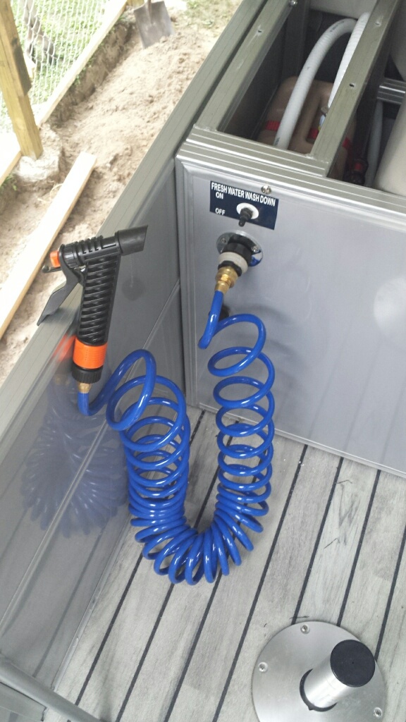

I've now done this to 2 Tritoons, mine and a friend's. If you do it right and get a good washdown pump mine is west marine, 5 GPM @ about 40PSI you will be happy with the results, bilge pumps and livewell pumps won't get it, you get a low pressure useless stream of water. you'll need a plastic container, the pump https://www.amazon.com/dp/B00SF58F68/re ... BZ5HHZPL73 here is my set up, works great will shoot a 15 foot stream of water.

That makes sense! Clean install.

Great idea though. I like your setup. Like someone said before me, " Very neat!"
