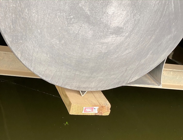

99% of the lifts on my lake just have a single 2' x 8" laid flat across the lift crossmembers, positioned under the center of each toon. The only situation where this won't work properly is when the center toon is larger than the two outside toons. In those cases, they typically create the V bunkers under the two outside toons, raised high enough so that the center toon doesn't touch the crossmembers.

#22 Post by steve1313 » Fri Aug 07, 2020 12:07 pm
Puto - It's tough to get those kind of "cradles" to line up perfectly. I think that's why everyone on my lake just uses the flat piece of 2 x 8s.

#24 Post by steve1313 » Sun Aug 09, 2020 3:09 am
Here's an example of how my lift is. It's the same basic setup as almost every other toon on our lake.
