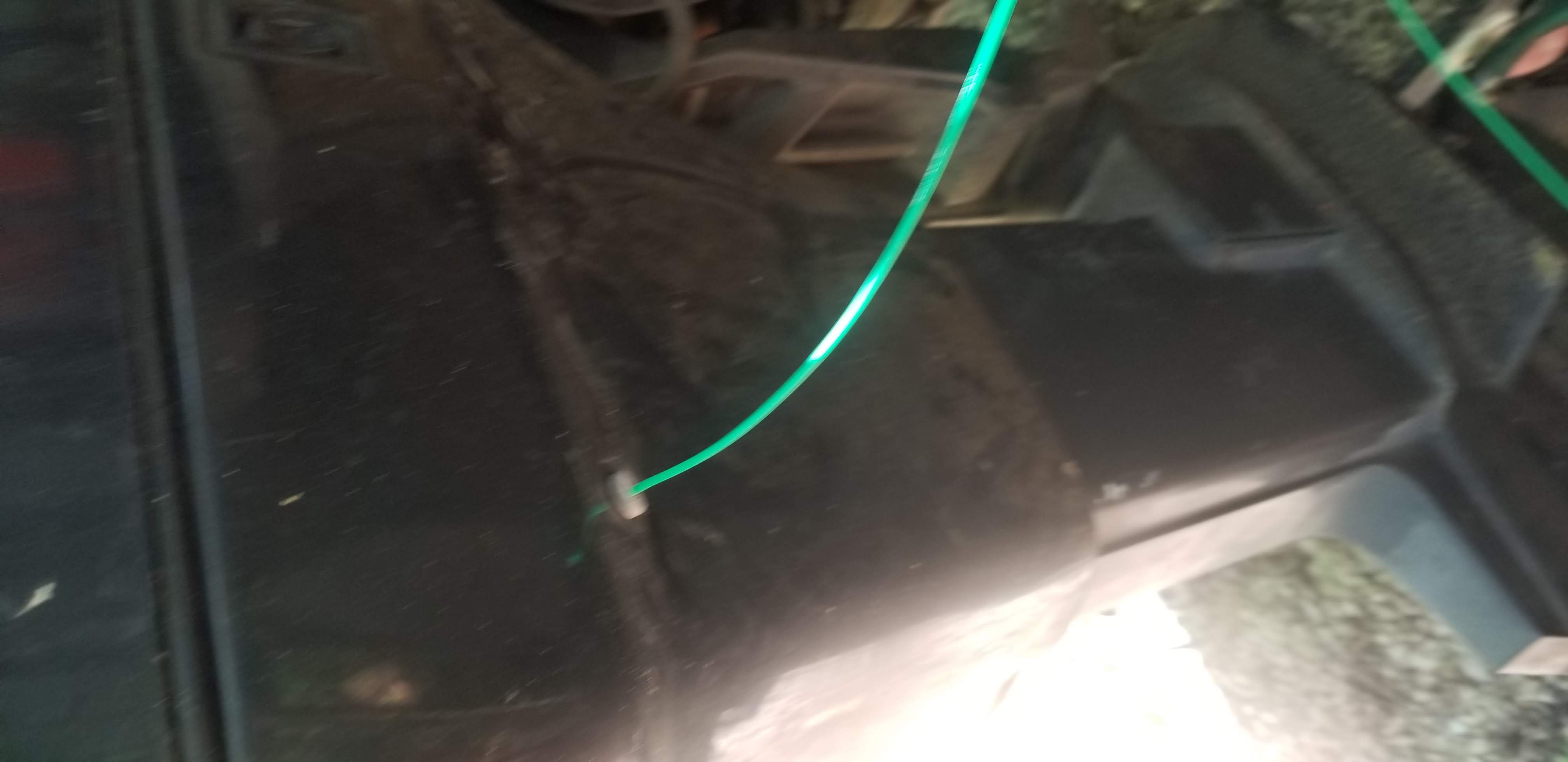

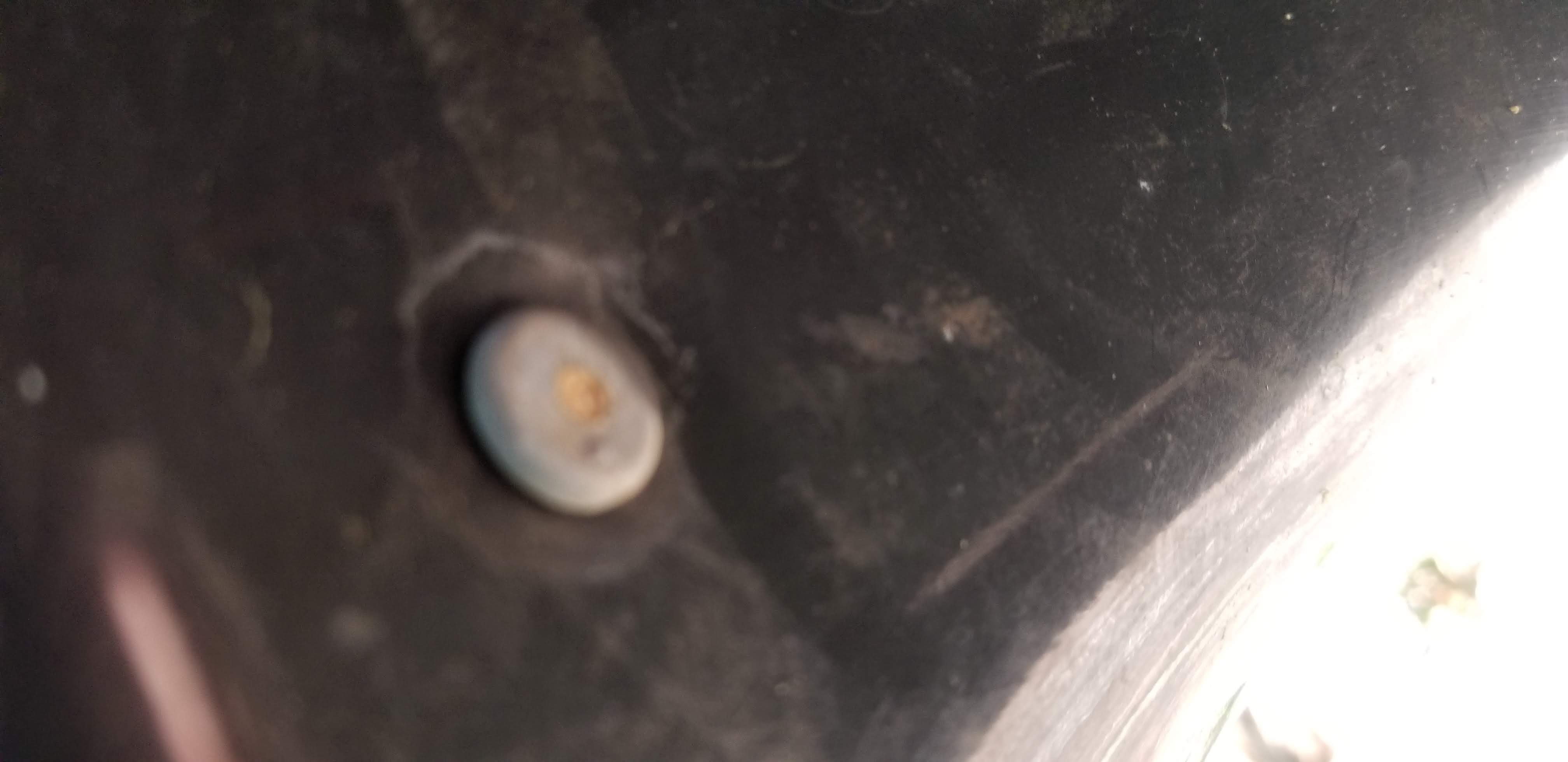

Mud dobbers! I have this in my tool compartment! Weed eater string long enough to run the whole tube.
- 20180525_135612.jpg (171.02 KiB) Viewed 17045 times
- 20180525_135551.jpg (165.21 KiB) Viewed 17045 times
