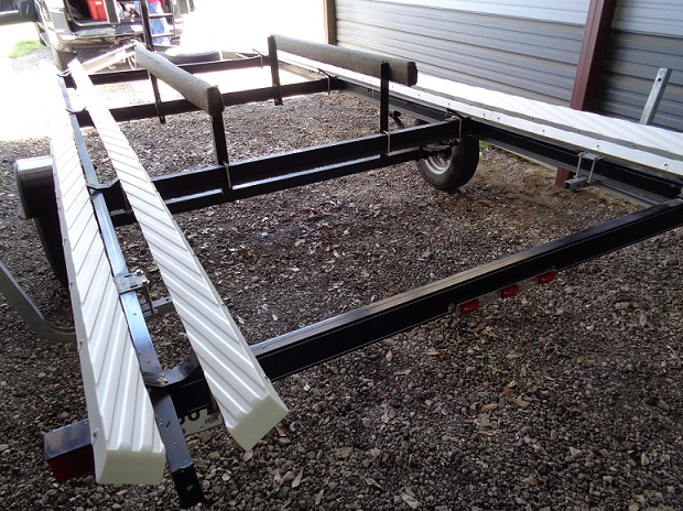

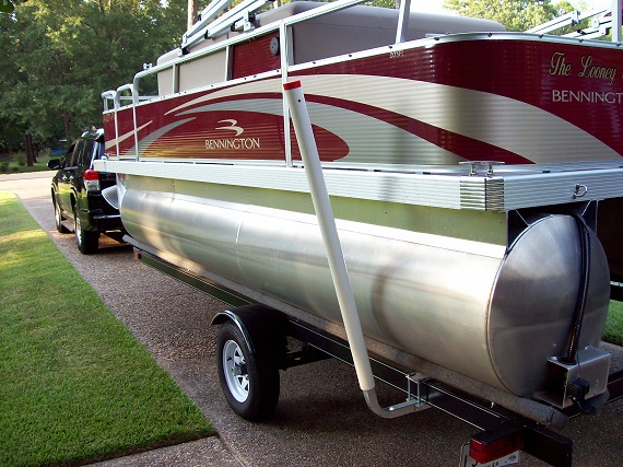

I had to do a couple of things to help myself with loading the boat.. First thing I did was add some pvc trailer guides that mount onto the trailer frame. They're nice because you can just slide the pvc tubes off when you're towing. Then a few years later when the wooden bunks finally broke from being rotted out, I replaced the bunks with new treated lumber and then instead of carpet I tried these polymer bunks.. Both of these things helped me with launching and especially loading the boat back on the trailer.
- New polymere plastic bunk glides installed and ready to go 6-10-2017 (3).JPG (187.89 KiB) Viewed 33283 times
- 100_0955.JPG (218.3 KiB) Viewed 33283 times
