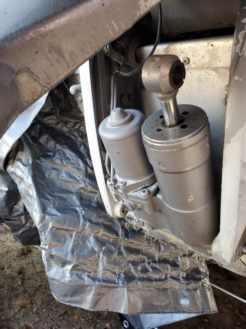

I can't seem to find guidance on how to remove the tilt & trim unit from my 'toon.
It's on a 2000 Johnson 40hp and it's a single-actuator type.
I need to rebuild it as I believe it's leaking internally. It just doesn't lift the outboard like it should. Oil level is good.
I've got it to the point where I think I can get the shaft the unit mounts to off if I remove the bracket bolts that are in the way, and drive the shaft out with a drift or a long bolt. It's pretty stuck from age.

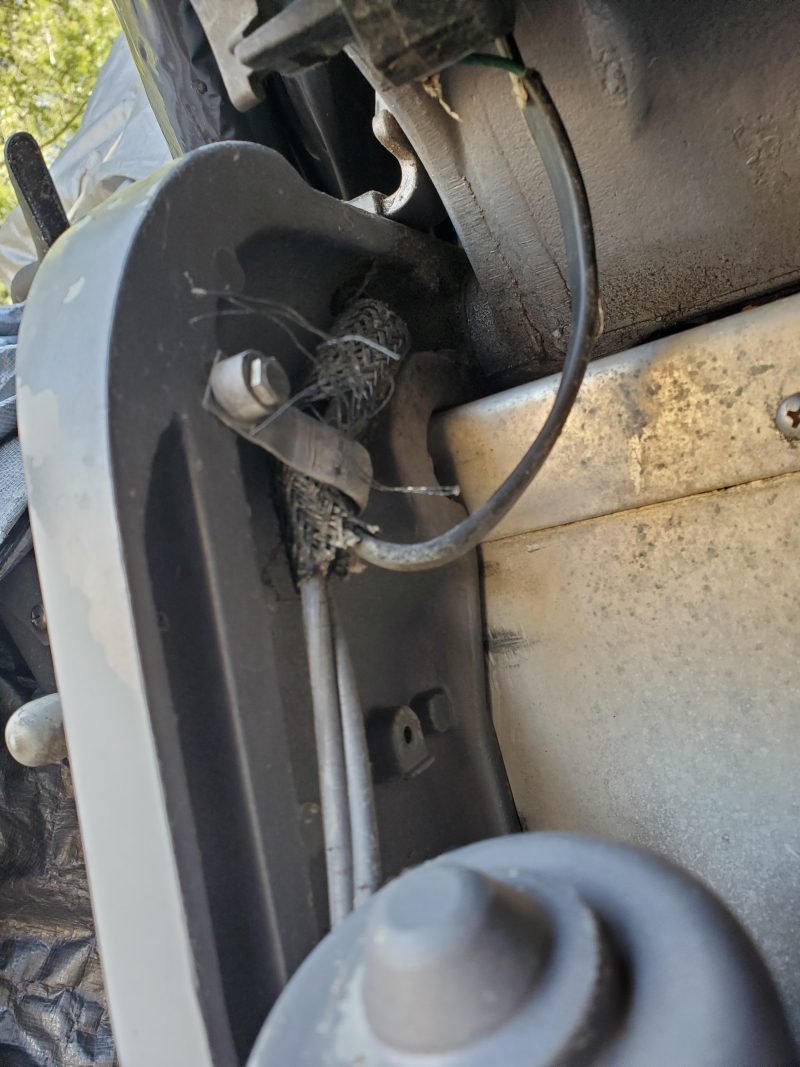

Then what? I don't see where the wires disconnect?

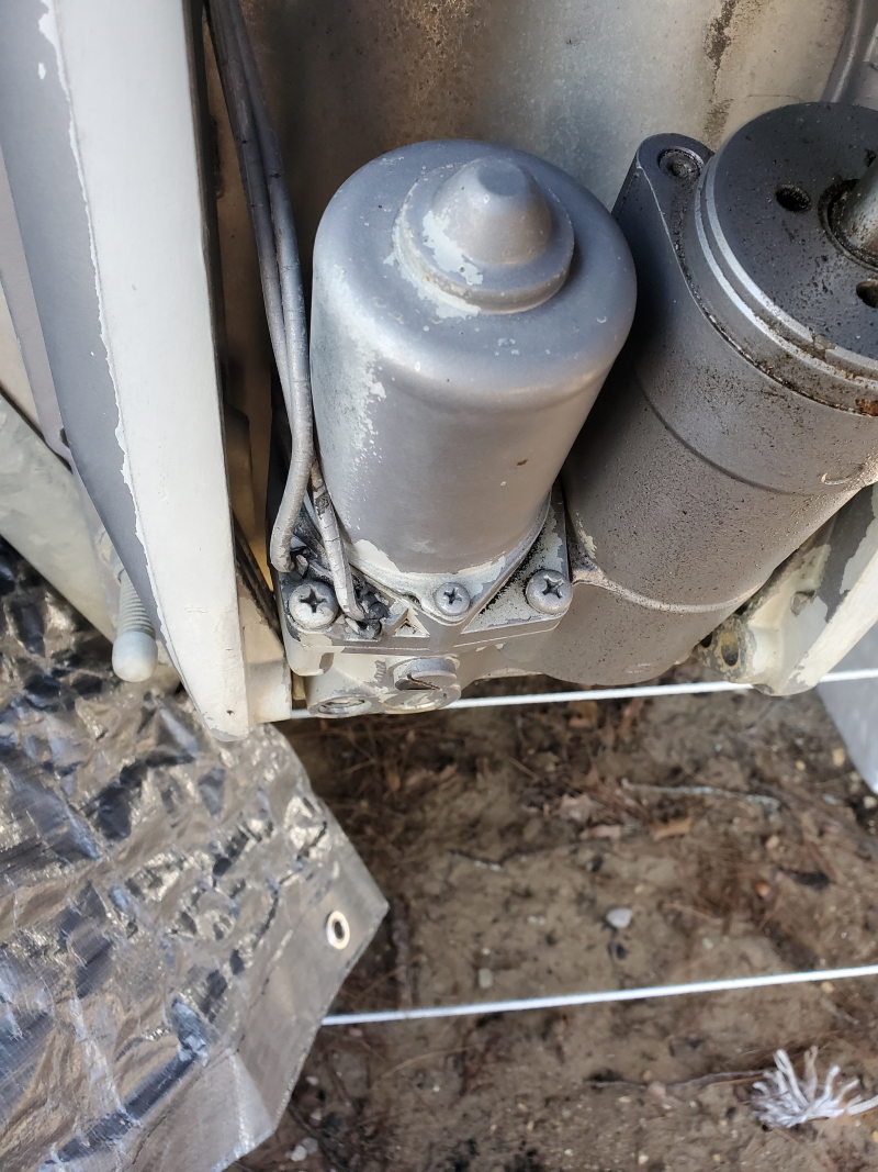

I first thought the wires came off at the screws on the unit but that doesn't look to be the case.

The wires should terminate under the cowl somewhere. You should be able to find them by following the wires on the back of the trim button on your outboard. Personally since it's kinda old anyway I'd just mark them, cut them, and splice them back with some waterproof crimp connectors and a heat gun.
https://www.autozone.com/miscellaneous- ... 325959_0_0
Don't use a bolt on the shaft if it's stuck. Get a brass drift or else you might put yourself in a tight spot.

I finally got up to my cottage last weekend and removed the unit. I'm kind of pissed that I ended up having to cut wires to do it because the connector inside the cowling is too big to fit through the hole in the outboard mounting bracket that the harness runs through. Totally stupid and unnecessary.
